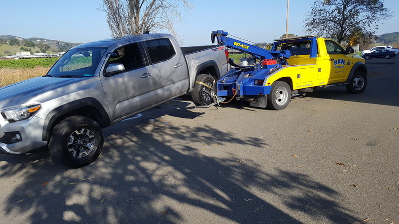

    So I got stuck yesterday in a parking lot. Had to be towed to a Toyota dealer. For some reason the left rear drum brake is seizing up when I am at a stop. It happened to me once before on my ski trip up the mountain last weekend. The brake came unstuck after some rocking and driving in 4lo. It was easy to drag a tire over the snow and ice. I just assumed my parking brake was frozen. The second time happened right after a car wash to get all the snow grime off. I stopped in a parking lot to eat a taco bell burrito and it wouldn't move 5 min later. Possibly moisture related? It looks as if the shoe is seizing to the drum. The Toyota dealer unfroze the drum. I am currently arguing with them trying to get the drum or at least the shoes replaced in the rear. Its clear its not a parking break issue, but a shoe/ drum issue. The service manager also repeated several times that this is not a warrant-able issue... I say BS. This is not a maintenance issue or a wear item that needs replacing. This is a DEFECT.
    I will keep you updated.
