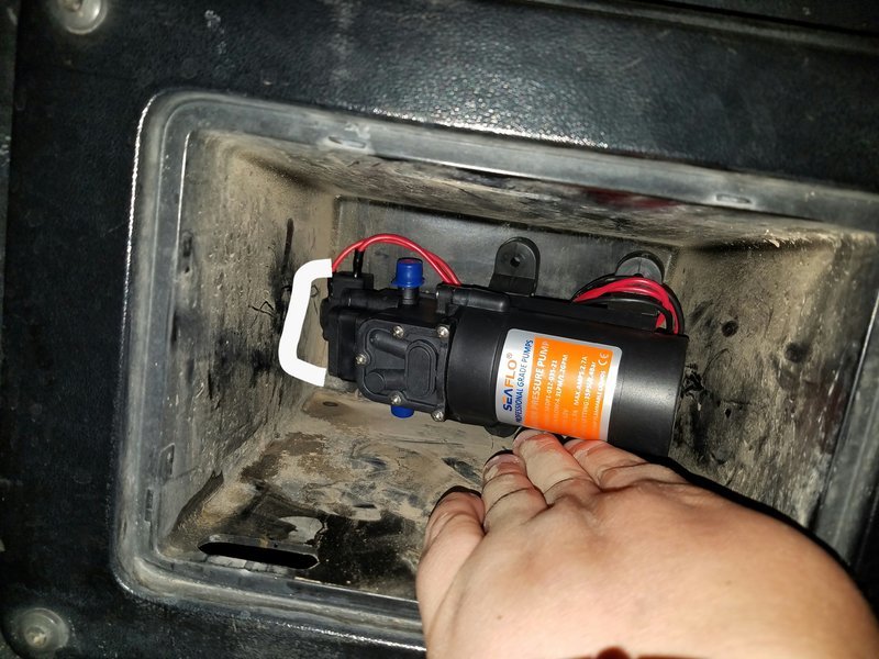

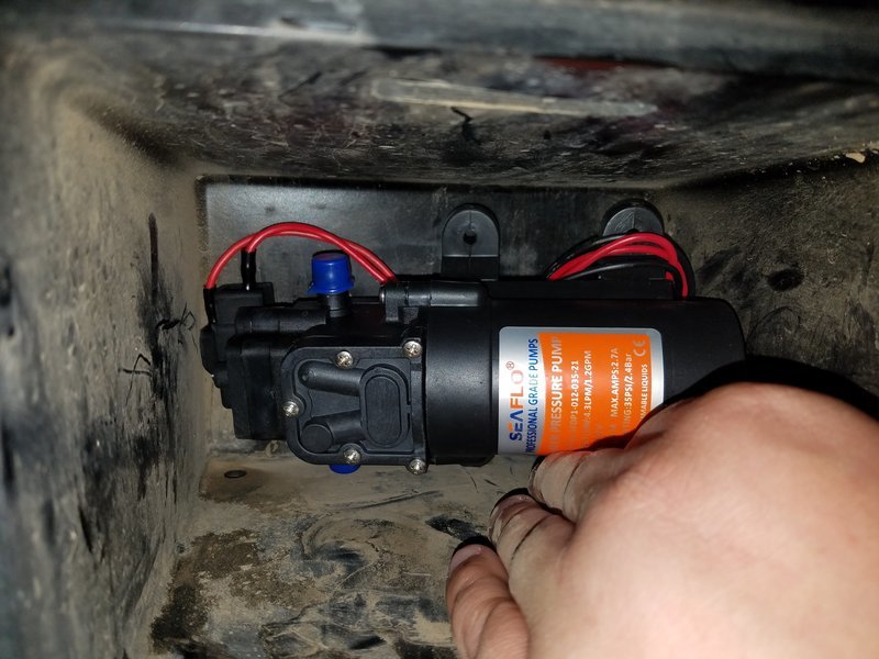

    Did we get these pics?

    Here is the requested picture. Its really hard to tell, but since the pocket gradually gets narrower as you go further in, you would either need to space the pump off the back wall 1-2 inches, or cut a slot on the motor side (highlighted in white) for the motor to poke through the side wall a little bit. But its certainly doable with minor modification to the pocket
