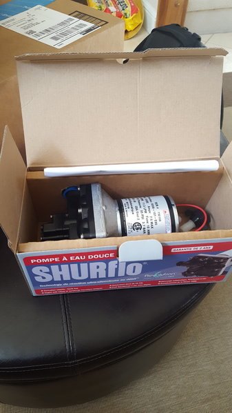

    Adding this to the giant box of parts for my onboard water. This thing is big, I'll tell you what.

  10. Oct 17, 2016 at 11:35 PM

    Damn that looks like a beefy pump... Which model is that?

    @VolcomTacoma that pump runs 1/2" outputs huh? Be sure to run matching intake line. A pump of that size with not be happy if starved for water. You can slightly downsize buy having tested a pump with 1/2" line myself i can tell you they need the supply. Also, consider that as well when picking out a strainer and using quick connects. Those parts use 1/4" fittings so even if your input is the full 1/2" itll be a choke point whenever water passes through a connection. This will make your pump louder, less efficient, lower output then it's rated for, and reduce pump life. You'll wanna keep that entire setup to 1/2" garden hose type connections including the hose itself

    Yessir, not to worry! I'm a mechanic/operator by trade haha. Everything is 1/2" with 1/2" fittings. No choke points haha. Like I said before, you created a monster, now Im looking in to chopping my exisiting crossmember so I can fit a 10 or 20 gallon tank between the frame rails lol. Obviously I'd only keep it filled when Im overlanding, since I dont want all the extra weight when blasting around Pismo

    Uh, I'd have to look to be honest. That was after a couple hours of looking through pumps and checking reviews nonstop.
