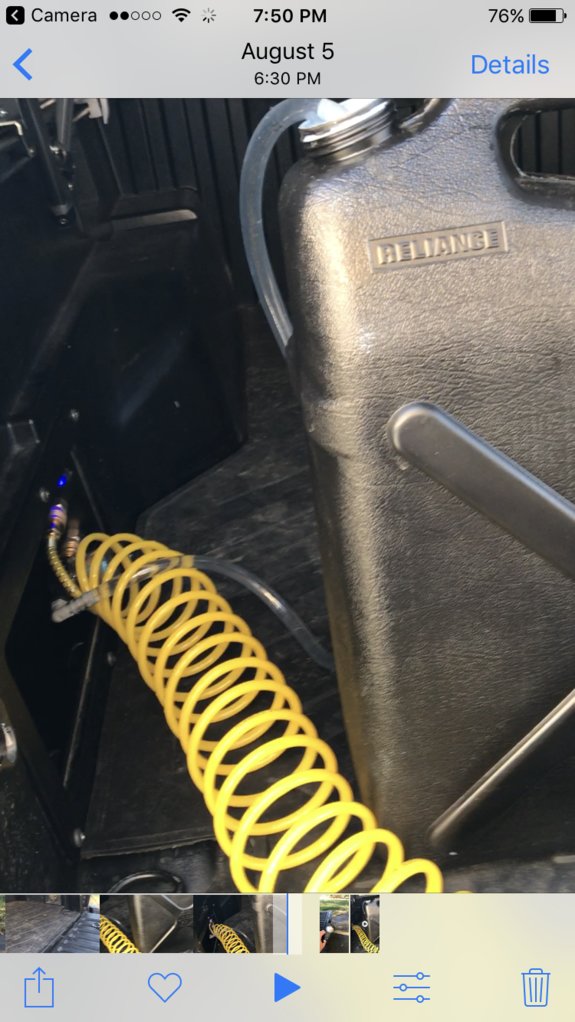

    I'll take some pictures of the cubby tomorrow. I was going to paint the same container I got from Walmart to make it heat up. I need to figure how to make the hose weighted so it doesn't curl up out of the water

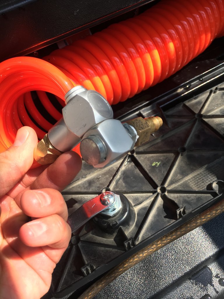

    Here are the pictures. I really like having the upgraded longer hose and the added swivel. I'm able to go all the way to the front of the truck . One thing I've found if the truck is at an angle and the water source Is farther away the pump had a hard time trying to suck the water up if the water was below the pump if that makes sense.

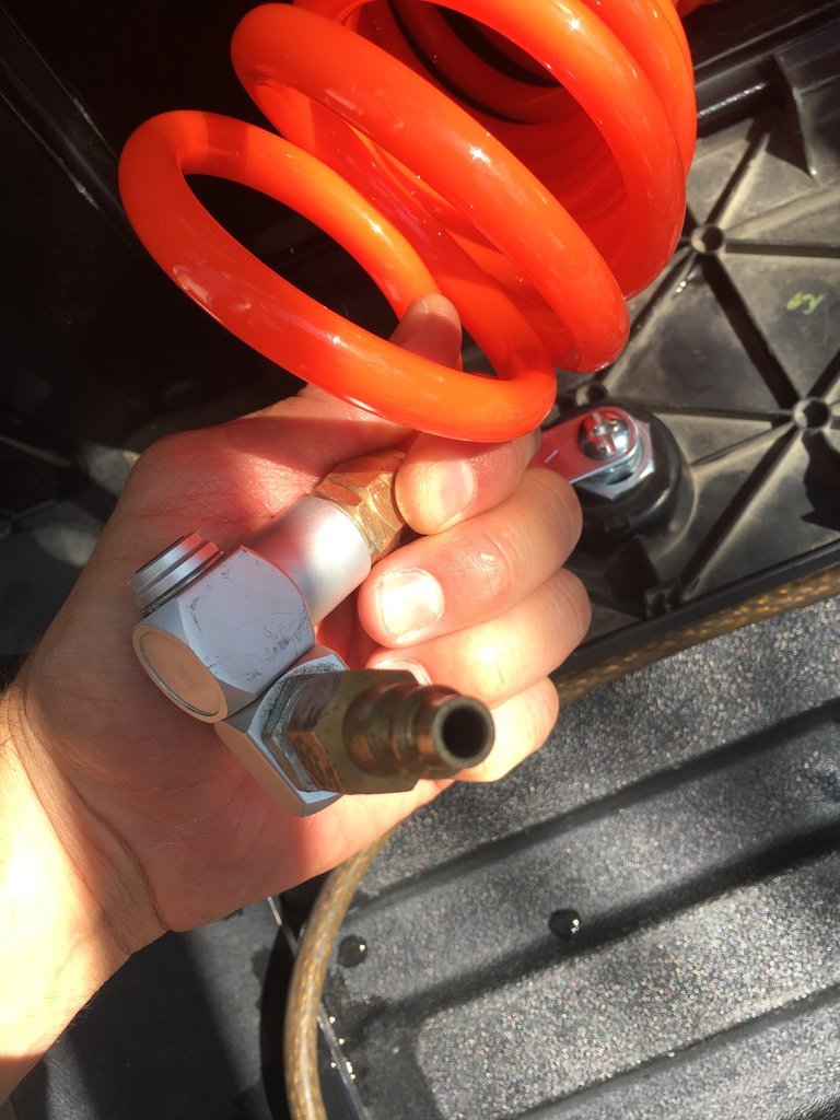

    Can you share more about this swivel?

    Here it is Anthony said you can get the mm from Home Depot or lowes and it was an extra 8 bucks I think. It allows the hose to swivel in different directions a little easier.

    No problem. Yeah it looks like the right part .

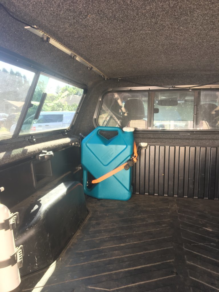

    I just strapped a 7gal to the front of the bed and my intake hose runs along C-clamps to keep it up out of the way.

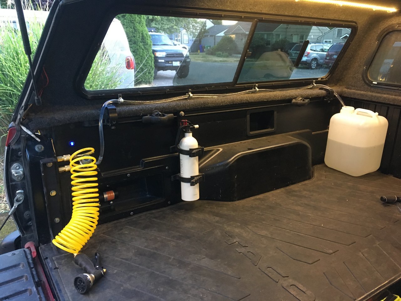

    Here's a better pic of how I ran the tubing. Clamps are painted black now. This is with the test jug.
    For the current blue 7gal jug I drilled a hole for the intake hose where the little air release was, and flipped the spigot upside down on the screw off lid so it's inside the jug. I have it cracked open about an 1/8". My theory behind this is my intake hose is basically air tight and as the water gets sucked out it would either collapse the jug from negative pressure or stall the pump. If that all makes sense...

    Nice! I like the clamp setup, no need to hook up the intake hose every time. :thumbsup:

    Yeah it's much easier! I do need to flip my hoses so the intake is on the top. It kind of interferes with plugging in the sprayer hose.
