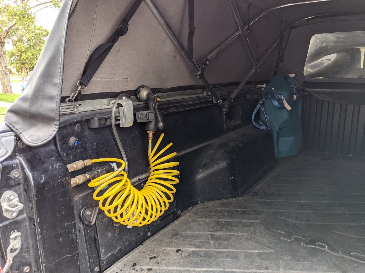

    Set up a semi-permanent always-ready system in the bed. Basically strapped a water container at the front of the bed, ran a few extra feet of line and have it hidden behind the softopper frame poles. I can also hide the line under the bed rails. Easy to refill the water tank by un-buttoning a few buttons on the softopper right next to it. Have the soaker attached with a quick fist to the bed rail. Super stoked in this setup. Gonna do a lot of beach days this year wanna have it ready. Btw. That's a 7-gallon Reliance water container. Fits nice and out of the way
    Anthony was awesome helping me troubleshoot a few things. Loving this setup two-three years later

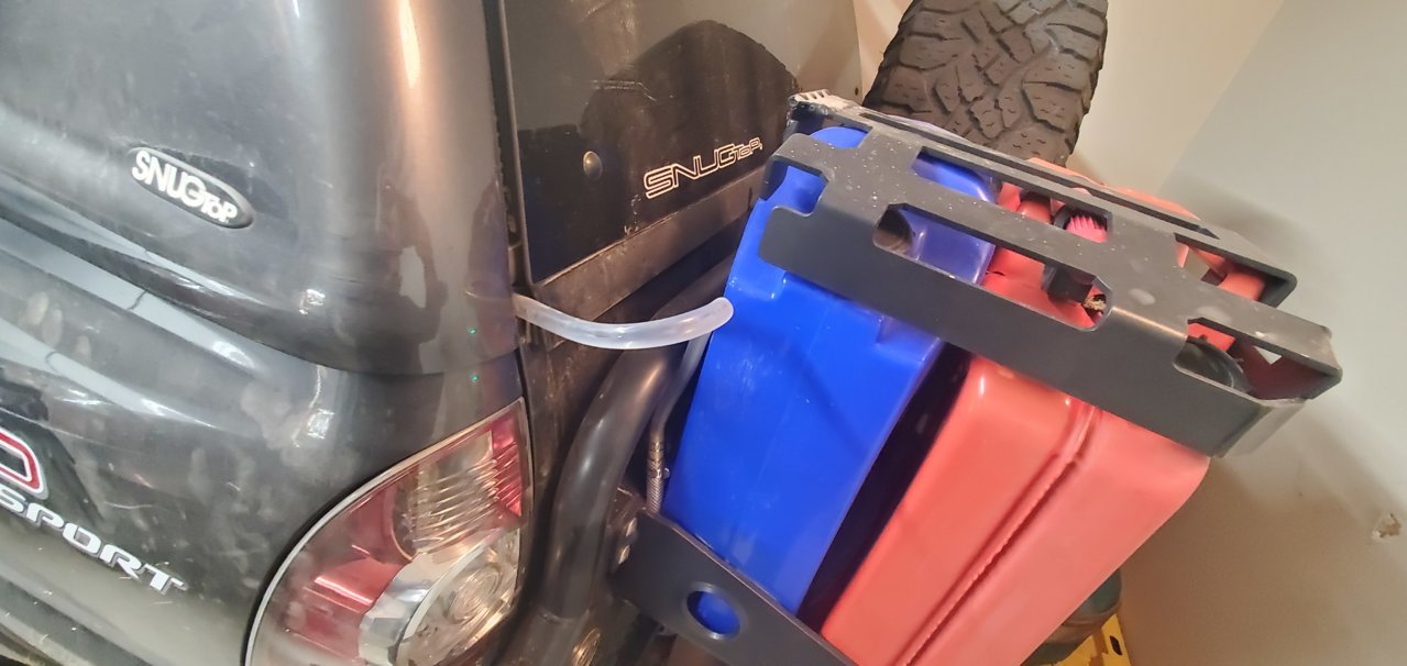

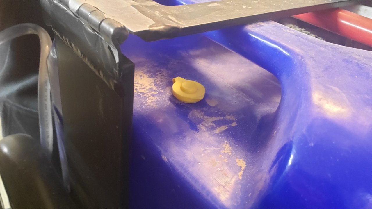

    I actually hard connected mine directly to my water source with an on/off valve. I don't have to actually drop the line in anymore. But the water source then must have a pressure release valve otherwise itll stop sucking after a short time.
