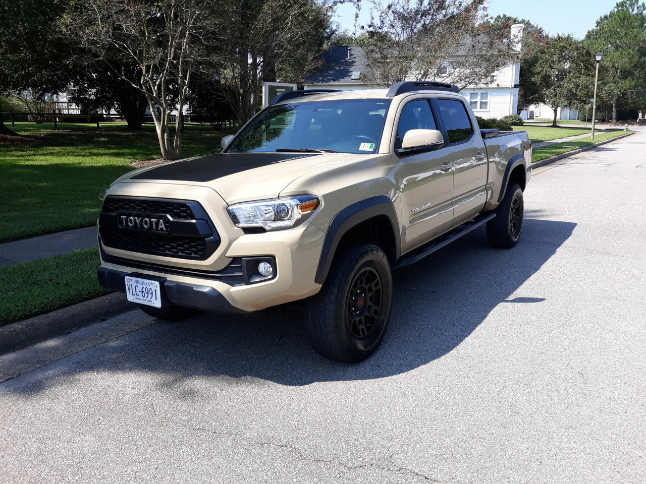

    Do you get any rake with this setup? I am going with this but worried the front might end up not leveled to rear

    F:OME Nitrocharger Sport 90021 w/888 Coils R:OME Nitrocharger Sport 60091 w/CSO47R Dakar Spring Pack
    I went 888. Still have small rake. But looks great

    885 springs
    3 leaf AAL
    5100s front set to zero and back
    Overload leaf left in
    Just under 2 inches front and back
