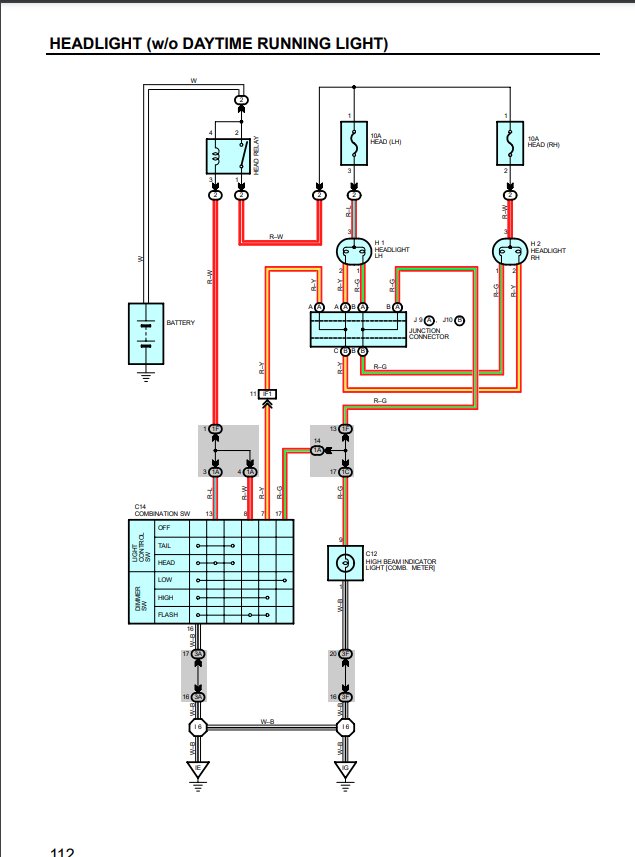

    The lights are controlled by the grounds. They have power to 1 wire all the time. The headlight switch controls the ground to the lights to turn them one and requires a bulb that is designed for that.
