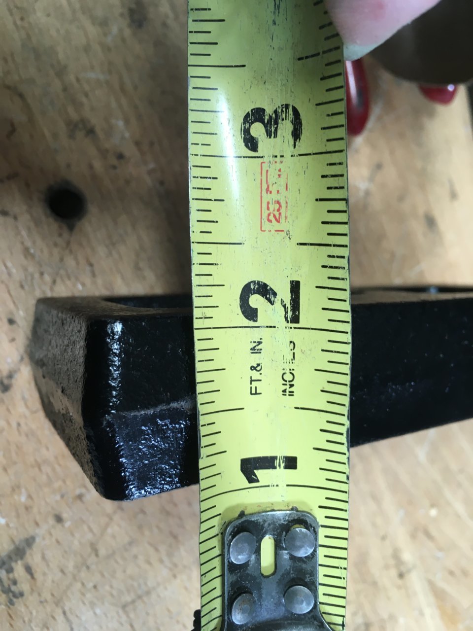

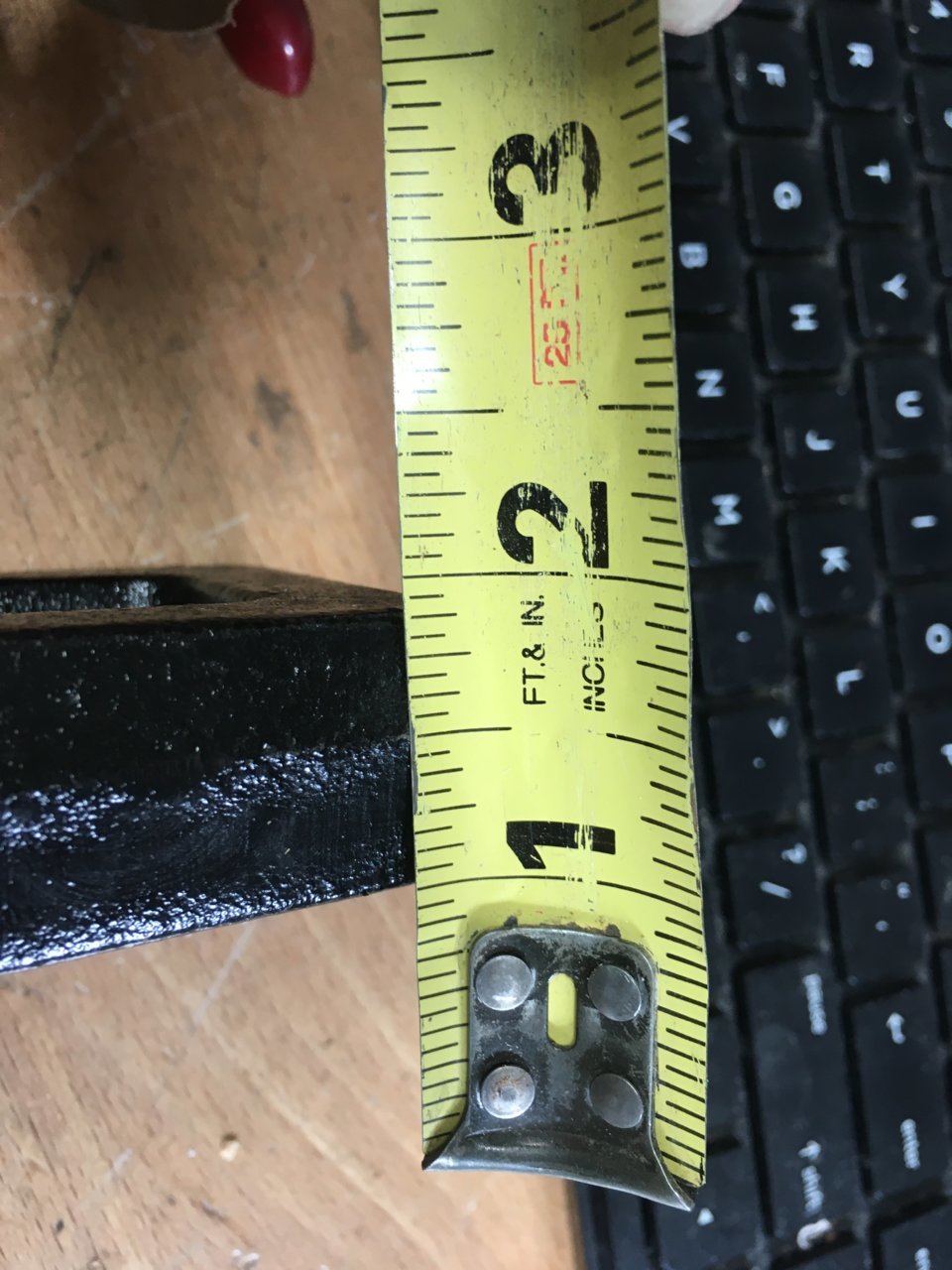

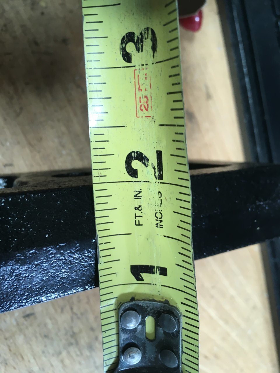

    I bought what was advertised as Heavy Metal tapered 1" lift blocks on Amazon about 2 years ago. Measuring them showed about .80" at the front taper and 1.20" (corrected) at the rear of the taper, the center measured 1" exactly. I took them off over a year ago and tried AAL and took them off also. I recently tried to sell the blocks. I was advised by a potential buyer that Heavy Metal did not sell 1" tapered blocks but did sell 1.5" and 2" tapered blocks. These look exactly like the 1.5" tapered blocks from Heavy Metal. A web site visit confirmed it. I guess if you buy automotive parts on Amazon they may be counterfeit.

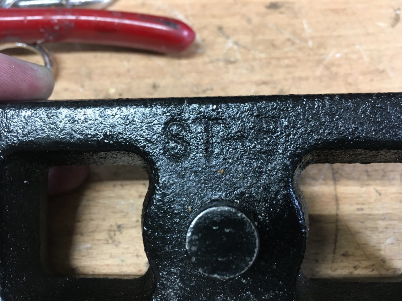

    I'm guessing that I got something other than Heavy Metal blocks.
    Is tapered better than non-tapered for just a 1-1.5" lift?
    unknown marking ST-5
    center
    small end
    large end

    Thats a lot of taper for such a small block. The taper is to help correct driveline angles. Usual rule of thumb is 1* for each inch of lift.
