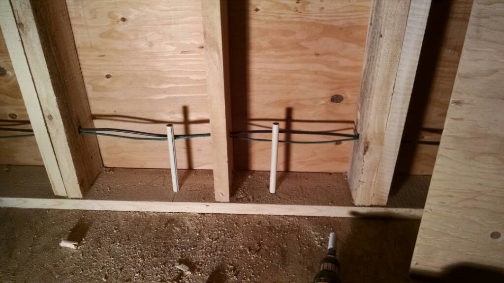

    Kitchen sink lines:

    Some A's:
    *I only had to truck most of the wood about a mile and a half. Not too far below my cabin is a creek bottom where the cottonwoods grow.
    *Price of the logs was free as they were on my land. As far as the fuel for transportation - no I didn't factor that in.
    * Cottonwood seems to be a little tough to work with as far as drilling holes through it to run pipes and wires.
    Thanks for the compliments!
