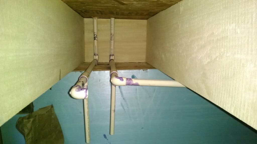

    Bath lavatory lines:
    Bought big cans of primer and CPVC cement - brushes are too dang big to fit inside 1/2" and 3/4" pipes. Makes it kinda messy. :mad:

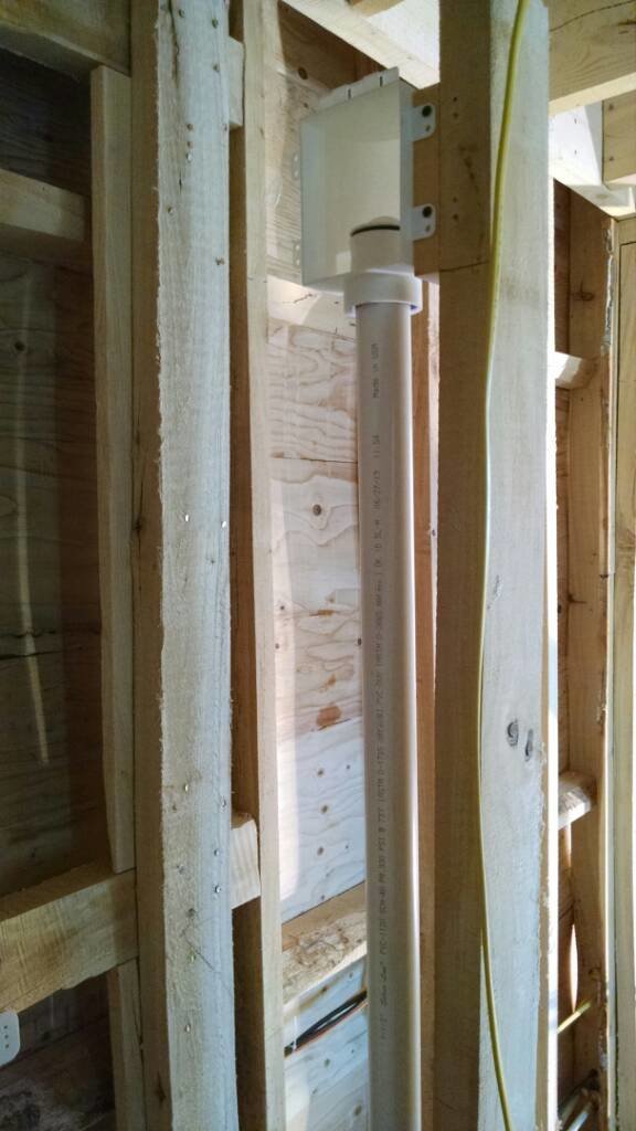

  3. May 8, 2015 at 9:35 PM
    #203
    TwistedTLM4
    TwistedTLM4 [OP] Unknown Member
    Jul 6, 2011
    #59396
    3,131
    Philadelphia, PA
    '05 DCSB TRD Sport
    WeatherTech Floor Mats, WeatherTech Bug Shield and Vent Visors, Audio Upgrade, RaamAudio RaamMat & Ensolite, Mr. Marv's Custom 10" Sub Enclosure, Pop N Lock Electronic Tailgate Lock, mattgecko's Bedlights, Demello Offroad Single Hoop Bumper, Marathon Seat Covers, Leer Topper, OME885s on 5100s, @Blackout14 HD Leaf Pack

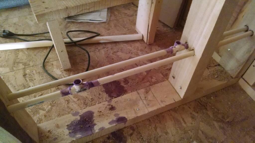

    Shower tees cut in:034d6934bcde0b2a8f92e6046a960c39_964babb5d00d71cad83d20ffa16556b8306294fc.jpg
    Had to cut out a stud that warped pretty bad. The one on the left is the warped one (obviously). Took the sawzall and cut it out and nailed the new one in.91b1c01f22b8a1a3a1b7de0261725016_de743392c5e2adca8c251e8382b7fe928a06b138.jpg

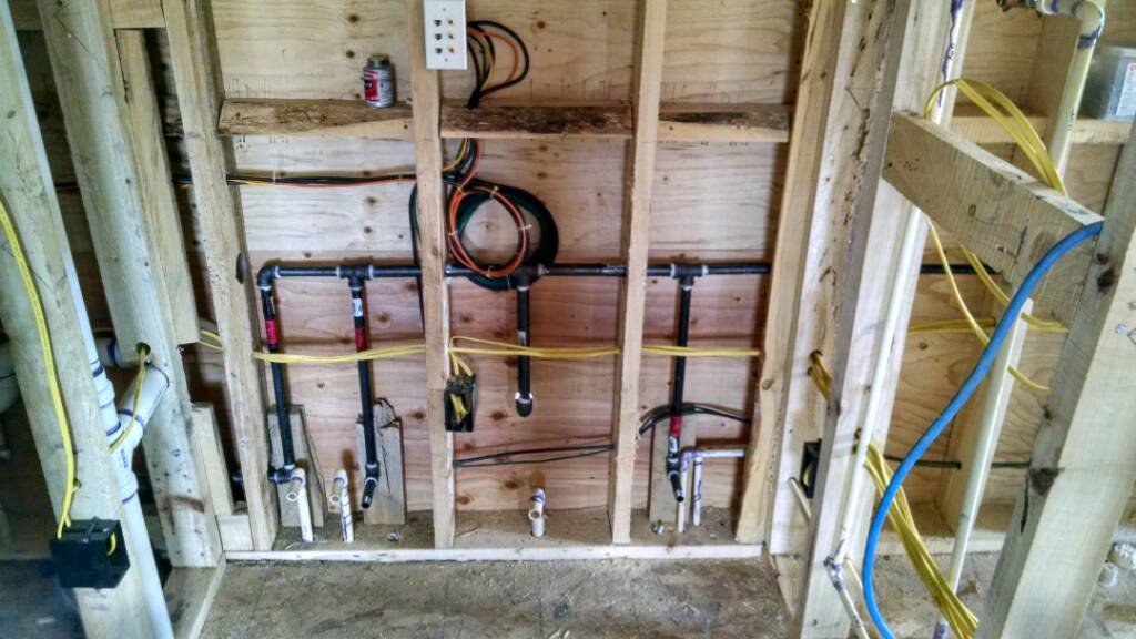

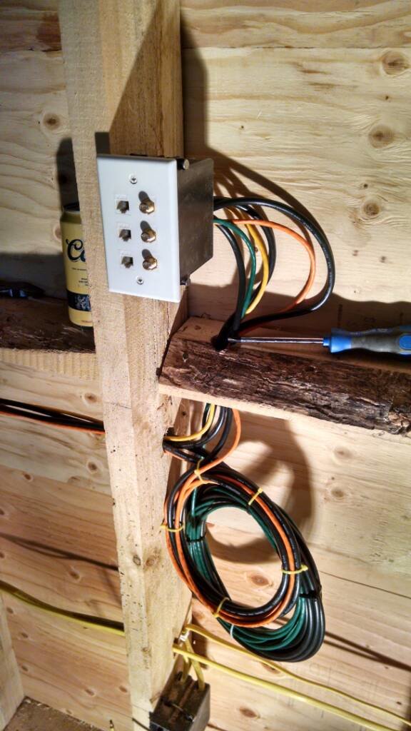

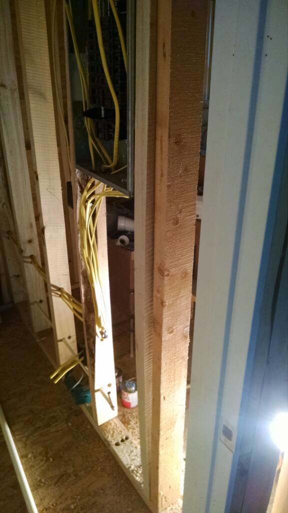

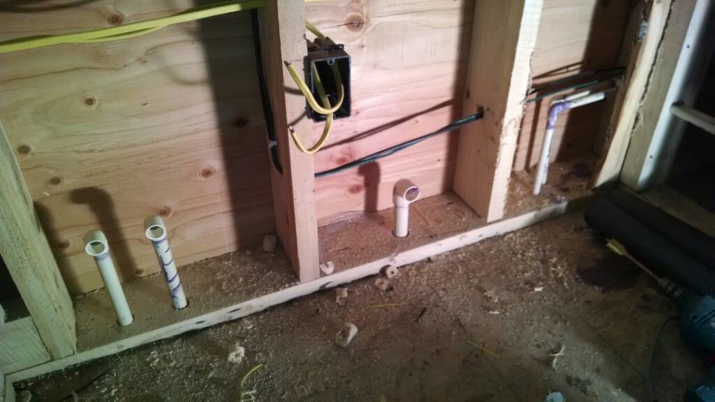

    Landed Cable and Network:
    3/4" Supply lines on left to below floor, 1" incoming water in center and 1/2" shower and lavatory lines coming back up on right:
    3/4" supply lines below floor with 1/2" bottom taps for washer:

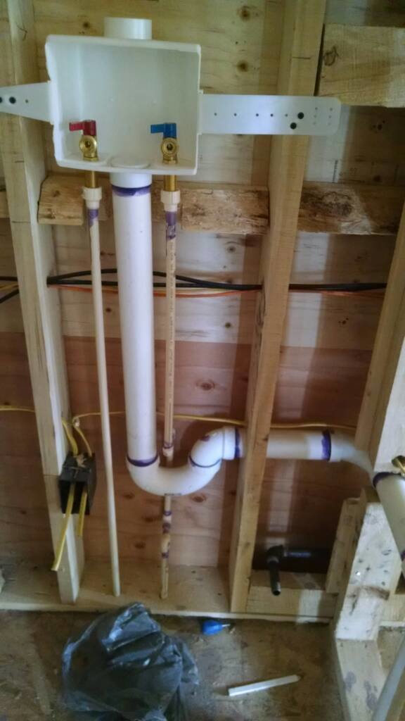

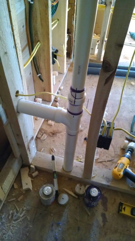

    Washer Standpipe & AAV:7cc3de16f6909ae462b4914c3358d1ed_fbac136284c8271949a49b4bcbbc2224b5f32a6a.jpgbb31f7be4371764fedc4dc496a73e6f2_91e229e6c917d88899ad7ef5504368736c410b56.jpgc0f9194a2b5d91db8dbc621fbb3c15e1_d358ec7b8ed0e4a2c368ac5fdf079b63cb7ab143.jpg

    Why such a service loop on those?
  9. Jun 28, 2015 at 1:52 PM
    #209
    TwistedTLM4
    Jul 6, 2011
    #59396
    3,131
    Philadelphia, PA
    '05 DCSB TRD Sport
    Bought pre-cut lengths of cable and over estimated the distances.

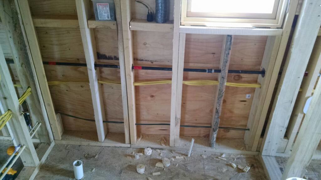

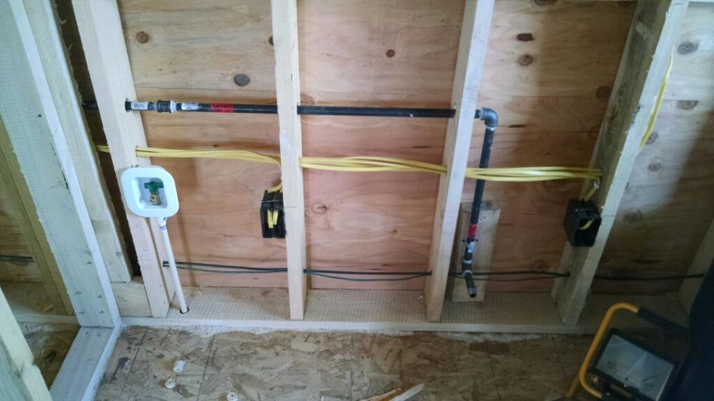

    LP Gas Piping 99% complete:
    28189a31ba31a69f091ee621a8bbaa9e_ba0d1cb3ced60b028ea7404c5cbf9860cb572136.jpg6a994e9ec5daf04b98852071718651e8_4a79d4928d998b21658094b3751a7cbffc307f21.jpg56165cfaed0d312d941589aaf80c4023_2ed3cdeb774c585e655e87225ebb9cbac2351e17.jpg5ed8be50e606dddb98c833ff3c410bbe_9f8f8fa586c24bbe15d48f83f12a98b7da0982f3.jpg
    Only need a 5" long 3/4" nipple to go through exterior wall to finish it up.

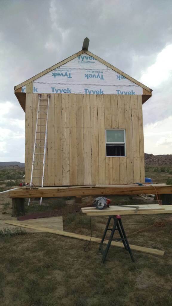

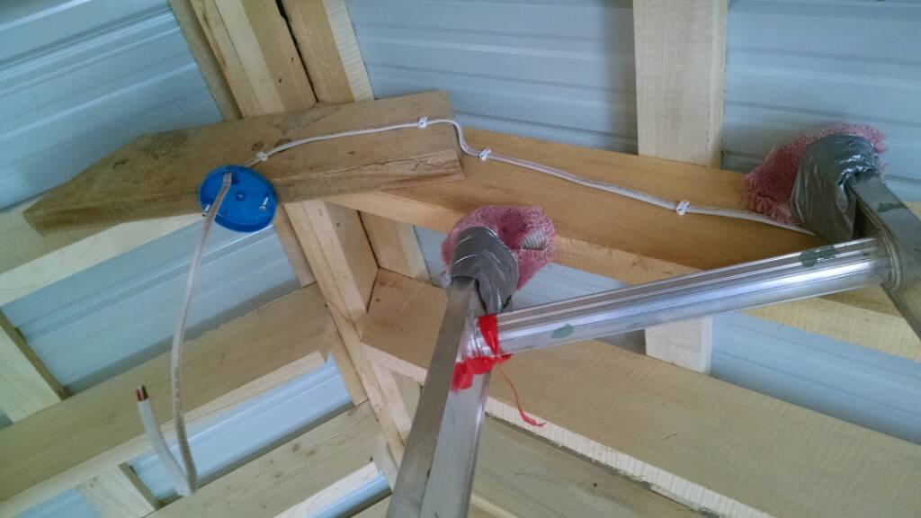

    Living Room Fan Box Mounted:
    Extension ladder is a bit short - I'll be fine as long as OSHA doesn't stop by...

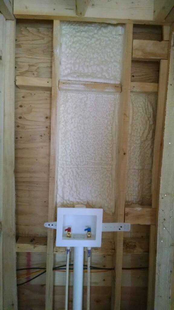

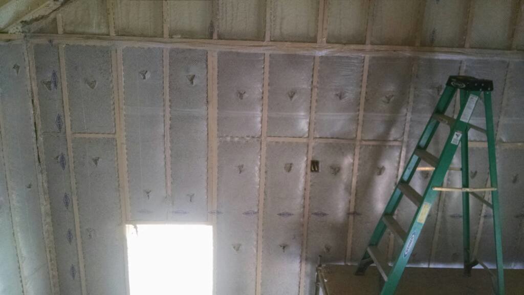

    Foam insulation day!!

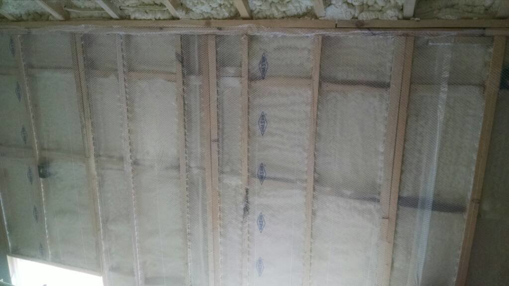

    Finishing off gables while foam guys work inside:a75d9a2491c846a817104639e7d5bb13_62a695b1d18a927da78fa21b49cf634a0f8b7b21.jpg0b2235edc59c1295df398513048e1980_42f97742455aca420bb56842aaf14649ffeef11a.jpg01f4c23fd71f6d45a5542878128ad232_66df59edc22967184c866028b96a7f73c9dd905d.jpg

    2Lb foam ?
  19. Jul 7, 2015 at 5:52 PM
    #219
    TwistedTLM4
    Jul 6, 2011
    #59396
    3,131
    Philadelphia, PA
    '05 DCSB TRD Sport
    Not sure.. 1" thick in walls and 4" thick in ceiling. Tomorrow the next crew comes to do the cellulose blow in to fill remaining cavity.

    Walls prepped for cellulose:93b7a0212cd77750406e9de6469bdb65_6d5afae26a49061ee5a383a72bac7062b28753a0.jpg
    Cellulose blown in:2208d1d739b41a510c8a36c2bf6868c7_2c228583edd5331b5590d678fbf7c79540d261eb.jpg
