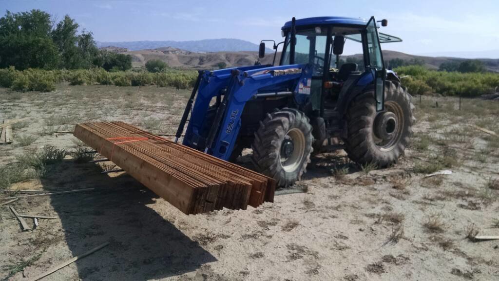

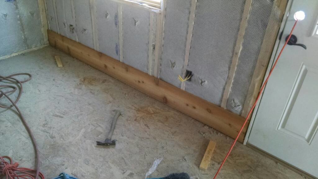

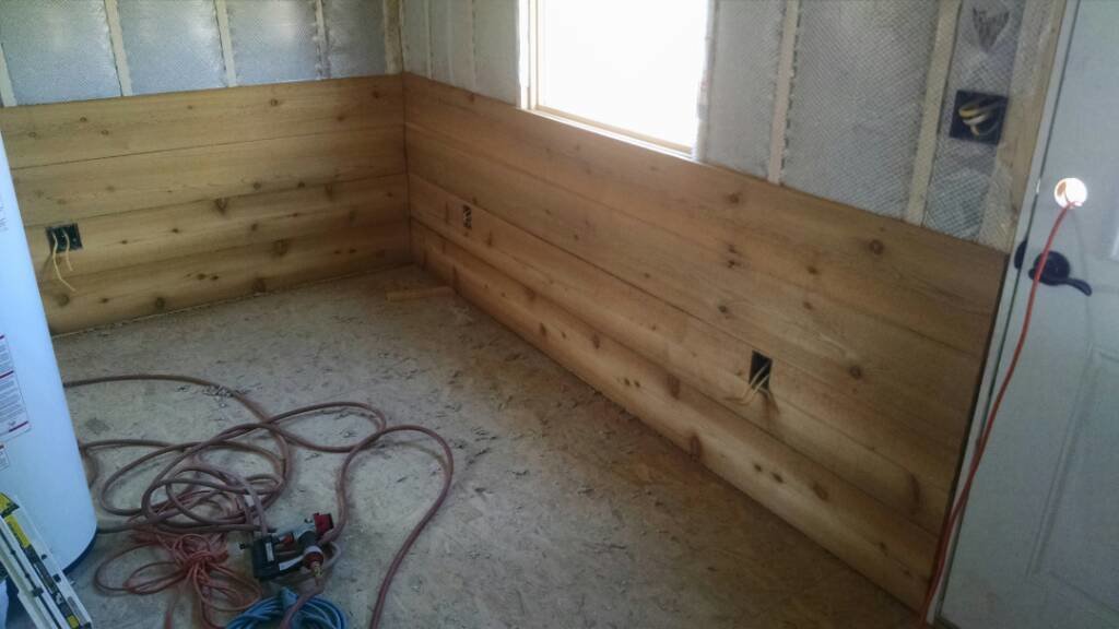

    Cedar Board Transport from Sawmill:d8a063694ed84a00e230951444b3a584_4455c70409bd868b2e964adee7cf80b0300973c5.jpg
    Cedar Board Installation:5ee4a181bacd2c3ada5f47b6f62c806a_ebb19a4df1e13f44f02d640503092b6245f3263b.jpg5e1f1a634ea184c08830a9d623ddad70_a2724a03c4f2f5b8af4c7986c60f0f6e1a3d0b56.jpg4f3095a21d5ec97b54f6af234cb86177_71aba30346f7e4d407d0a3f135e1374b13a0c425.jpg3f35b2b6cb4a4a5b72aa281b0edd73da_19574d5da339192a08741efb82f8c4f3ea943732.jpg

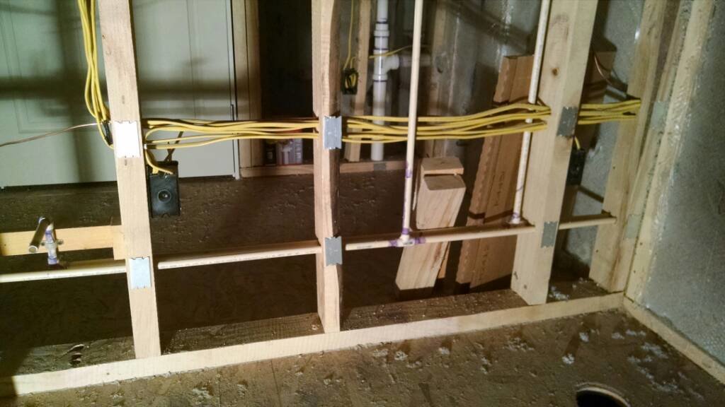

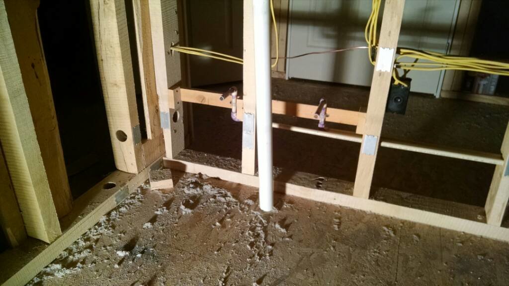

    I didn't see any protection plates where the wire and piping go thru the studs. Are you not concerned about a future nail going thru them or did you add them before installing the finish boards?

    You don't have to use protection plates if the wires or pipes are not close to the stud surface , I can't recall the exact dimension offhand , at least that's how it is here

    I guess it would depend on if it needs to be code compliant and if yes what code is it under. If I remember right is 1" for the UPC, 1.5" for the IRC and IPC. I don't remember the NEC.
    I think 1.25" for the NEC.

    Yeah , 1" seems right
    Going back through the pictures it all seems to be well back from the stud faces

    I have plates installed where the pipes/wires are close to the surface of the studs.dbd3c3971a6144a13127cbf21b8fc8ef_617b87950a514fa63e1f9c8eafbbdcafa3375769.jpgd038a78b54f3754bfd80d8059f179ee8_95da7069cdc2cb29cfc18c24934b9ca80117541b.jpg01e3e3eabbbb6b97a9d8e5108c0667d4_051d6cddb3e2f0016237b32a6c611fd11ff658a8.jpg

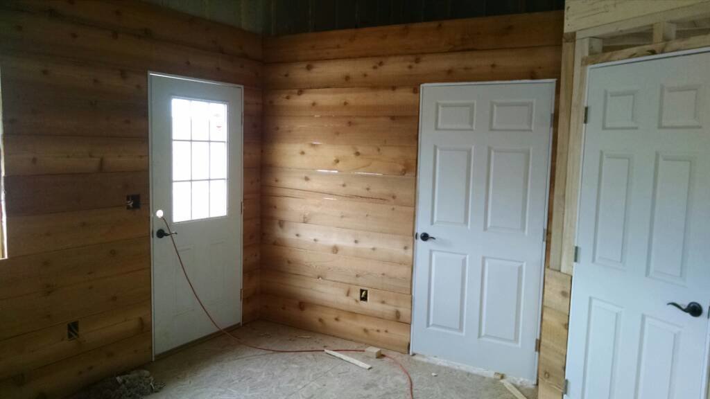

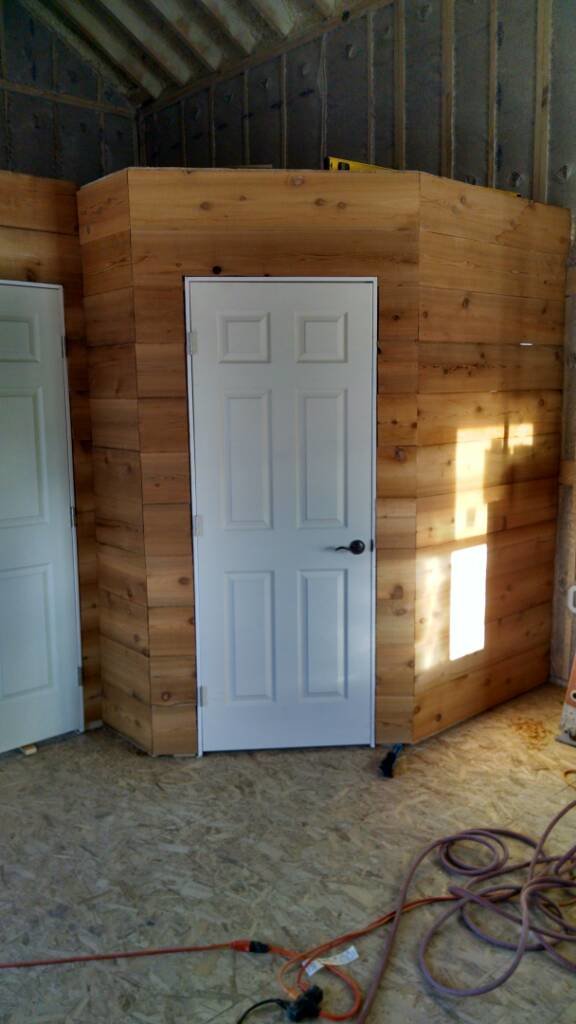

    More cedar installed (Not quite the precision of the work performed by @OZ-T):
    3ba58525607ec2c15ef360cdfe6a891e_65139096d1d2f2b5e892ef2d1e2f56c9a92c7470.jpgdf3ea8cd8ba5f759c817c52e0a781c67_c600941f6e91ec9fb2bd30f9f94cff9f93c64b06.jpge7e74d2567401505769cddbcdb0c15d1_5db1f65dd65d2491ecb111be81db4035049cfc24.jpg

    FYI, The CEC requirement is anything under 32mm or 1.25".
    Not sure about the requirements for the NEC in the states.

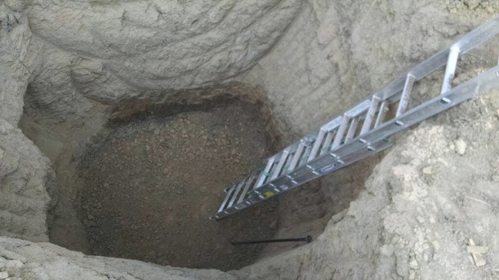

    Finally got the hole for the cistern finished:9c3a66ba8fde6f68f3043c2a1c840dd0_9fdd8bf85f39e2c4a8dfd495c58f1302c62aca02.jpg
    12'-6" deep and approximately 8'-0" in diameter. Got most of it dug with backhoe but had to finish off with shovel and pry bar because I didn't have the reach with the backhoe.

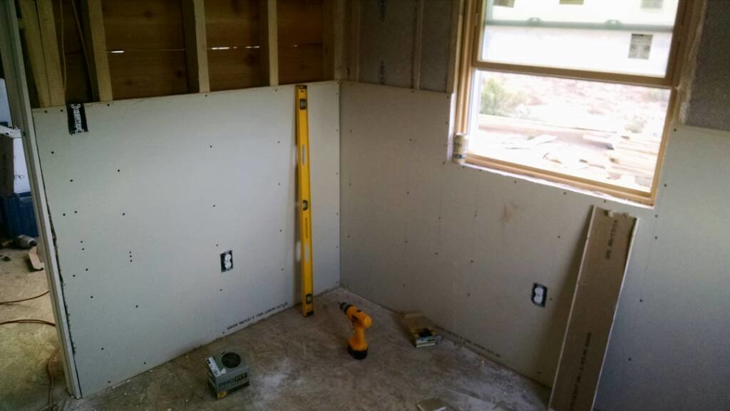

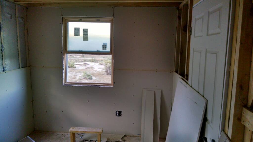

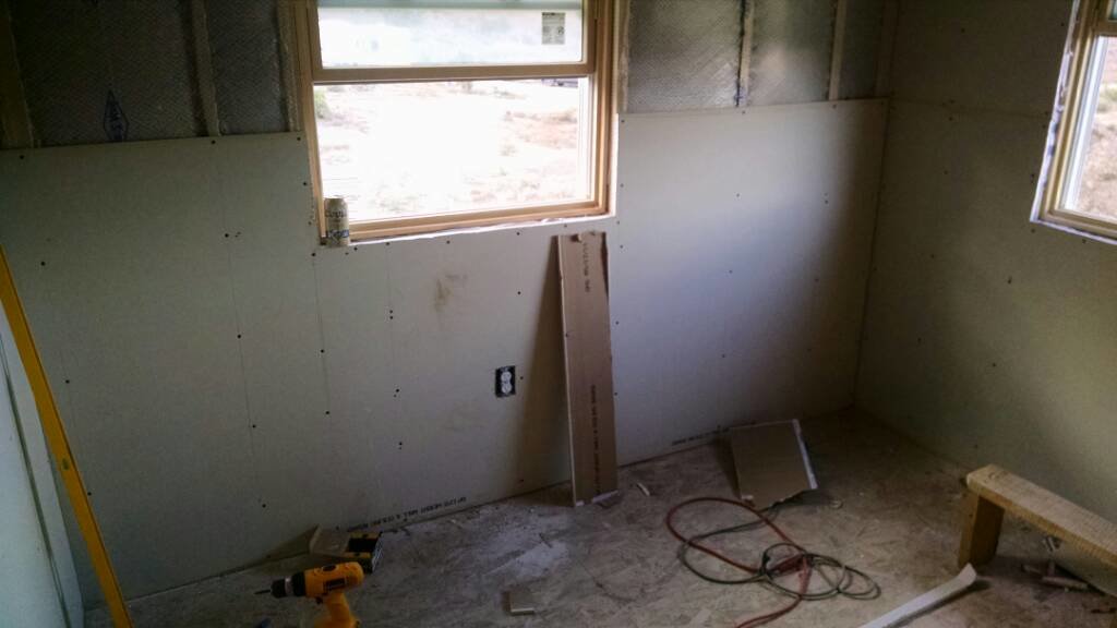

    Got some drywall hung today:d74a996c44c5d32570eb33afbfed4deb_14e8440c1a7876e224121d06ab4dc21904da95c2.jpgeffd59fbd229df565498e7148d7aeb5c_6d7152f79f4c4cc89e34b7d399a5a67704c47d6f.jpgb498c9e7100ef3158c416eaa4d601533_ed4b194c6fa597896cf96ee2a6bce25c734f3927.jpg
