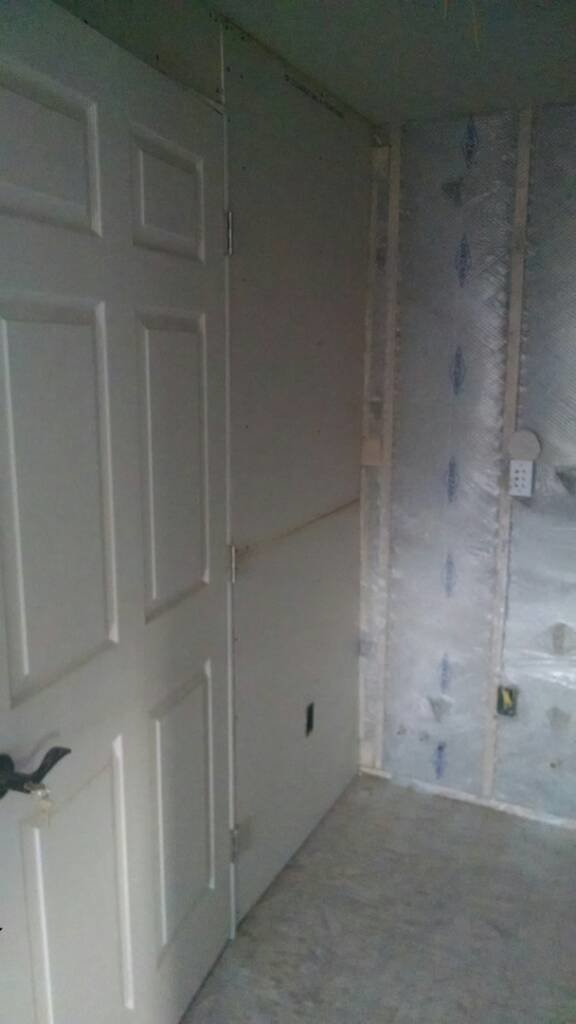

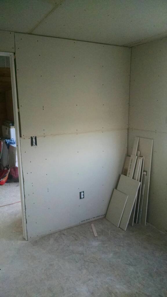

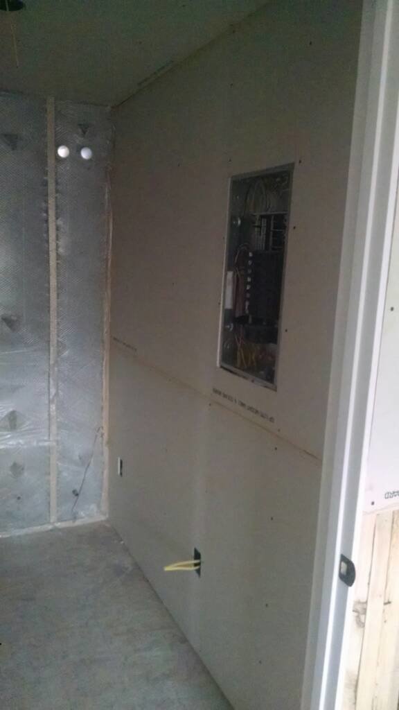

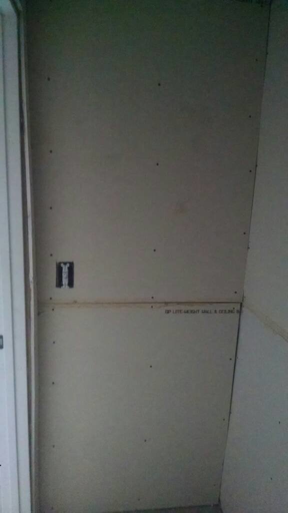

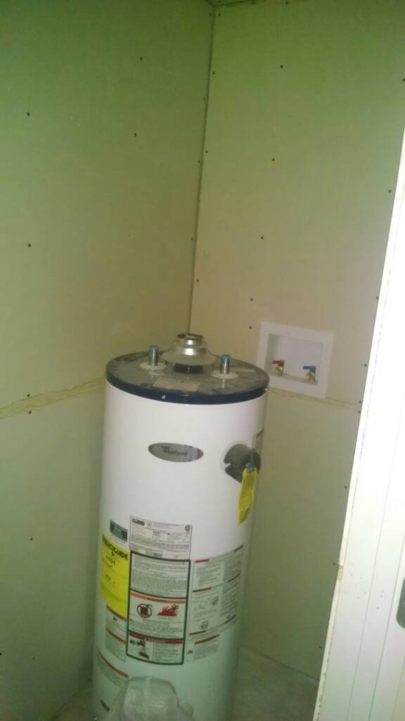

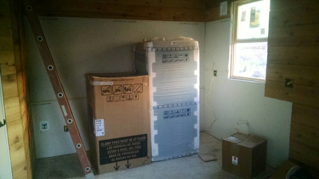

    Drywall hung behind kitchen cabinets: f3e114314adddebd231ffbe2eaaae8b2_672193a6ce81709b6c2285df65bb958697707244.jpg

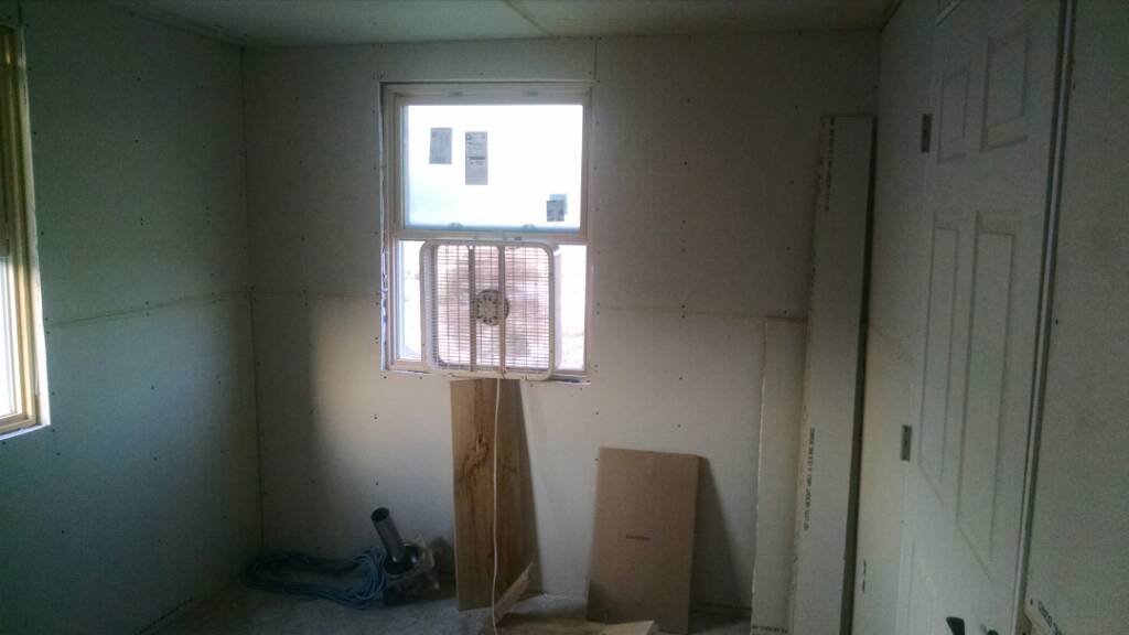

    Bedroom:
    da0be6cc81552dc63d9d5da6320d1341_a813528bd800ee24be76b20a2055c14c9f02f408.jpg382bb69b51ef7e328589df45963814d5_dbd473bd47082c739c7c30682018998e23229079.jpge034269ca950f31a481d7ffe8522b51a_ee09efe6c5adb6bed3d58fe7803166d293dd28ed.jpg

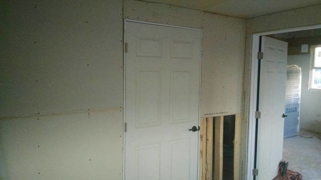

    Utility Room:
    bc403e850393f3e597546e6450aa4266_83f6ffbe308c7dd2c00ca2643a85a5147af971ac.jpg6724e95f364079c77911ebbf6b739b73_5005c9c60de87a3250fb3c76ffa35a21f939ce8c.jpg
    Laundry Room:a005e24223ff81312c3440765d260466_82d9abe6243a3e917cf5dff7b43178bcf223b7cd.jpg4a61c2fbedb1be2588f5adc8517ccfc1_35e50a0e50914b3dbe058527802d28a9a720e4ba.jpg
    For the record, all the drywall was hung ceiling first, top sheet, then bottom sheet. Thanks for the advice, it had definitely made it easier.

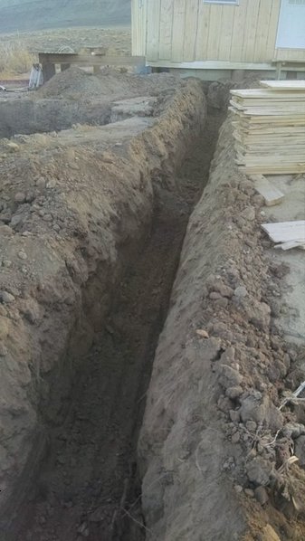

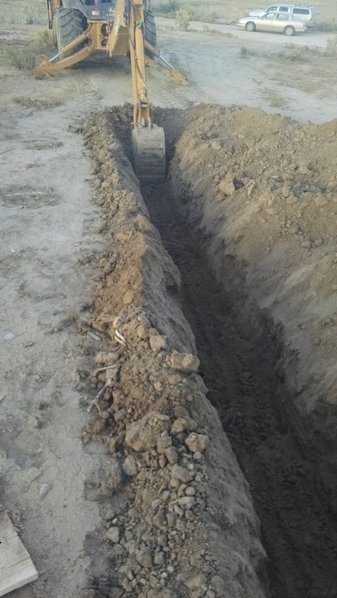

    Finally got around to digging trench to run power from pole to cabin.

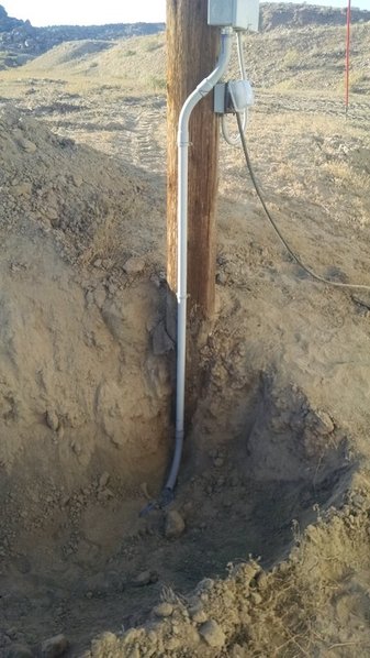

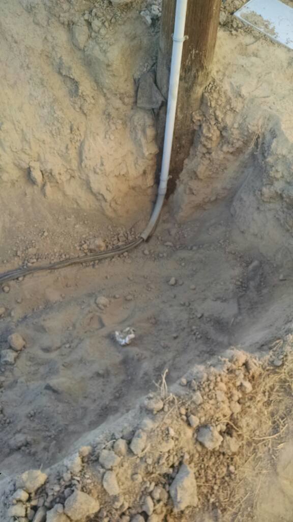

    PVC conduit from meter to underground:
    Using direct burial cable but wanted it protected where comes up out of the ground.

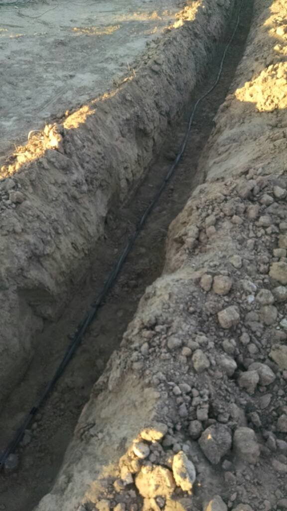

    Fished wire up thru conduit into meter box - it was a bear but got it done:
    112f75616f9baf179d8c5266ebe9bcbd_98b2aa5dd670b7f7e8c7d8bbaecf4fed800e4c8e.jpg f369b1bebcb2abce1c99dd07a069060d_7c5500d8da36065c323aab78f304f64f36b9fca6.jpg
    Got wire in trench and up into cabin. Need to get a wire clamp for securing it into the panel. Too dark for pics of inside when I was done. Get some tomorrow.
