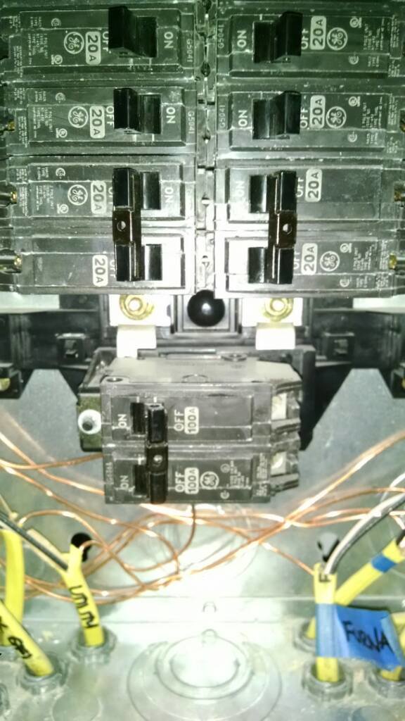

    Where's your main breaker at for your electric service? Your panel looked to be main lug only. NFPA 70E/ NEC states no more than 6' of un-fused conductor inside a residence. Love the cabin. Wished I was in your position to do that.

    I did buy a panel that was main lug only by accident (that's what I get for not checking the box before I left) but I then went and bought the main breaker conversion kit for said panel.

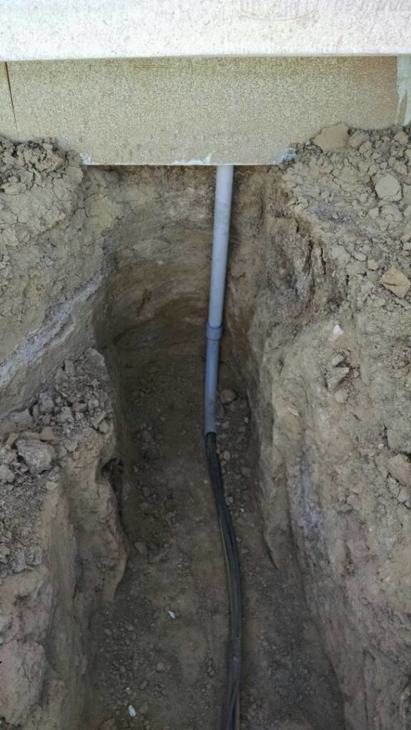

    Conduit up into cabin:8ad50ca192f593f696de67d2c2f0622d_98a56bcaaada8fd0840208021be67bd456aebe33.jpg

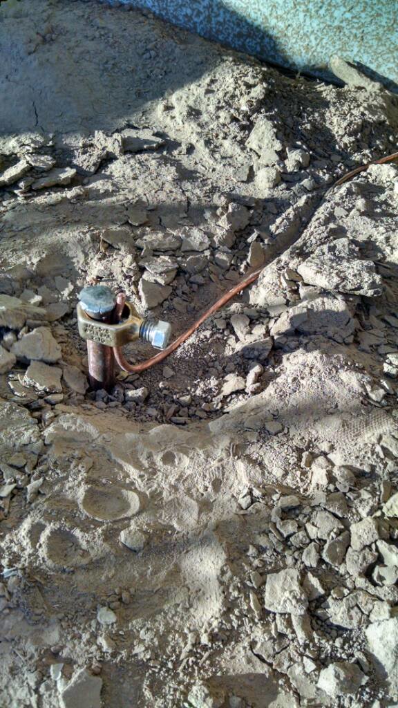

    Panel ground run to 8' copper rod outside:52877d39b9b6b018ff0fd2a9e2758f38_0085e850e034f2061d434e5c59939c942447bfcb.jpg

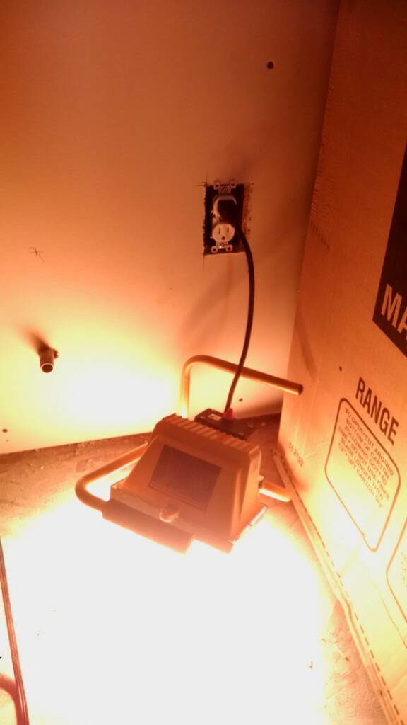

    Landed incoming service wires in cabin panel and also in meter panel. Flipped meter breaker, walked over to cabin and flipped main breaker. Flipped fridge/range breaker and plugged in light to test.....a3b3bcb4a1f4f44a292f9de6c40c455e_3746a4da3613d03177053509e16325e4948958d7.jpgSuccess!!!
    Now I won't have to travel as far to the fridge while I'm working! :cool:

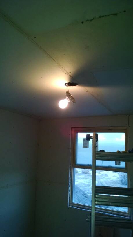

    Working after dark won't be a hassle now.ca9035798d51465a8d05e4577bcd1976_f85b86b494f144cfca0045c160ae0e25cea70eb2.jpg
