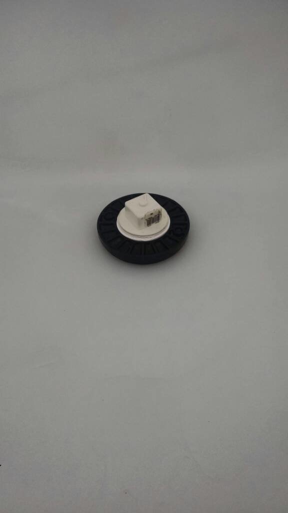

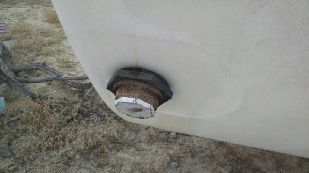

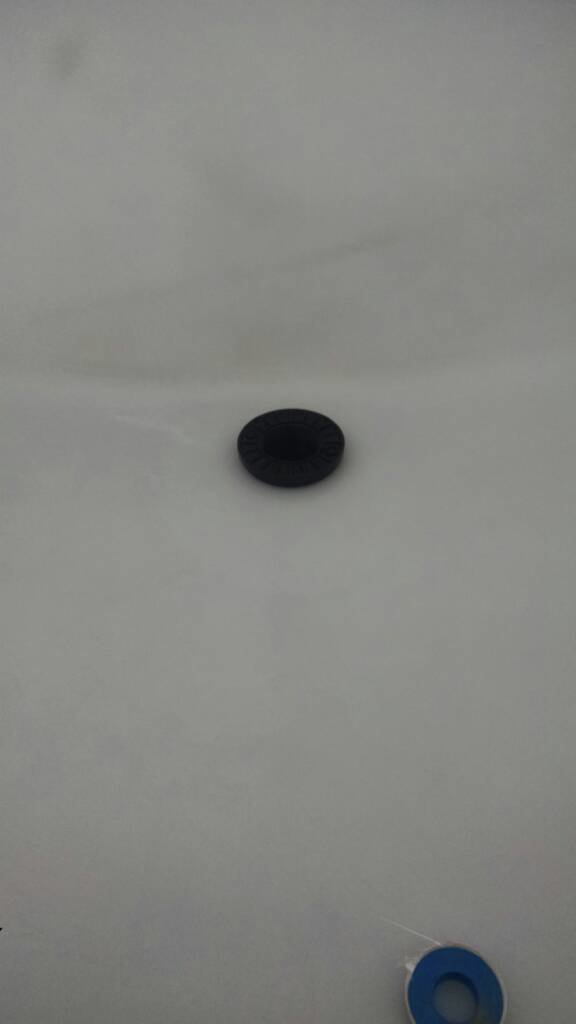

    Got my cistern tank cleaned out today. Climbed in through the hole in top and scrubbed it down and hosed it out. Plugged drain hole from the inside:c0c786dbc4c86da295386e4d27b4525b_35fa98f9555643223c01354ff421cf93642e7ffe.jpgd46c7bdea12c92d6fe006b89db52acc0_22d5c1385f0ed4cf3b9163bd69f44bb5307b6ac4.jpgPlugged it from the outside too - just for good measure...e4782fb5d57dbaf86efec53442c0c5c1_0dc6b75a215ceb4d9eec79a3696f1fb8dbe27b32.jpgGot some heavy duty ratchet straps:f2269a6a9bd75d9059b6dacc072cd652_098955c664d16f8a47efb43099d970239878727a.jpgReady to transport to the site:4f30c674606f4f2cfb7804ea117b7a1c_28e32106d56d2fcbae01a304caa6ce7ac06ced8f.jpgDropped it off at site and used loader to fill in electrical trench so I can set tank in hole tomorrow.

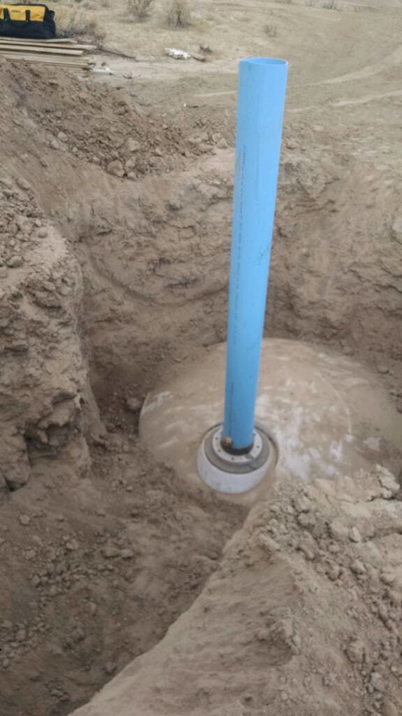

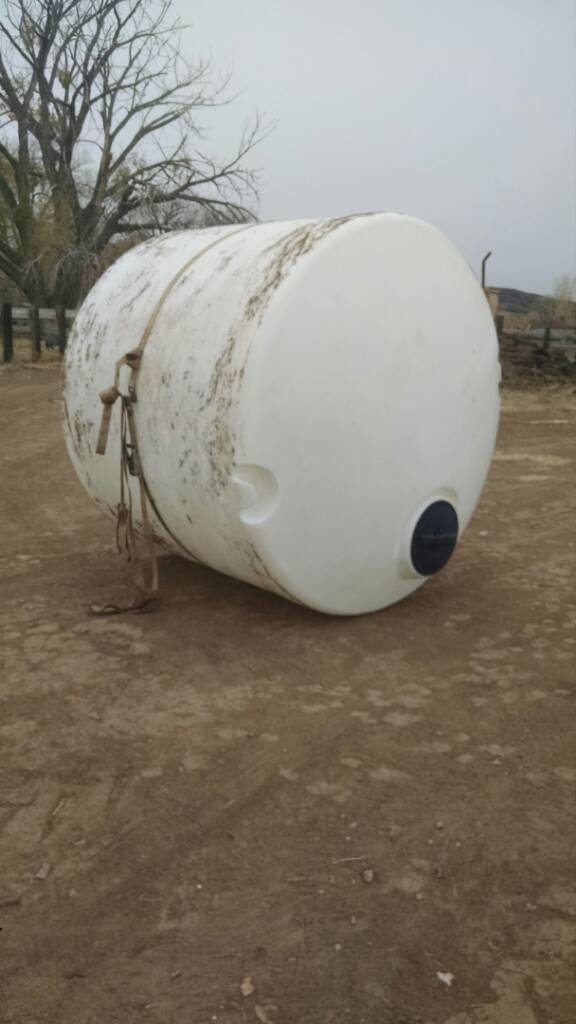

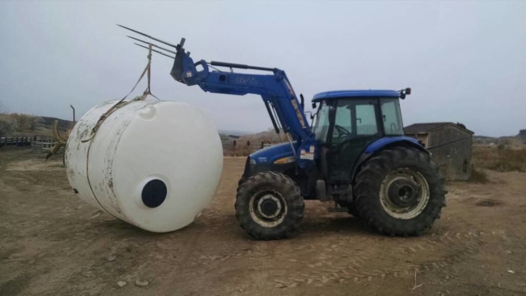

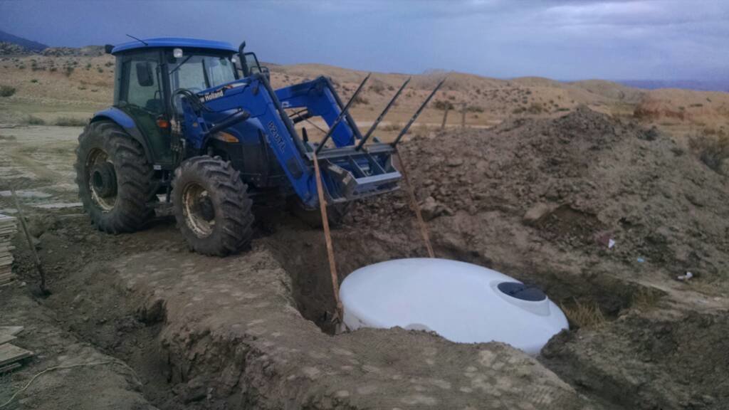

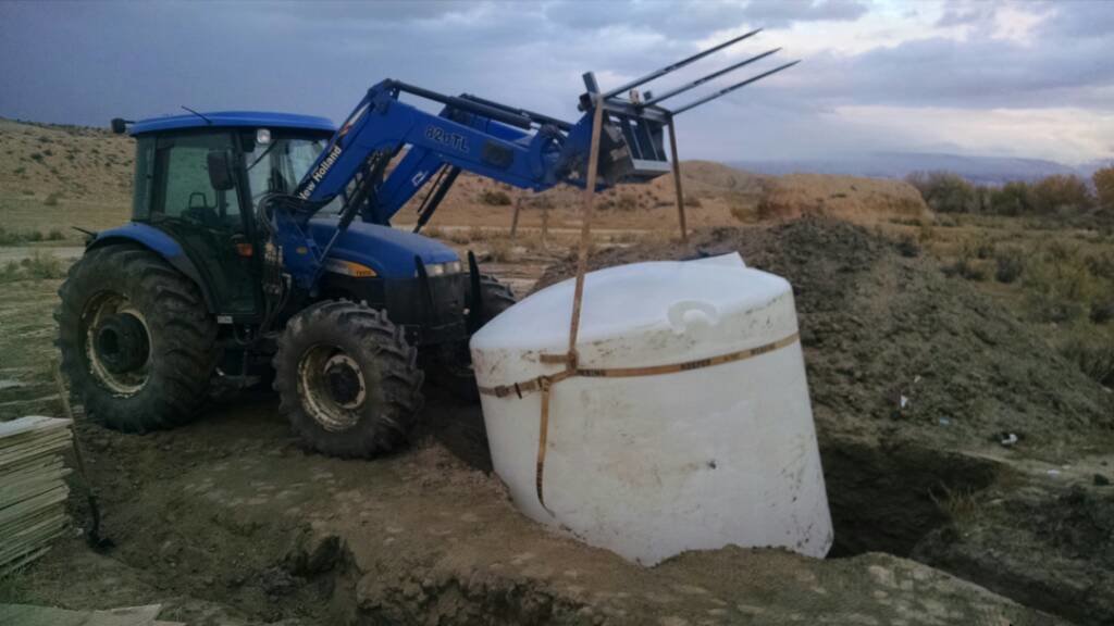

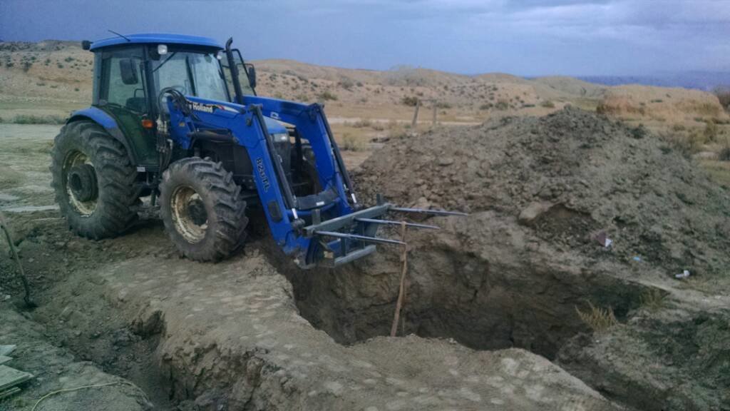

    Tank being set:1ab08fa3d0abf70aee8bf365b898ed6c_c9f0807f6688bcdf51c8173d2f56cb7f4b9487c0.jpga34f21f6acdc57b9d2f138e051f850b4_0e7e5a98bf4466fb896a867d0e5af018d456f007.jpg2a973ad55d006ed5a7a4c9911066527f_9c87094dbd048a8eba2af6fbabbb0cfa26f825cb.jpg4c883484e16272df37bf7395a4120aaf_bd017353579145732a0c57985786dc5fc1a24e22.jpg"It's in the hole!!!":cool:

    Lol, it doesn't look like I could fit my leg through that hole, let alone climb through it.
    Looking good, OP. :thumbsup:

    Lol. Can't tell from pic but the hole is about 18" in diameter. I had to squeeze a bit to make it through.

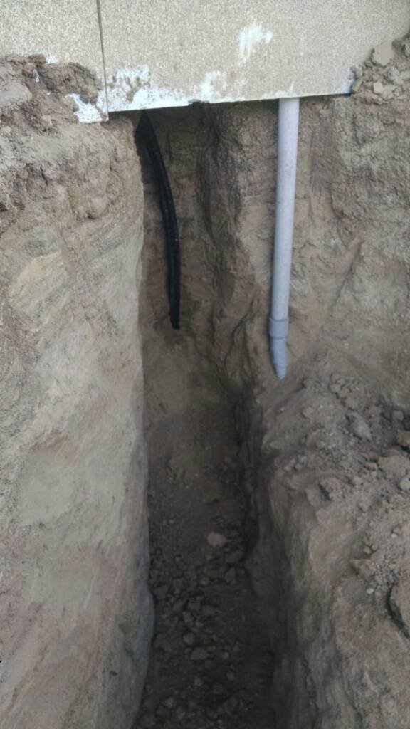

    Had access to a skidsteer this afternoon, so electrical trench got backfilled.0ba56d1a64a713e1385cc0bcd7313263_b58158f0e2f2569bccfd13c8873f4bbf191c2ddd.jpg

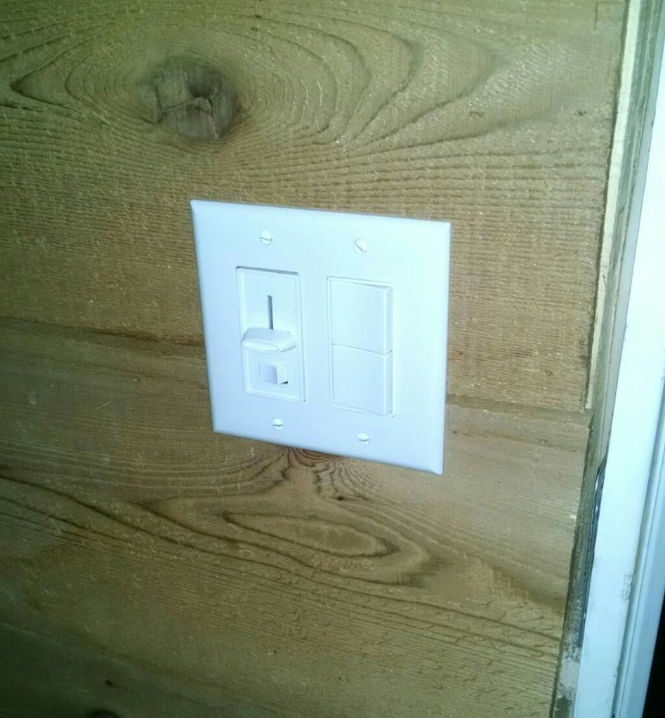

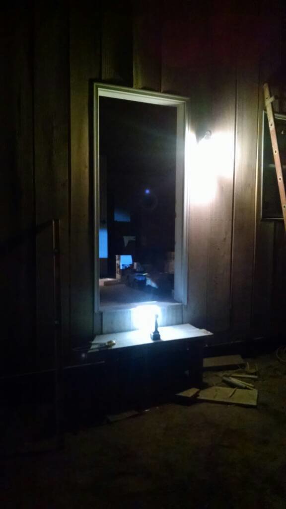

    Got my exterior light wired and mounted: abc47b1fb5f9b0e67d03eeaba319d5aa_ac5360be5aecfe1b95ad2e09d6541a47e910c038.jpgf8b66b1e31103606ca8765b66e16eb87_7871339f4ce99424e6b79d99590fe52d356cc99a.jpgSwitch on the left controls living room ceiling fan, top right switch controls 3 interior living room wall sconces and bottom right controls exterior light outside door.

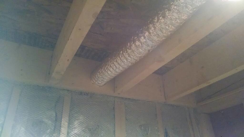

    Terrible pic, but installed bathroom fart fan last night.f8b26fa18876acb7200ff933c19ad231_66e90d82874e8c126de69473e0eb3bb8372d67b9.jpg

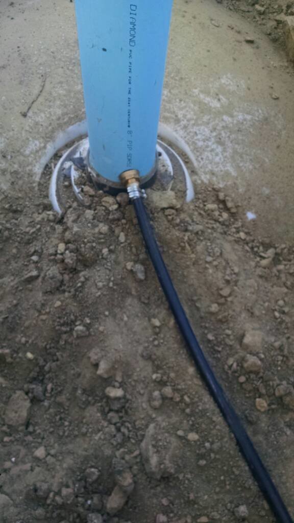

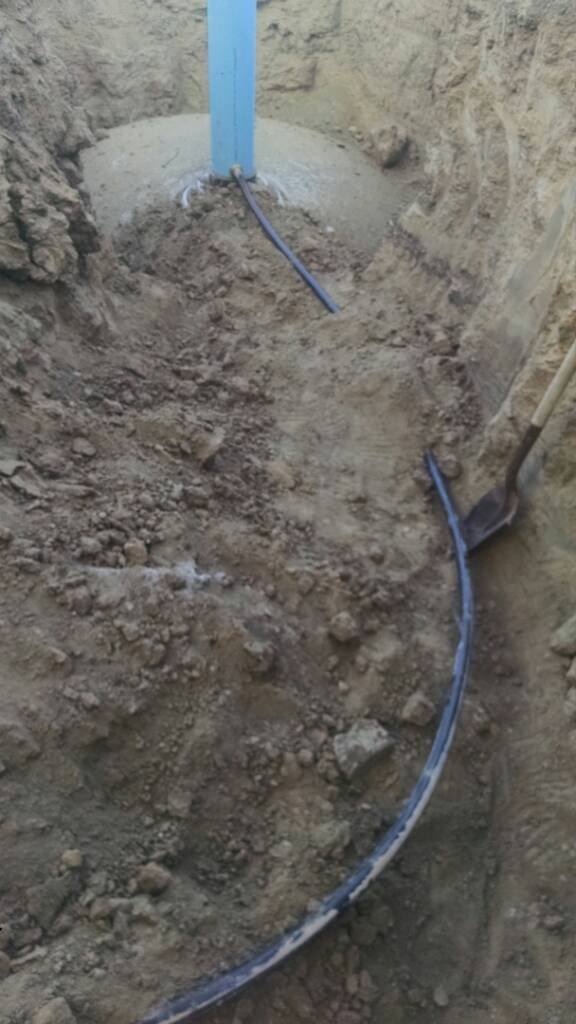

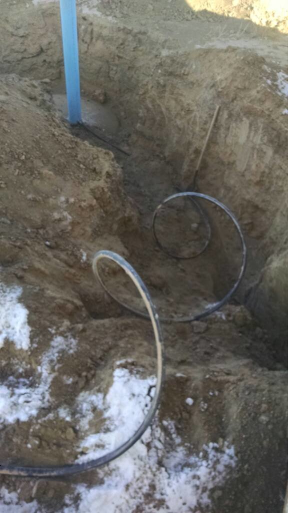

    Got my access pipe with pitless adapter installed:ce2efe53f3481a45a5729e2e8ee7dd71_da30007a9a152343ffe9cefbc22a891bdb44d384.jpg Water pipe trench dug as well. Last 4 feet were a bear - too close to cabin to use the backhoe so I used a good old spade.

    Just a suggestion , take it at your own peril but you should insulate the first 4' or so of that pipe if that is an exterior wall , plus I always make sure the last 4 or 5' or more of the pipe is pitched down slightly toward the exterior , that way if you get any condensation build up inside the pipe in winter , the water will drain out through the vent towards the outside

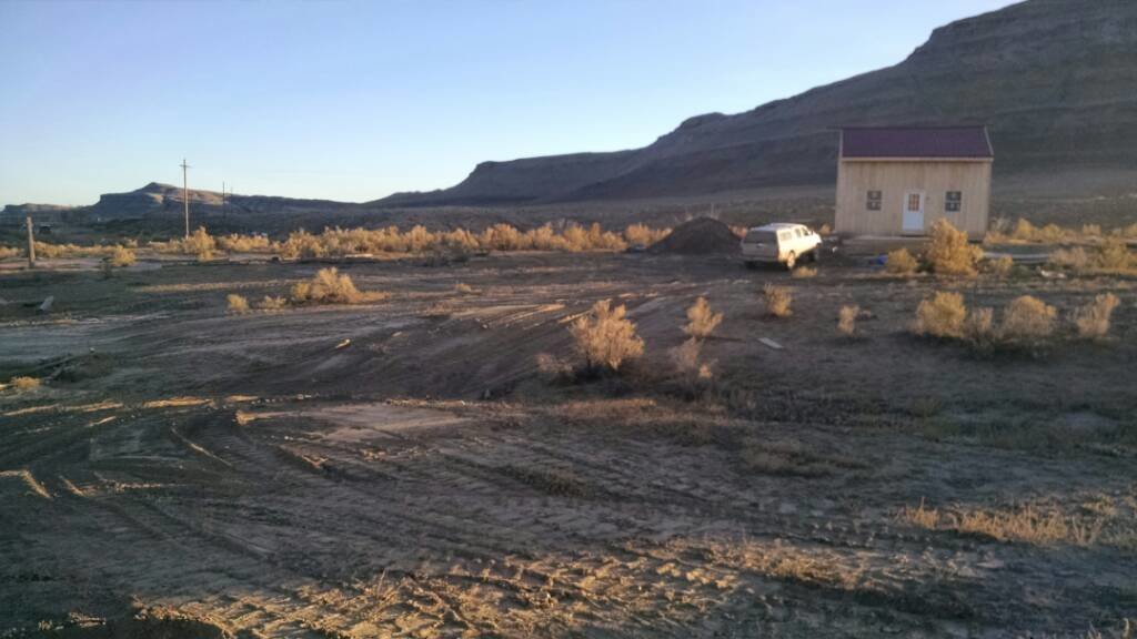

    Got the supply pipe run over to cabin from pitless adapter. Pipe isn't so flexible at 20°F:1f7e0a7388bebc61f45985e661a92d09_97d730ab3afb64e56ada3a5ae1415ba6f0db8b06.jpgbe439a4c33e5a1e9fcf523f8076a2011_a5dce8434e5650bc08a54d88452b0f09b8c728c7.jpga11278b1c8beacb471820532e7a8e7bf_d9a184f43e66655859b26176d47f90fe69b76cf8.jpgca0324ff29194d8b4e757637f98a6536_b210f60e25c4c3896d99da7e46aa1d84f79d3dbe.jpg8e66f95c3624ed9b4ad473eee7284d5c_9d5e1be1f8d736ecc12338553082c79946a7902b.jpg

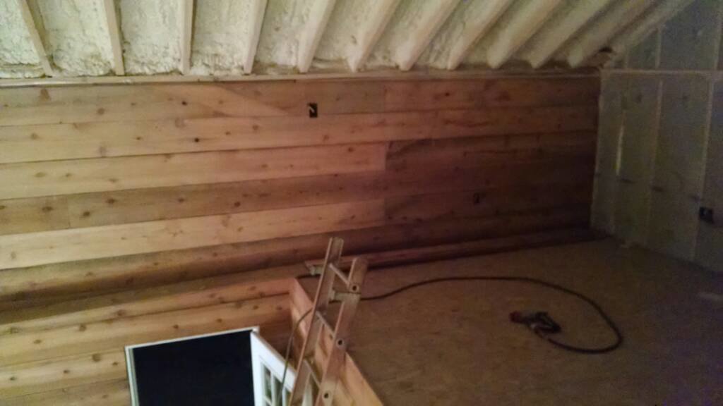

    Got some time tonight to finish up one wall with cedar:738257789d0c5053e269753cae643b5e_439a2b2c9645e32b729407884916ad9d9d4f52f6.jpge915f71e77f669ba528e94a4c5a51dbc_e4474a042c614271ccf5251ae9f72a472faa9050.jpg
