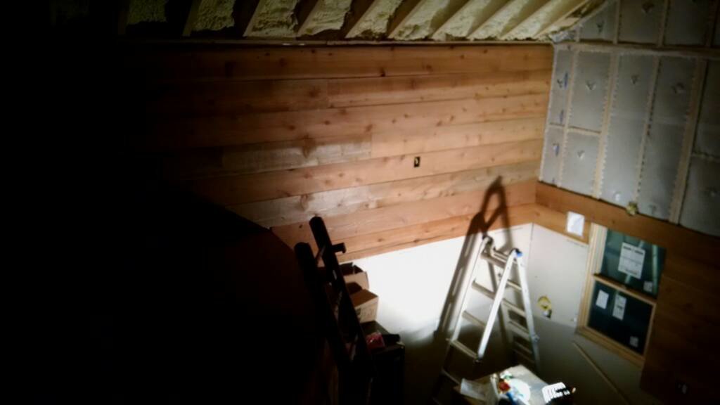

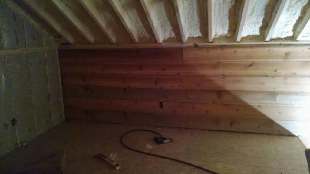

    Got another wall completed tonight with the cedar boards.584635a56bcec720e322c369d8917316_a6d3847da18243c8c7c7e7c0d585e709ffba6f59.jpg7d4710771590accffa57beed3c55c2e4_54869dbb126b27d5ea30acba3a070283d8d2aa60.jpg

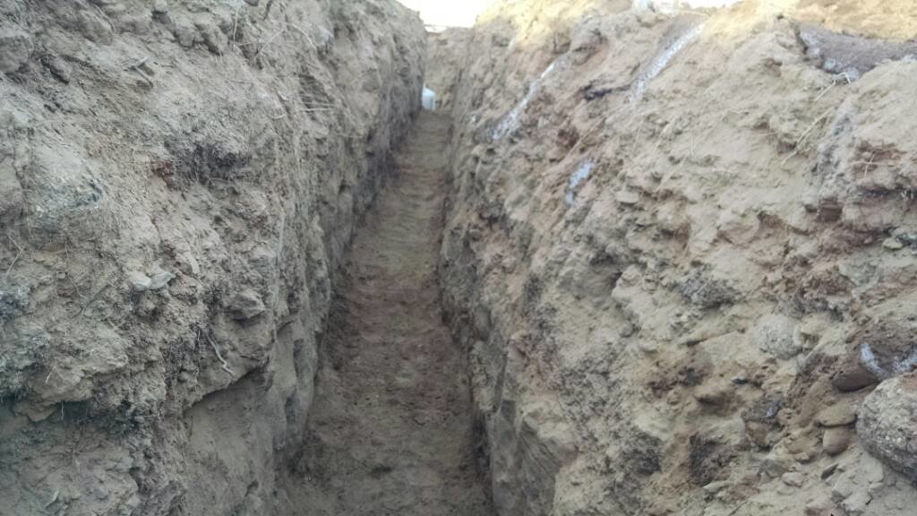

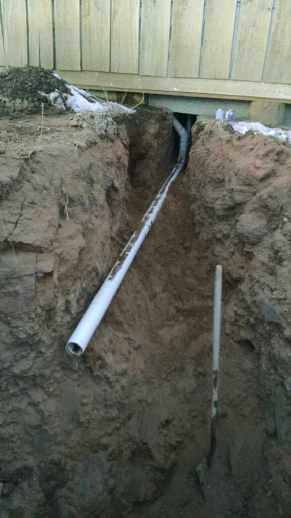

    Finally getting around to getting some spare time to work on cabin again.

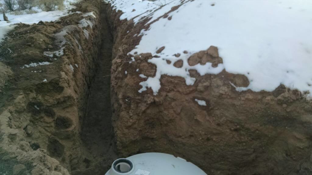

    Septic system is next. Good thing only the top 6" of the ground is frozen...
    3" drain coming from cabin:477becd0a4cae28f8be58a5ab5cfd6c3_6f58accf36f59293ed16578a5a07e3ab41376945.jpgDIY Septic Tank:2d00c57e6a6896b8ea3c63e524e28fe3_630ce7d5e7d9b314e904404e8ebe6850e2a39e57.jpgLeach field trench:d62ab0b3bdfcc5d3d51db85f60ad8e67_fdfaebe35a095834b4ae8d47757d6f17091dcf9a.jpg7123ce01bf0b18fd298301ee3bebc3d3_f3d15d602ad072cb3a46740f42f52436a9bcc43e.jpg0bd216862c4f64a9d7b898b3d5f191ad_a2a473e1d332835829c0c74cfd5998fdb388d36a.jpg

    Is that a 2 chamber tank ? and will you be able to pump it ?

    Way late for this question, but definitely true. Keep them apart.

    I put a dividing wall inside the middle thus making it a two chamber tank. Going to bring a pipe down into the top to allow for pumping.

    I kept at least 12" between them. Thanks!

    You want to avoid solids getting into the leaching field

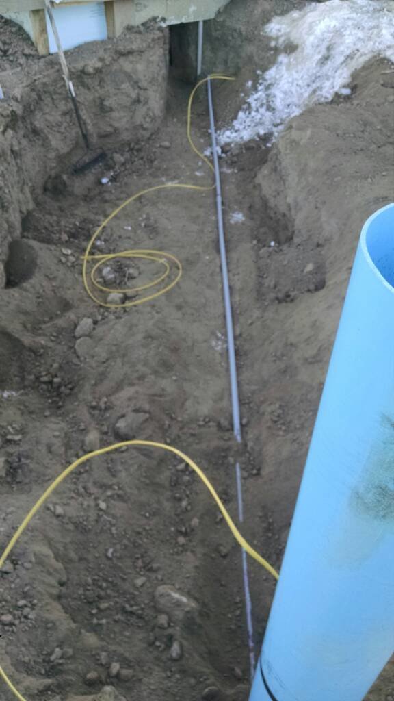

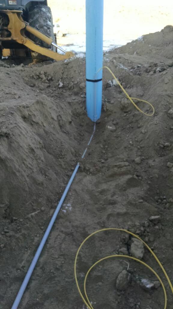

    Conduit laid and wire run for cistern pump.3862d593a8cc13c7708e0bb65c11cec2_83ec60c74421049a9995b21eb4b55bcb801bf47e.jpg7c0723a2a8ae17633e42f41adef40f9a_912ce85e9951617ac1364fdbe244a3455abfaa8b.jpg

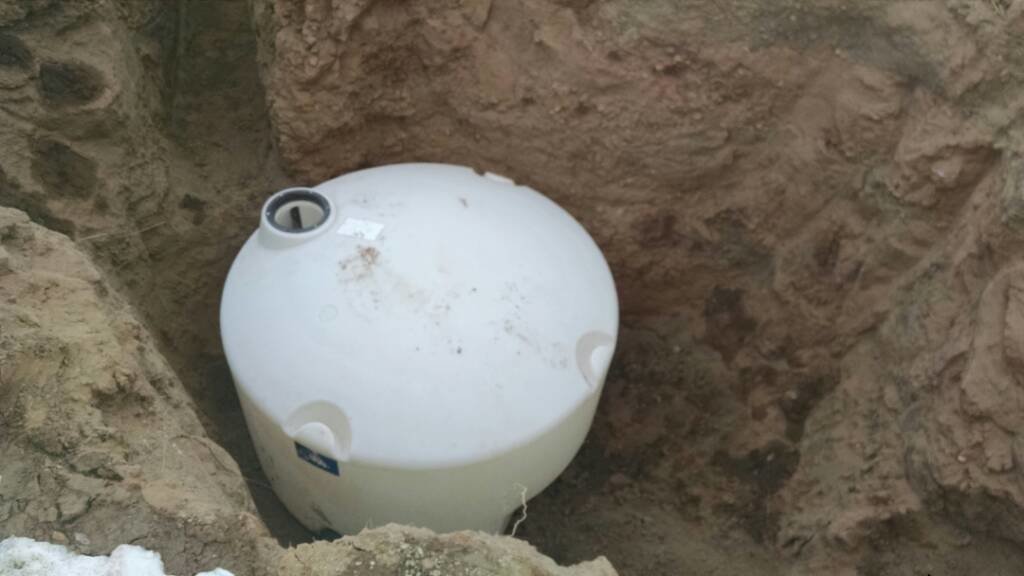

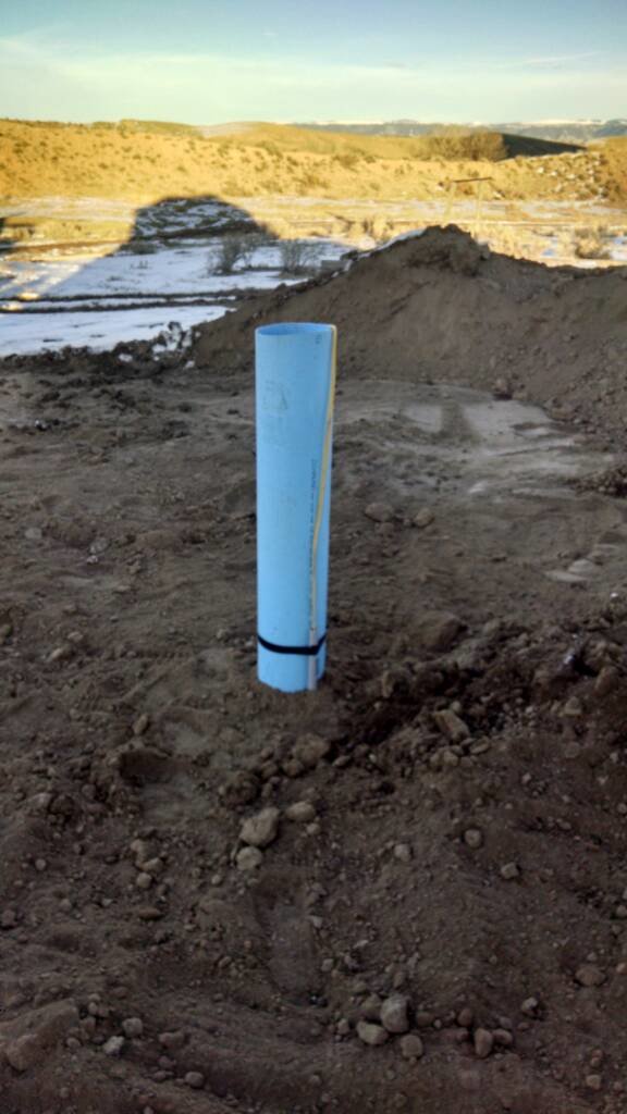

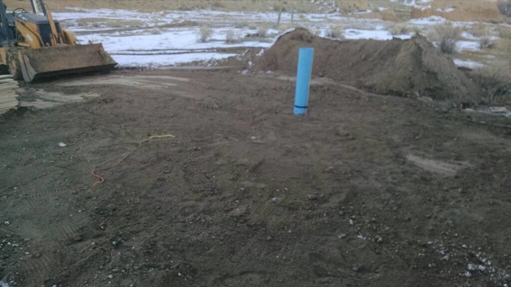

    Backfilled the cistern in:fb92f81ddab95ce3f09ced5f48f5e254_33187ecde8be9760a3f36203aad221cdd380246f.jpgb21bd0d912ba83d0de4cd930a8359cdb_c812b46a95bbb98818c8eebe9297ed3b19203b27.jpg
