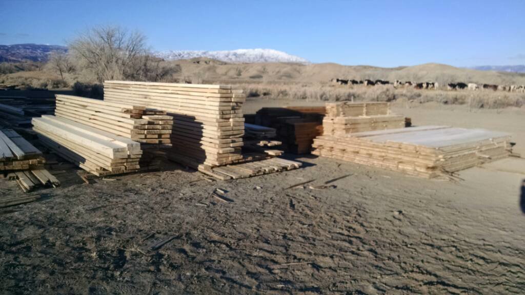

    Please, please, please, tell me you either air or kiln dried your material down to less than 20% moisture content. If not, you are going to have major problems in your future.

    Freshly sawn (ie: green) lumber will shrink between 10-20% in width and thickness until it reaches a moisture content of around 19%. Furthermore, this shrinkage is not consistent from board to board, or even in the same board. Finally, because of differences in grain and drying, green wood always warps, cups, checks, etc. at least a little.
    When lumber mills manufacture studs and joists, they all start out at their nominal thickness and width, ie: 2x4, 2x8, etc. After air drying, which commonly takes a year or more depending on climate, or more commonly kiln drying (think of a big convection oven), moisture content will be around 20% and the actual thickness of a 2x4 will be about 1 5/8" x 3 3/4". Lumber mills will then run material through the sorting process and planers bringing the final actual dimension to 1 1/2" x 3 1/2".
    When framing a new home, even with kiln dried lumber, it is important to let the building dry out even further. This is normally accomplished by quickly getting the building under roof, and leaving exterior finishes off while MEPs (mechanical, electrical, and plumbing) are completed. This will allow the final moisture content to even out to around 18%, at which point it will never stray more than 1% unless you have major problems.
    So what does framing with green lumber do? Drywall pops, and cracks will be the first items noticed. Windows and doors also will begin to bind in very short order. Wavy walls will happen in most cases. Trim, including cabinetry and paneling, will develop gaps and in some cases cracks due to the framing moving. Finally, fasteners will tend to rust a bit, and in the case of paneling and siding, will bleed onto the finish side. I know it's a long winded explanation, but using unseasoned construction materials can be a huge issue.
    Hopefully I am wrong, but the OP's pictures and comments regarding the weight of 16' 2x10s lead me to believe that the wood has not been seasoned.

    Yes all the lumber was air dried for several months in a desert environment before construction started. I wanted to go the kiln route due to it being much faster but it was cost-prohibitive. I got a much later start than I had originally planned due to the air drying.

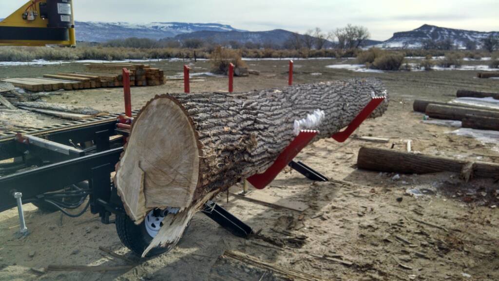

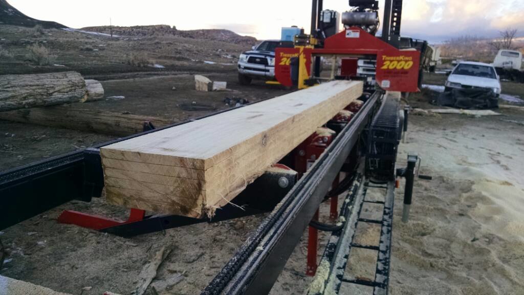

    The weight of the wood I was referring to was lifting it off the sawmill back when it was cut as I was doing all the cutting solo.

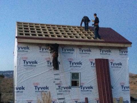

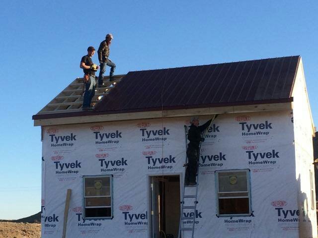

    Tyvek Installation:

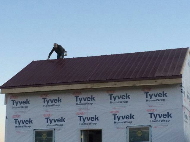

    Metal Roof Panel Install:

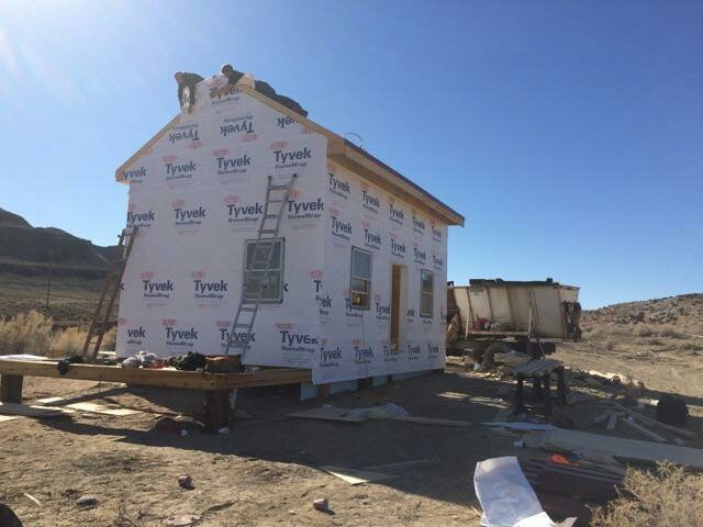

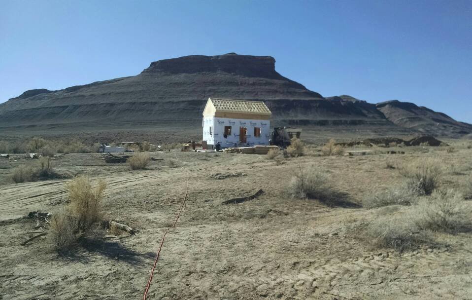

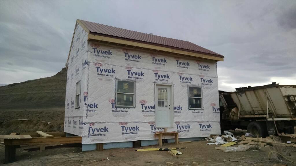

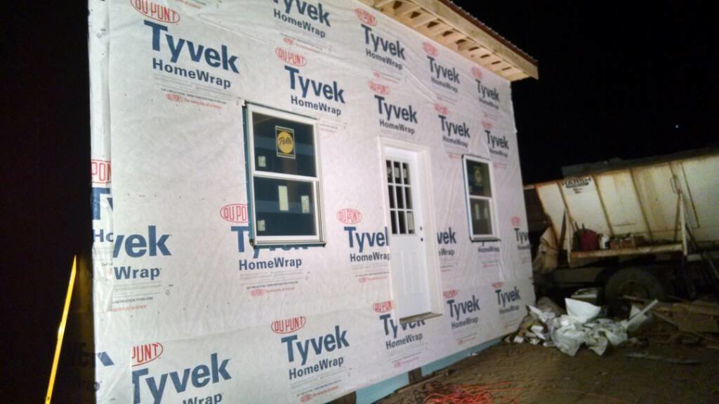

    Doors and Windows:
