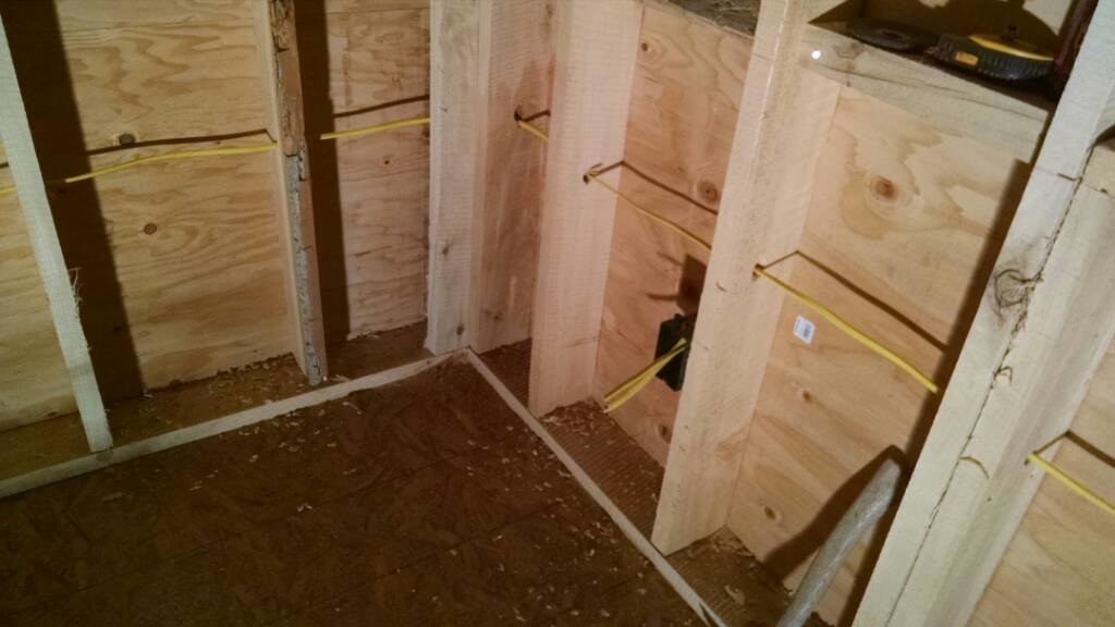

    Starting on the wiring during the after dark hours:
