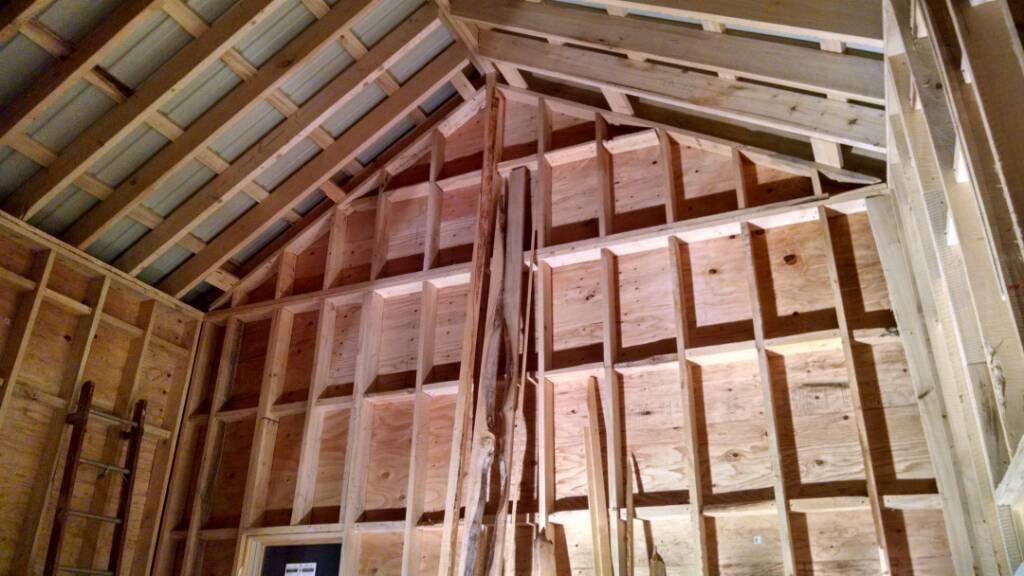

    Any lighting ideas for high ceiling above kitchen and living room?348d20e85c180bbd57b1b4329646afe2_221e2ead1113c39304c8b29472c421e800308673.jpg

    Pendants or suspended cable lights

    Is your blocking in your wall framing a normal framing method in your area or backing for vertical siding or something ?
    I'm not trying to pick your work apart just curious about building details in other areas

    I was assuming the end walls are acting as the shear walls and the extra blocking was to make up for the lack of collar ties above.

    Not a normal framing method. I put those in so there'd be something substantial to nail the 1x12 vertical siding boards to. I didn't trust just nailing them into the exterior sheathing.

    Gotcha
    Yeah , I do similar blocking for board and batten siding

    LOL, I was waaay off with my guess.
    I had to go back and refresh my memory, you're using the second floor loft area to keep the walls together, right?
    Does the loft extend more than halfway?
    Also not questioning your work. Just trying to learn from it.

    Board and batten is what I'm doing. The blocking kinda screws up the ability to blow insulation in.

    I usually run mine on the flat

    Yes the loft does extend halfway.
