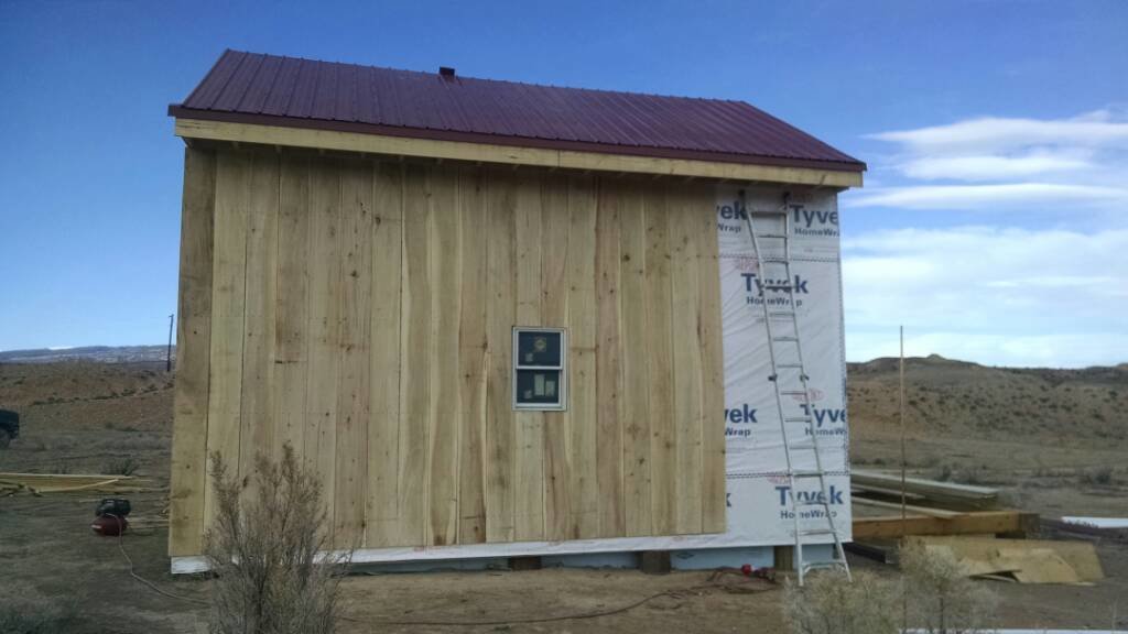

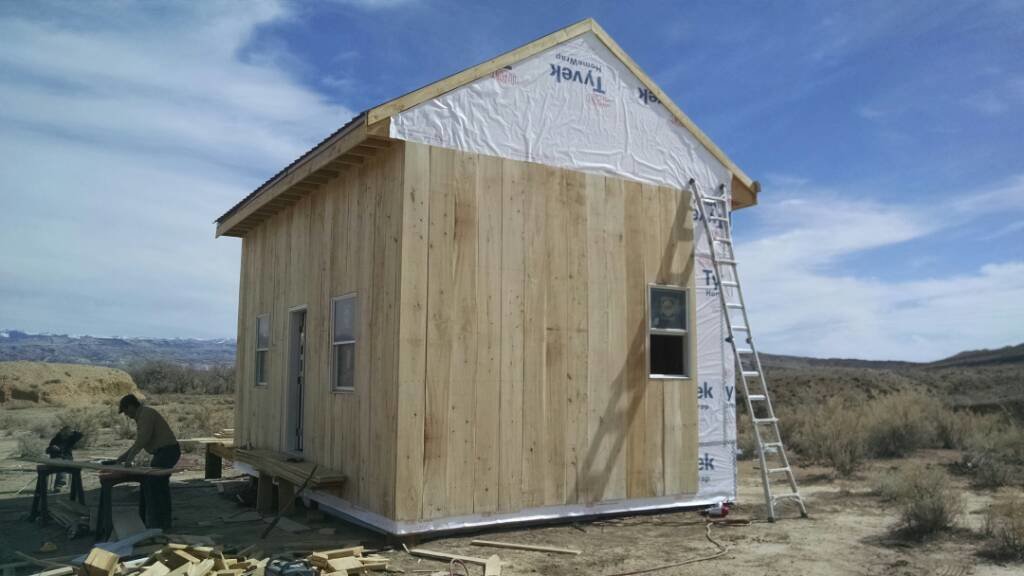

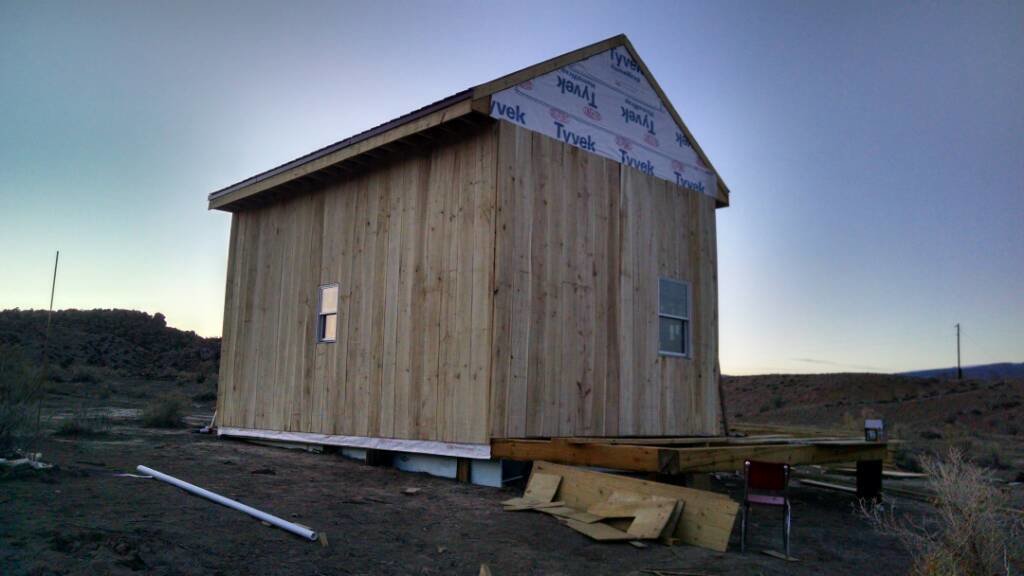

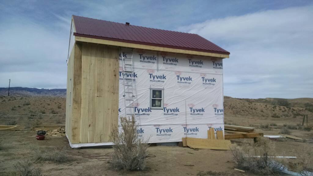

    More exterior boards:
    182f6ca8c9c3ef468da73184e816412e_b473cd185a6dfd32e8824505285729950111a847.jpgb826777af3b516777dcc762cbb54ace7_fab939248dae39807034aa68dbc299b6f1457bf3.jpg7281e0d55850a33eea69f747c1077a0b_3eb238e5977cf0dd92eb6f9722a072d1a1e71dfb.jpg

    Just the eaves left now.

    You could do a ceiling fan that drops down pretty far. Love the build!

    With a 12" board, would you do a 4" or 5" batten and window trim?
  15. Apr 3, 2015 at 10:27 AM
    #155
    OZ-T
    OZ-T I hate my neighbour
    Dec 15, 2009
    #27584
    50,587
    Peter North
    British Columbia
    My board and batten pattern is usually 10" boards nailed 2" apart from each other and a 4" batten that overlaps the edge each board below by an inch .
    My window trim detail is different but I like the idea of picking up the batten size for your window trims

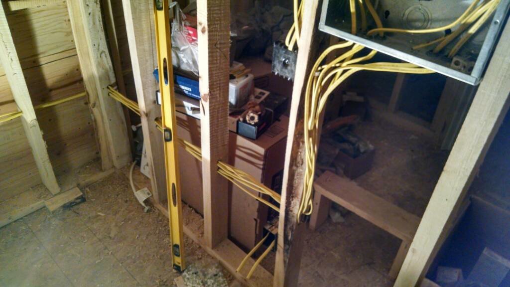

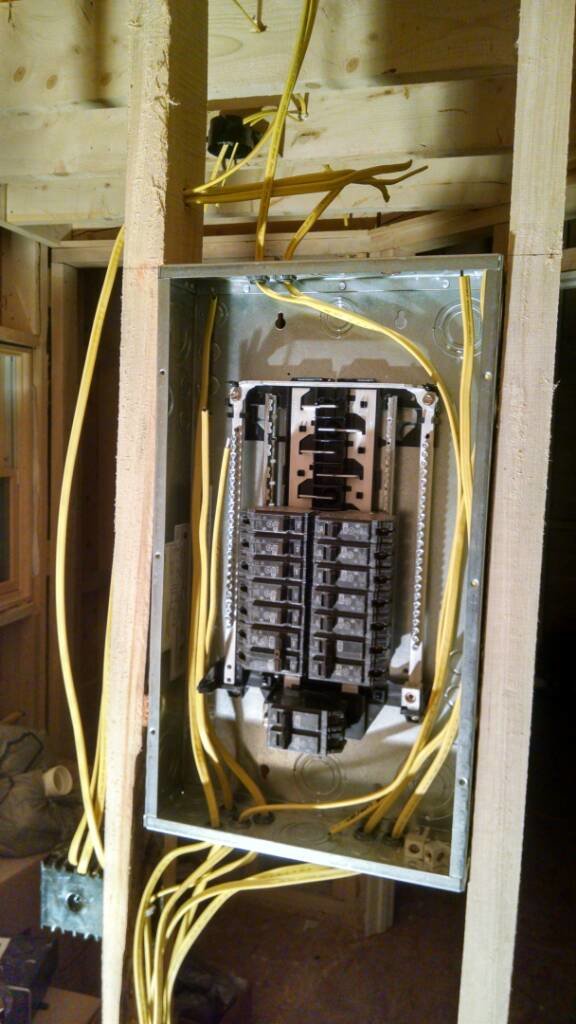

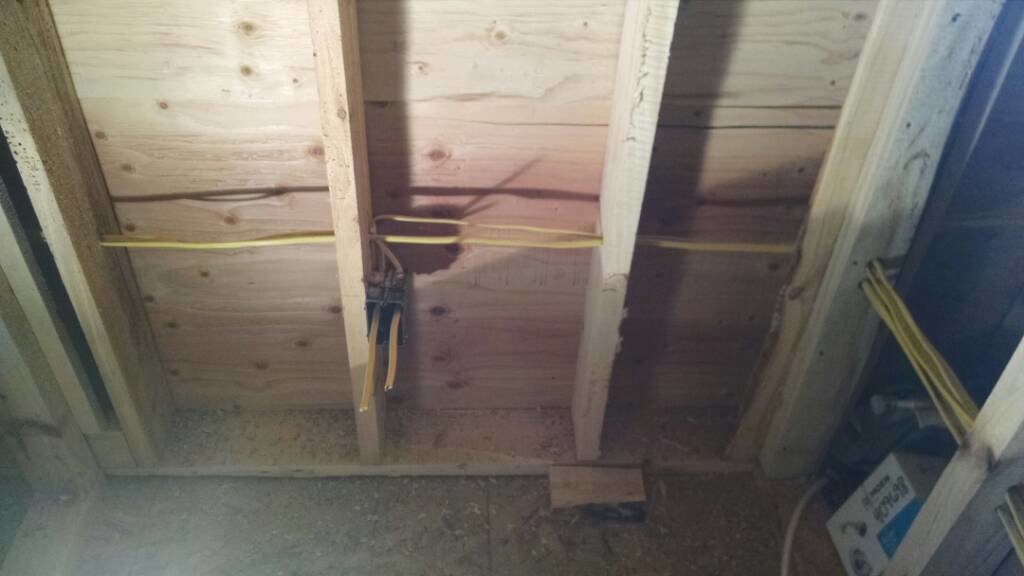

    Wiring: Most home runs are in and just need to land them in panel.

    What size wiring are you running?
    That looks like 12/2 Loomex to me. Although I live in Canada and we have different electrical codes and Loomex is a Canadian brand so maybe you guys do something different in the states. I think you guys go by the term "Roomex" which is one of the same and is basically just Non-metallic Sheathed cable.
    All 12/2 Loomex in Canada is yellow. 14 gauge wire or 14/2 (which comes in white here) should be more than enough for general plugs and lighting, and would save you a lot of money on wire compared to 12 gauge. The only thing that you'll see ran in 12/2 up here in Canada is the kitchen counter plugs or anything else that would require a 20 amp T-slot plug.
    I would do some LED Pot lights with adjustable heads in the ceiling wired to a dimmer switch. You could also drop a chandeller of some sort if you are going to have a table. I'd also definitely consider putting a ceiling fan or two to help circulate the air. You will need to buy a ceiling fan with a long enough down rod to clear the pitch in the ceiling. Alternatively, you could also frame a flat section at the peak in the ceiling and mount a fan at the center of the peak.

    I am running 12/2 for everything. I got three rolls of 250 for nothing so I wasn't worried about the cost.

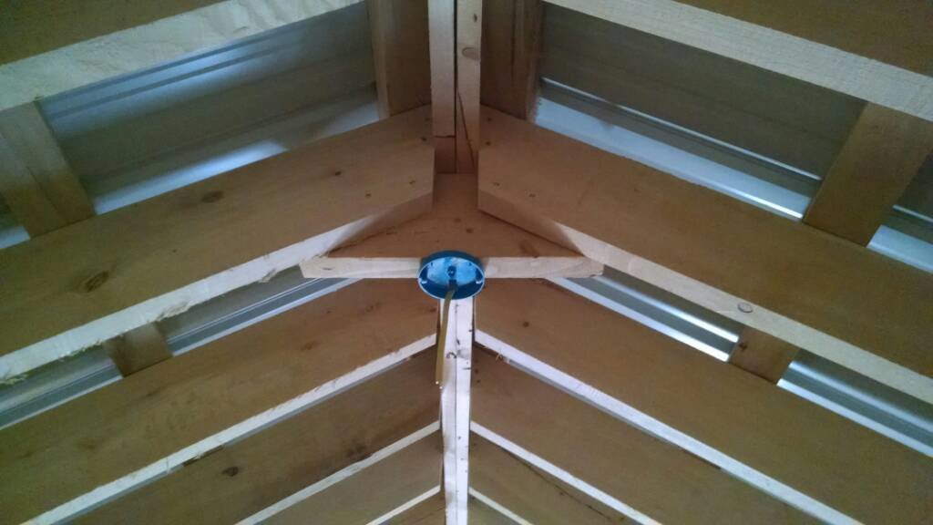

    Loft lighting via ceiling fan box:
    Think I'm gonna do the same thing for kitchen/living room area.

    What are you planning on mounting to the ceiling fan box?
    Just a light? Just a fan? Or a combination fan/light?
    If your going to mount a combination fan/light you will need to get yourself some 14/3 so that you can switch the light and control the speed of the fan separately. 3 wire is required rather than just running an addition 12/2 from your switch box as you will need a common/shared neutral wire at the fan. You could kind of fudge this if you don't need to meet code by just running another 12/2 in parallel to your first one and then not hooking up the second neutral. Not really right, but it would work.
    Alternatively, you could always just get a combination light/fan that has a remote control that would control the lights and fan speed.
