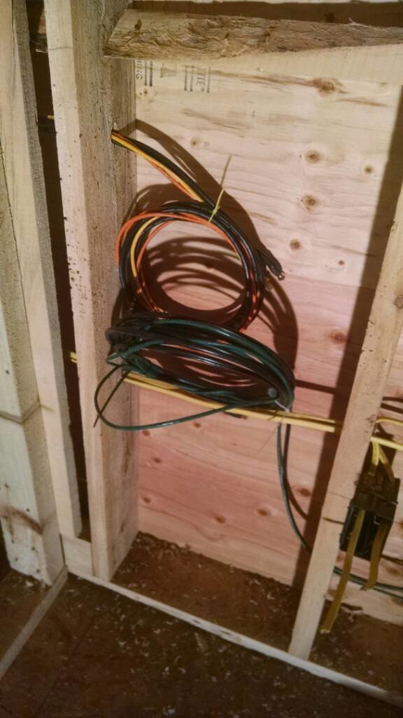

    Just a tip, not trying to knock your work or anything. Not sure if it will really help you cause I don't think you'll be wiring another house panel anytime soon but if you do. Screw or nail a 2x4 from one stud to the other about 10-12" down or above the panel (depends where your feeds are coming from) and then drill it out in line with where your wire connectors are in the panel This will keep everything in place with no need for staples and it makes for a much cleaner install and you don't have to fight with trying to staple everything to the sides of studs. I wired my first few panels that I did as an apprentice much like yours, but it was pretty game changing once someone showed me that trick.
    I'm an Electrician by trade but can only imagine of having the carpentry skills to go along with it to be able to do what your doing. Looking good man!
    Feel free to PM or post away if you have any questions electrical related.

    I am planning on using a fan/light combo in the loft. I thought about the 3 wire deal but figured the fixture would be within reach so one could control it with the pull chains.
    Definitely going to run 3 wire for living room fixture.
    Thanks for the tips and advice!

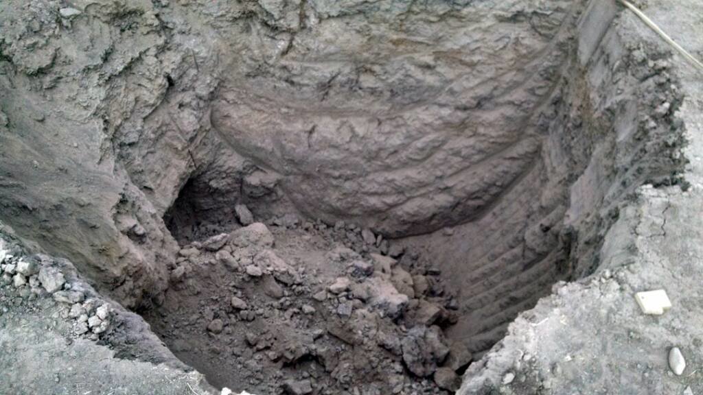

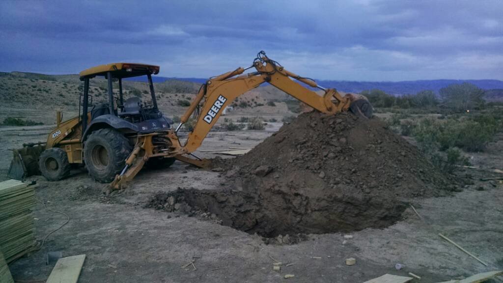

    Digging hole for water tank:
    Can't really tell from photo but it's 12 feet deep:

    What size tank ?

    Tank is 2000 gallons. Approximately 90" in diameter and 84" high.
