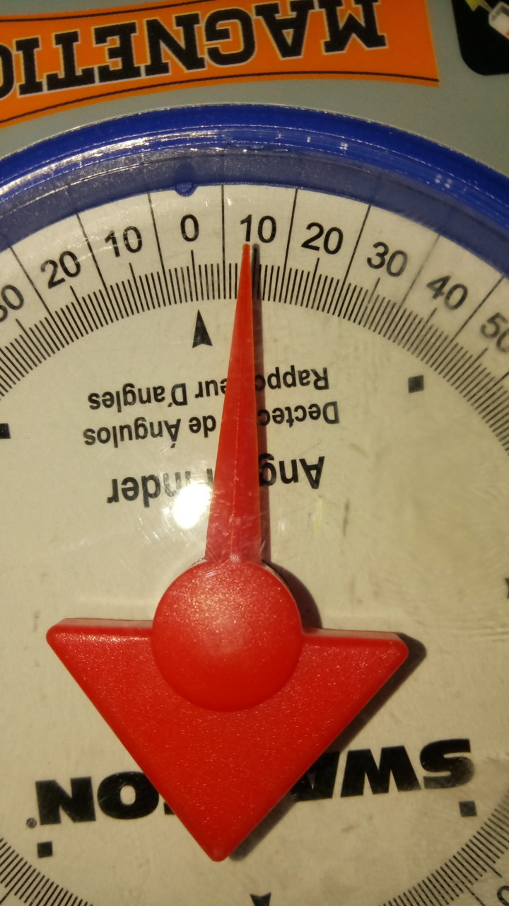

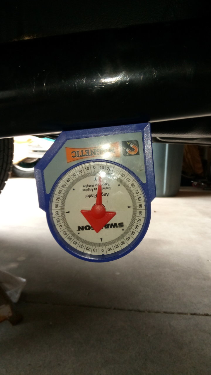

    • Yes, TW is correct get a 4" or you will be limited to stock gearing before exceeding the RPM capability of the shaft itself. This is due to the length of the shaft.
    • Just buy it from Tom Woods, they are perfect.
    • No it will not clear the cross member you have to remove the cross member unless you set your bumps pretty tall.
    • It will also rub your ebrake cables coming out of the trans hump ( if you have an auto ), easy fix just adjust their position with some cable ties.
    • Your vibration is because your pinion angle is wrong at the axle, as others have mentioned a double cardon shaft needs the pinion perfectly in line with the shaft itself.

    Toytec solid steel 3* shims ordered. I'll report back when I get them on to see if the 3" diameter shaft will cooperate. If not, they still are offering me a refund so...hey can't hurt

    So I finally got the 3* axle shims on and it didn't cure the issue I was having. I returned the driveshaft from the local shop and ordered a Tom woods 4" diameter drive shaft. Currently it's in the truck but I haven't gotten a good chance to drive it.
    For those who have chopped the carrier bearing mount/cross member ...where did u cut? Any pics?
