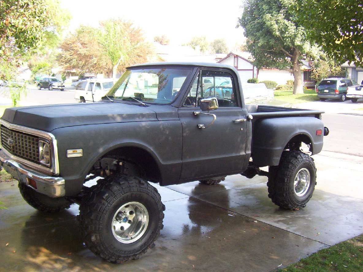

    You won't regret a TW DS. Trust me, I have spun them in some very high horse power 4x4s and never had a problem with them exploding. Here is a pic of another one of my trucks with his shafts.
