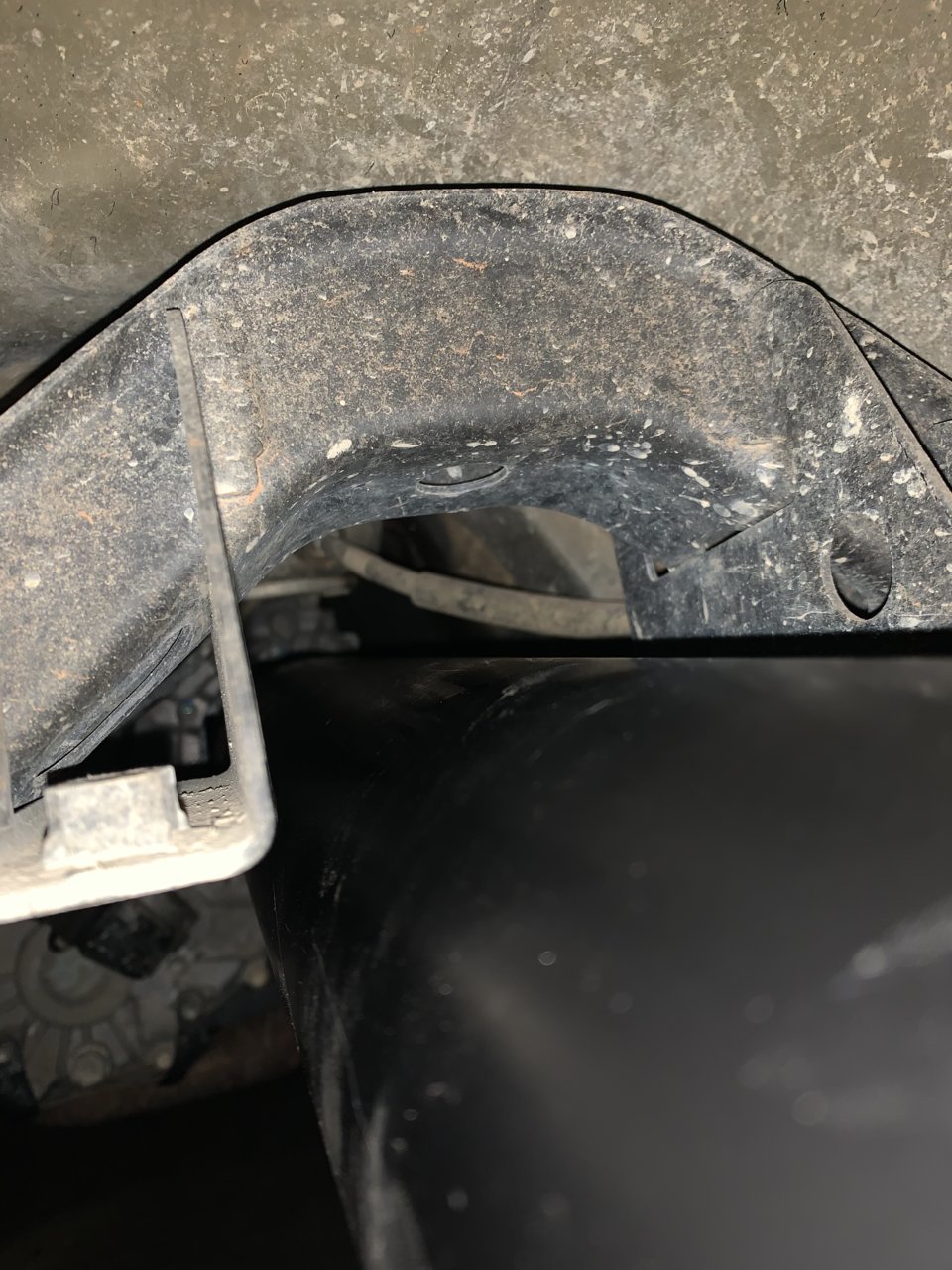

    If you cut the cb mount you can kinda fab something right there to make a driveshaft loop so it’s not chopped up empty space.

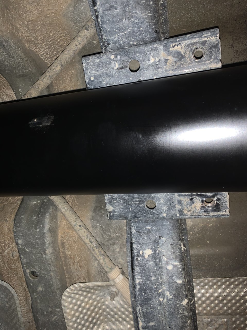

    That’s too damn close for my liking.

    It’s not ideal, but there isn’t an issue in normal driving and I wanted to run the shaft a little before I started hacking up the support in case I needed to revert. I’m gonna do some math when I get home based on max up travel to see how much upward clearance I need. I believe trimming of the CB will be more than enough.

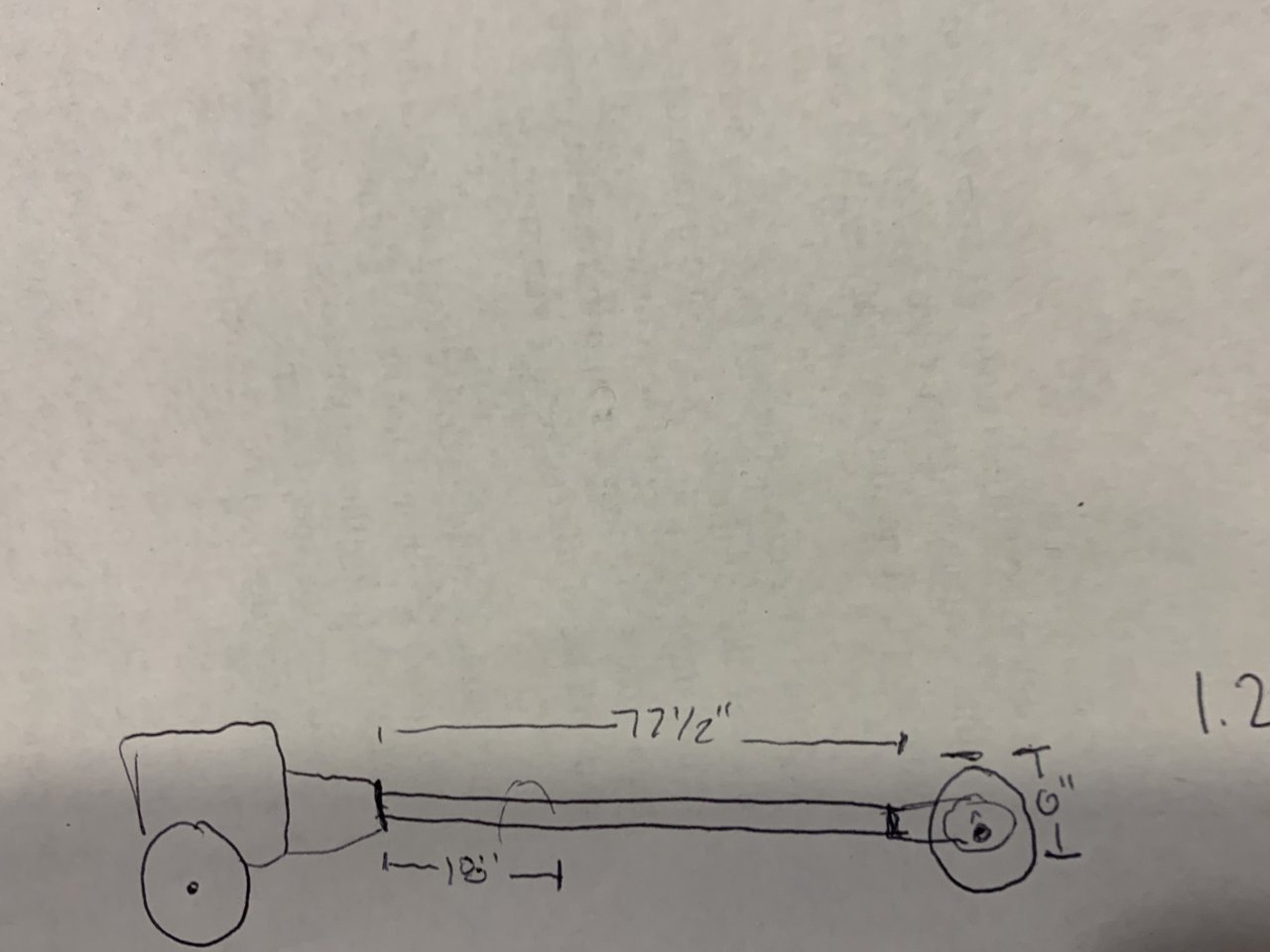

    So to address some concerns about carrier bearing crossmember clearance I took some measurements. Length from middle of cardens at the transfer case to the center of the rear diff is 77.5”. Length from transfer case to location on the driveshaft that would contact carrier bearing support is 18”. My up travel as measured from bottom of frame to top of bumpstop plus 0.5” is 5.5”. So fully bottomed out the driveshaft only goes up 1.277”. I’m still a little concerned about the brackets that the carrier bearing bolt

    Did you have to cut the crossmember?

    Received and installed my TW 4” diameter driveshaft. 0-20, 60-65 Mph vibration are finally gone. I have to get the crossmember out because its was to close. I did tried to take it out the crossmember in one piece but it’s too tight so I ended up cutting it in two pieces, thinking I can bolt it back in in one piece if I need to go back in two pieces driveshaft.
