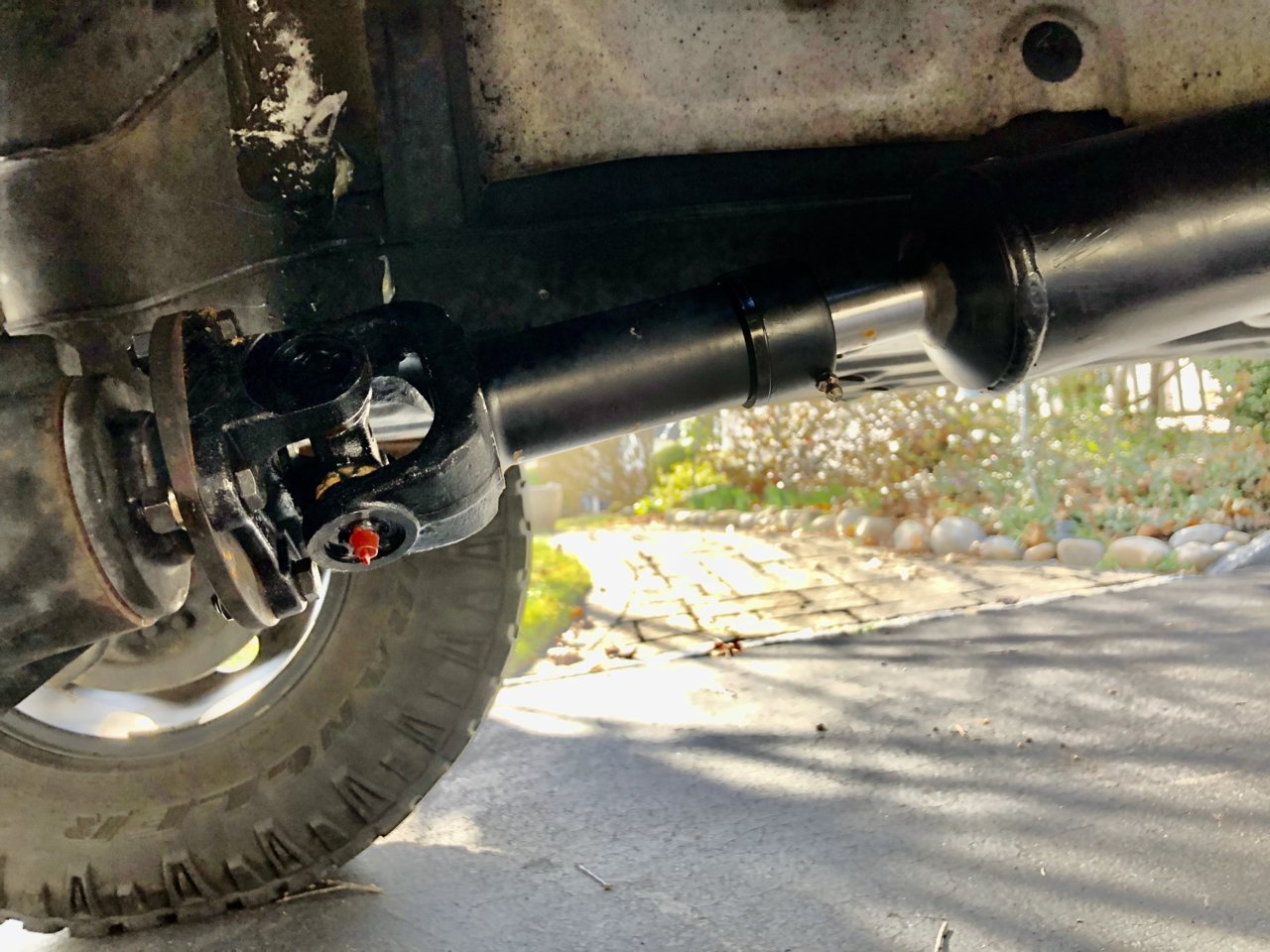

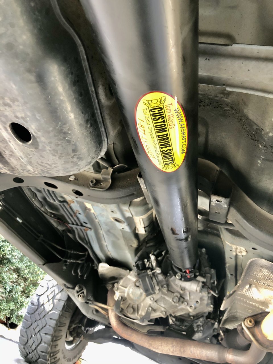

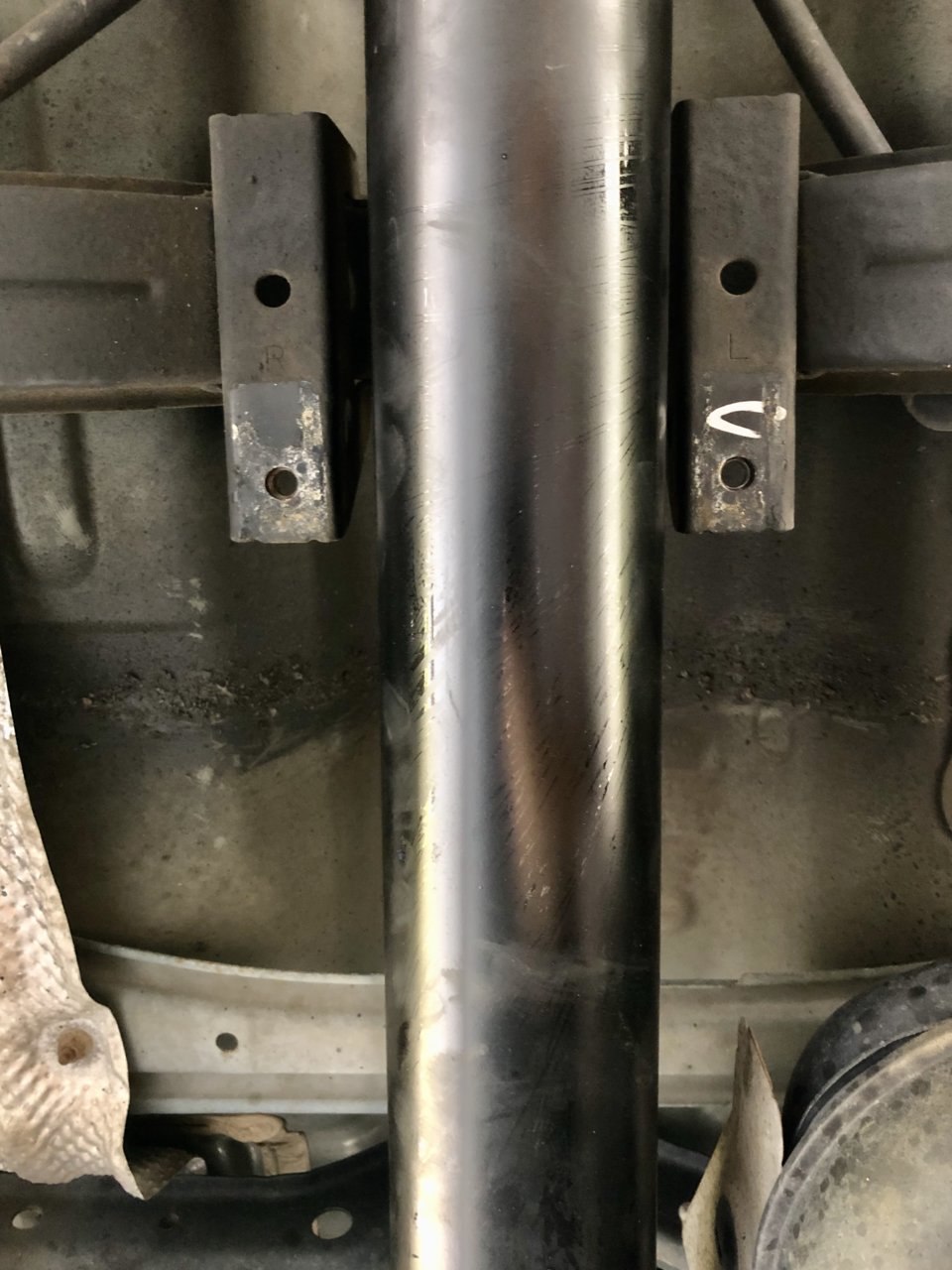

    Took me a while, but heres a few pictures of the 1pc installed. Like I mentioned earlier, for some reason I have less room on the driver side than passenger side between the old CB mounting brackets and the driveshaft. I'm not worried about it hitting. Just something I picked up on in case others are that way too.

    That is bitchen. Let us know if it ever hits the CB mount. I may cut mine out. Thanks for the pics.

    Mine is pretty much in the center, not closer to either side. A tip on installing these long driveshafts... Use ratchet straps across the frame to roughly hold it in place, then all you have to do is guide it in place and bolt it up :)

    My 3.5" TW is centered in that old center support so as stated look at the trans mount as maybe causing the misalignment.

    I also think I know why I have more room on the one side. I measured rear lift, and my driver side is 1/2" lower between rear axle and frame. Once I get that back to even, I think it should even things out by the CSB mount.
