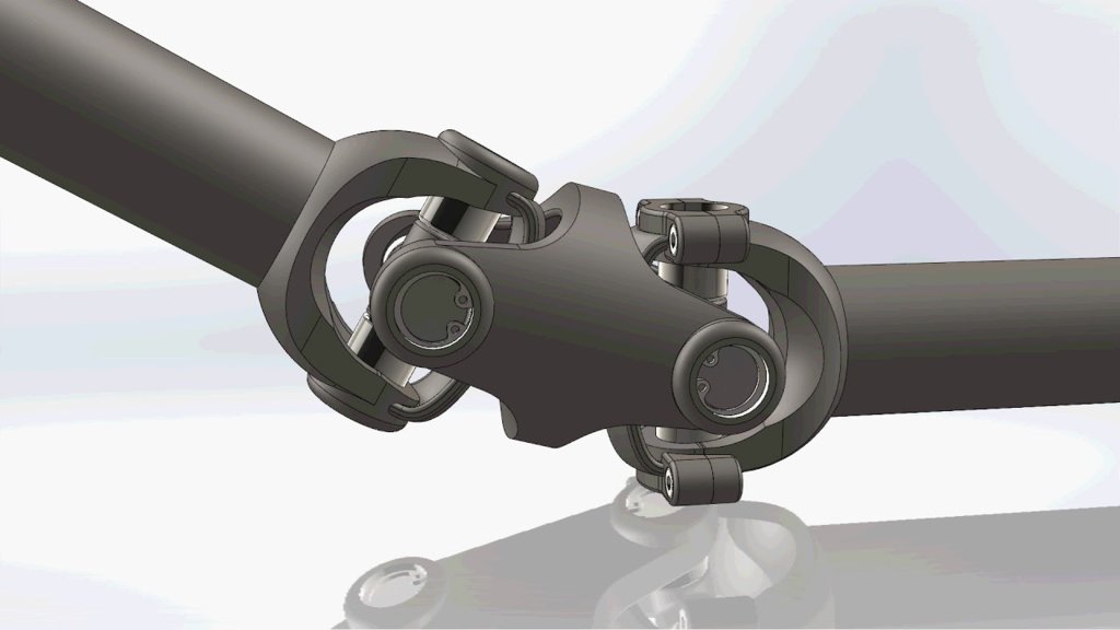

    In my past wrenching years I've done considerable ujoint and driveshaft work/repair. Its got me thinking about a past repair of a heavy duty double u-joint (on each end) single shaft. The purpose was to lessen the tight angle bind by splitting the difference. For the life of me I cant recall the vehicle application. This would be a great one piece replacement 4x4 option.
    Update google search
    Double Cardan u-joint
