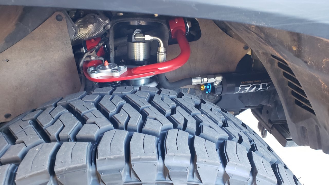

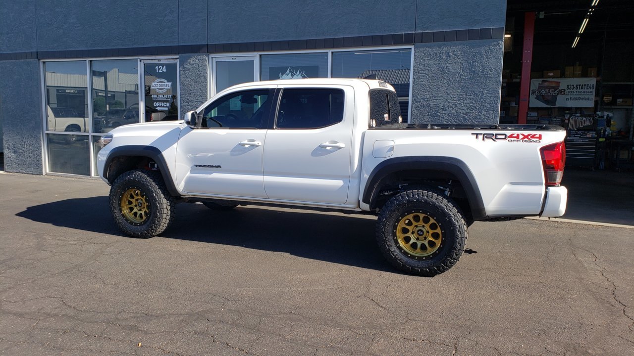

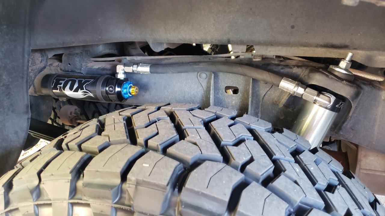

    Initial stage of full build is suspension and wheel/tire upgrade
    Fox 2.5 DSC 14 inch 600lb front springs
    JBA UCA
    Fox 2.5 DSC rear with
    Icon RXT leaf pack set at option 2
    Pakrax bed stiffeners.

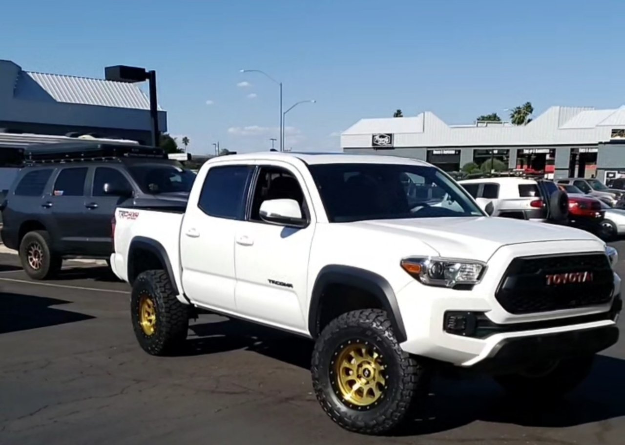

    @SCSPerformance Ray 10 brushed gold
    Toyo Open Country RT Trail
    275/70-17 with full size spares mounted to old trd pro wheel. Mounted by @Discount Tire

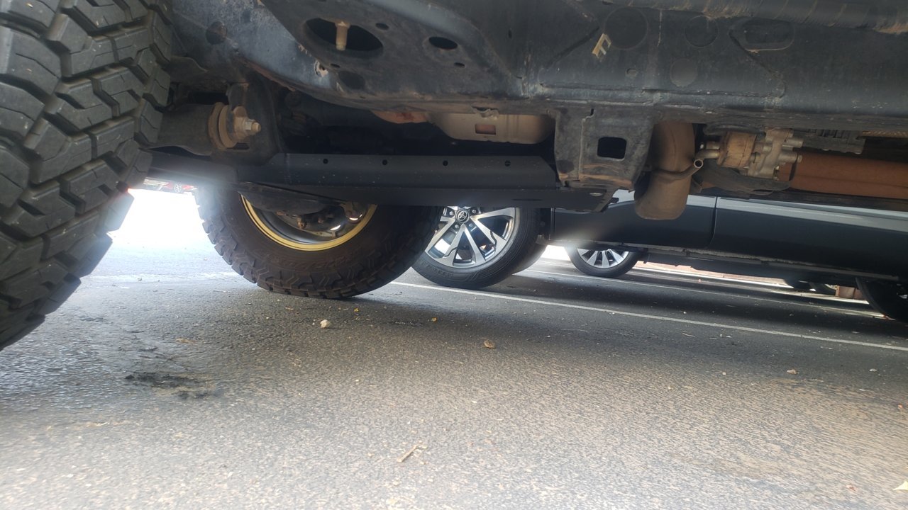

    Durobumps front and rear bump stops
    ARB single compressor
    Expedition Essentials air comp bed mount
    RCI trans skid
    RCI Sliders 20 degree with top plates
    ARK splash guards
    Diff breather mod
    Front sway bar removed

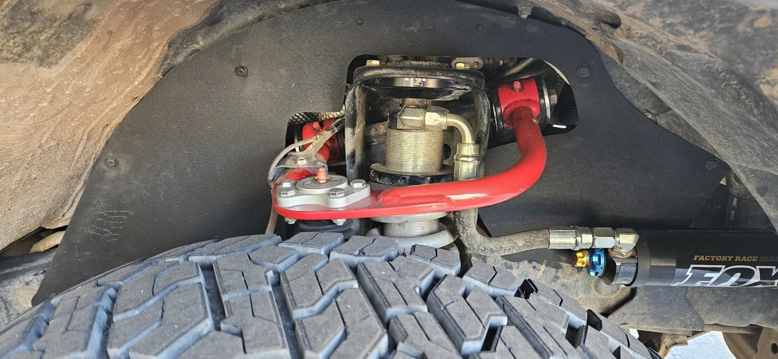

    Front before/after comparison
    Sitting at 23 7/8 inches fender to center hub front and 25 inches rear now up from 21/22
    Parts from @state48overland with work done by AZ Toy Pros

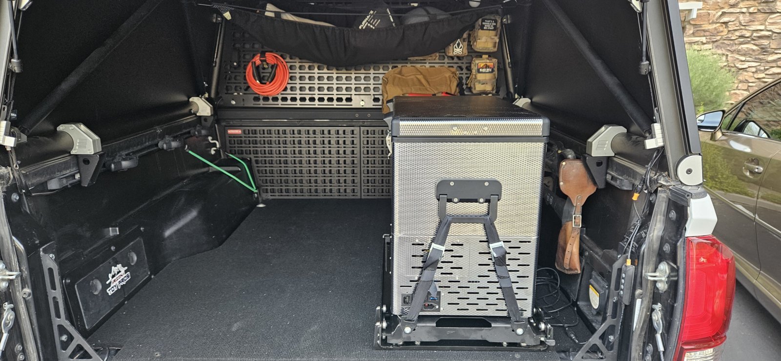

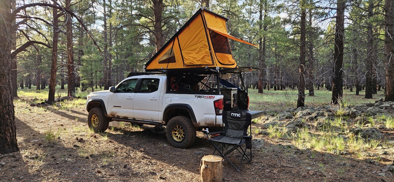

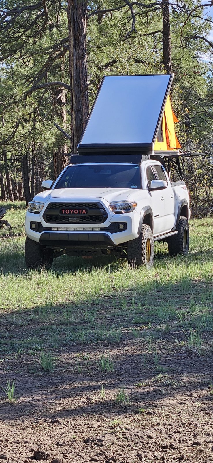

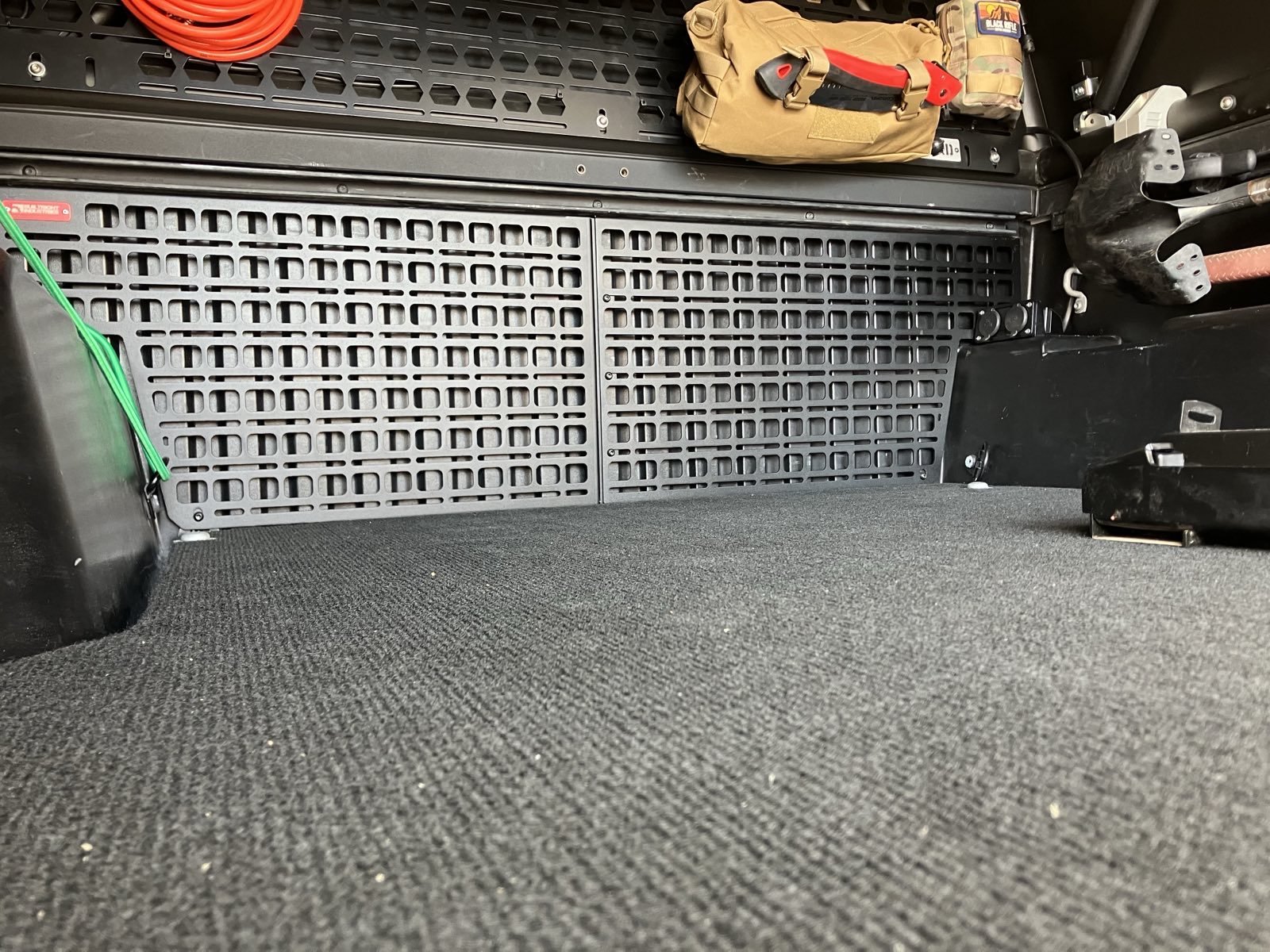

    Go Fast Camper install and build

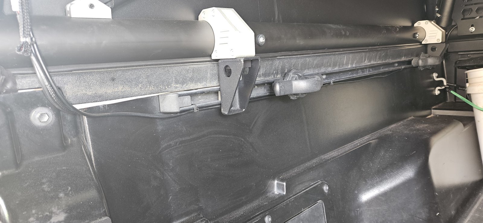

    So made it up to Montana and had the GFC installed. Started on some mods @TailHook gets an the credit and thanks for handling the chase light and rear view camera electrical work. The install is super clean
    Chase lights are @Baja Designs s2 wide cornering
    I've added the following
    Lock covers
    Shittco tent awning kit
    Interior pull down handle for closing rear panel from inside
    JE designs tent pull down strap
    Bubble levels on exterior extrusion
    Vrnclr bedding catch
    Front wall molle panel
    Hardkorr led lighting
    Ecoflow delta 2 to power interior lights and upcoming fridge/freezer
    20240418_170532.jpg 20240421_200236.jpg 20240421_124815.jpg 20240420_115248.jpg

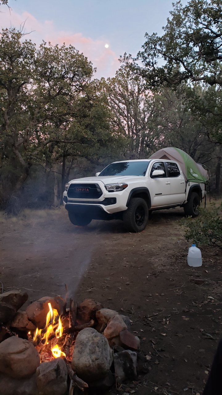

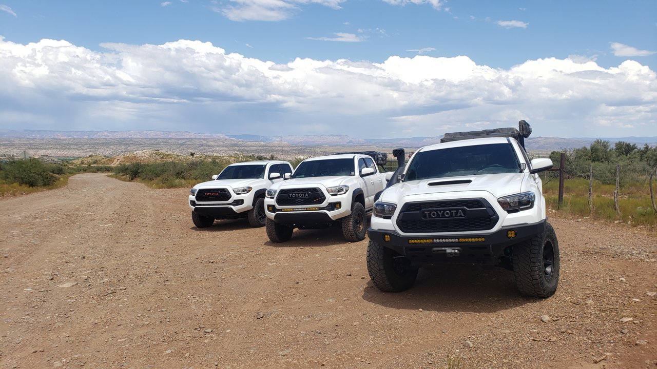

    Some hiking camping and wheeling pics

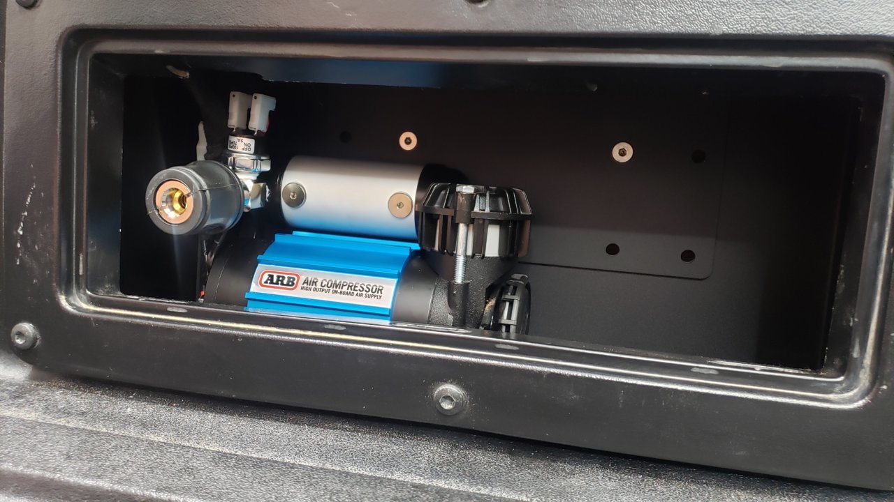

    On board air done thanks for the help @TailHook
    Added the @CaliRaisedLed 3 switch panel in the driver side dash cubby for the switch. 20230722_100308.jpg
    RCI trans skid installed

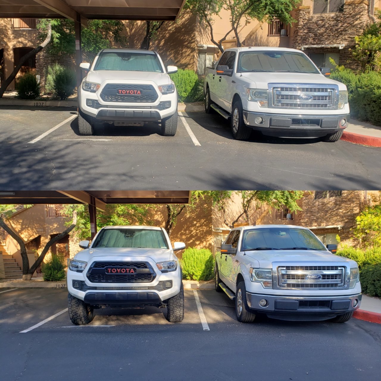

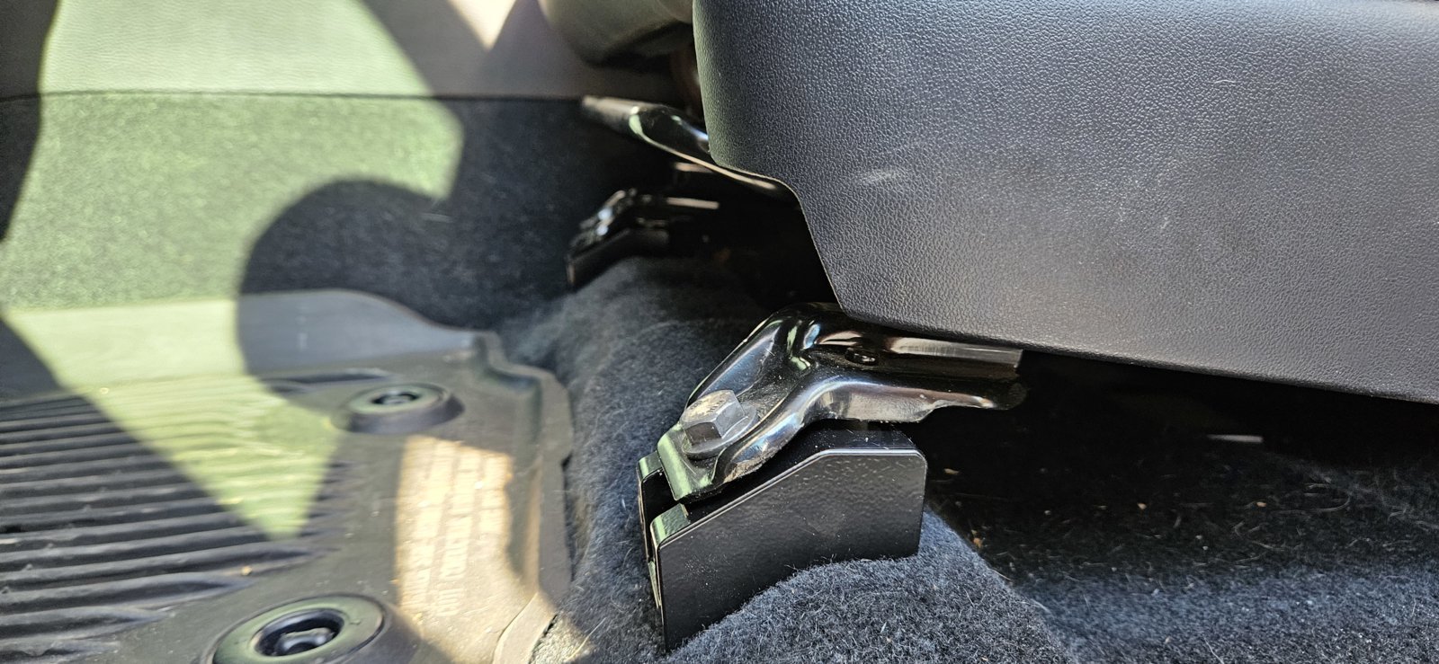

    Seat Jackers installed. Definitely improved seating position most notably upper leg support. My hamstrings can actually rest on the seat now. Still lacks headroom to the point I am thinking of going to a good upholstery shop to have the seat cushion redone. Definitely a future project not urgent

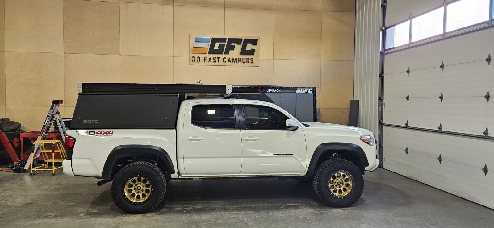

    The bigger news GFC has been ordered. Build 5912 wife and I had planned a 2 week road trip in Aug so scheduled my install to coincide with the run from Yellowstone to Glacier. Mid day stop in Belgrade to get the install doneScreenshot_20231226_215201_Yahoo Mail.jpg
    Few planned changes before the trip
    Order sliders swap out front springs to set of 14 inch springs I got. Swap in stage 2 of the RXT leaf pack to support the camper weight.
    azshooter40, Bikinaz and saidyoudid like this.
  12. Apr 23, 2024 at 10:01 AM
    OnePuttBlunder
    OnePuttBlunder [OP] Well-Known Member
    Aug 14, 2018
    #262794
    3,793
    AZ
    2018 TRD Offroad DCSB Premium +GFC

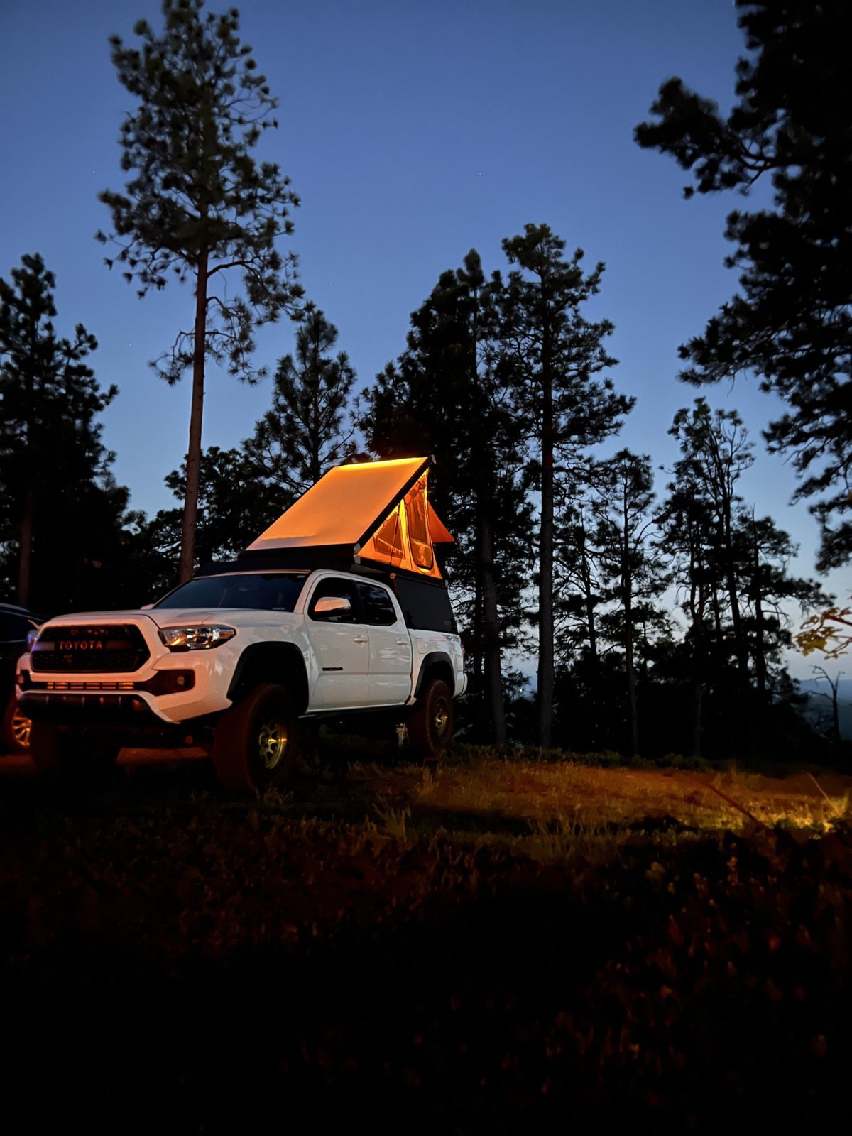

    GFC install done last week and fell in love with MT. Can't wait to go back this summer

    Your chase light install looks clean! Just curious once you drilled into the GFC for the wiring where did you run it to? I was planning on mounting some S2s for chase lights as well and just not sure what I want to do with routing the wires quite yet, but need to get into the engine bay to finish the wiring on my switch pros.
  14. May 20, 2024 at 10:58 AM
    OnePuttBlunder
    Aug 14, 2018
    #262794
    3,793
    AZ
    So it's a split the chase lights we ran the wire through following the 3rd brake light routing and tapped into the trailer harness for power. Then ran ignition relay to the switch in the cab.
    The camera we ran the cable under the driver side T rail through the opening in the front bed corner down to the frame ultimately into the engine bay. This would have also worked for the chase light power run
    All credit to @TailHook for the electrical though cause I'm and idiot when it comes to that stuff.

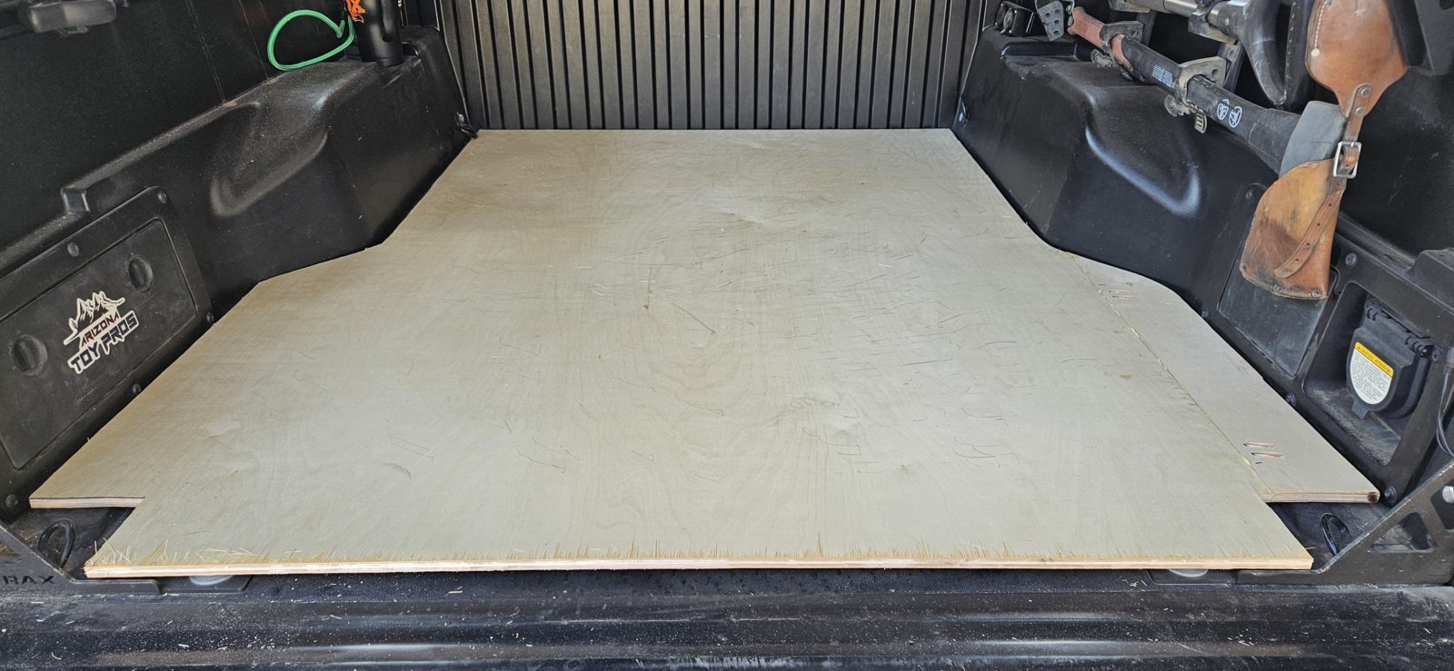

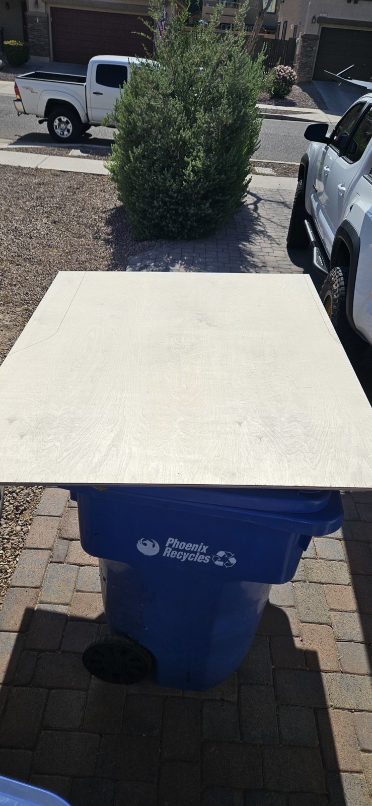

    Bed platform build. Traded a buddy my old oem bed mat for help and tool access.
    Started with a 4x8 sheet of 1/2 inch birch plywood. Used the bed mat as a template for the initial cut. Since the the rear is 52 inches wide used the fender cut out and jigged it together to fill in the 52 inch width. Covered it with marine grade carpet. Mounted the fridge slide up and secured it to the bed using the factory bed bolts. Will add that with bed stiffeners on the tailgate bed bolts are not long enough to engage threads even with the plywood counter sunk. Had to source some 130 mm replacement bolts.
    Can't believe Goose Gear charges $800 for their bed base. This was just about $100 in materials
