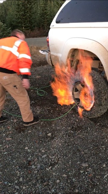

    Lynnwood, WA
    We got to see that shit up close. It was freaking hilarious.
    6 gearT444E[QUOTED] likes this.

    lmao, you’re supposed to put the fire out before the marshmallow gets too toasty.
