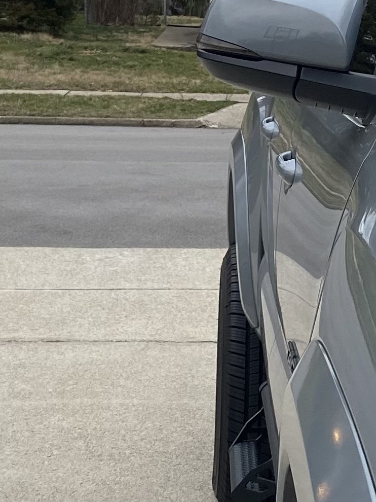

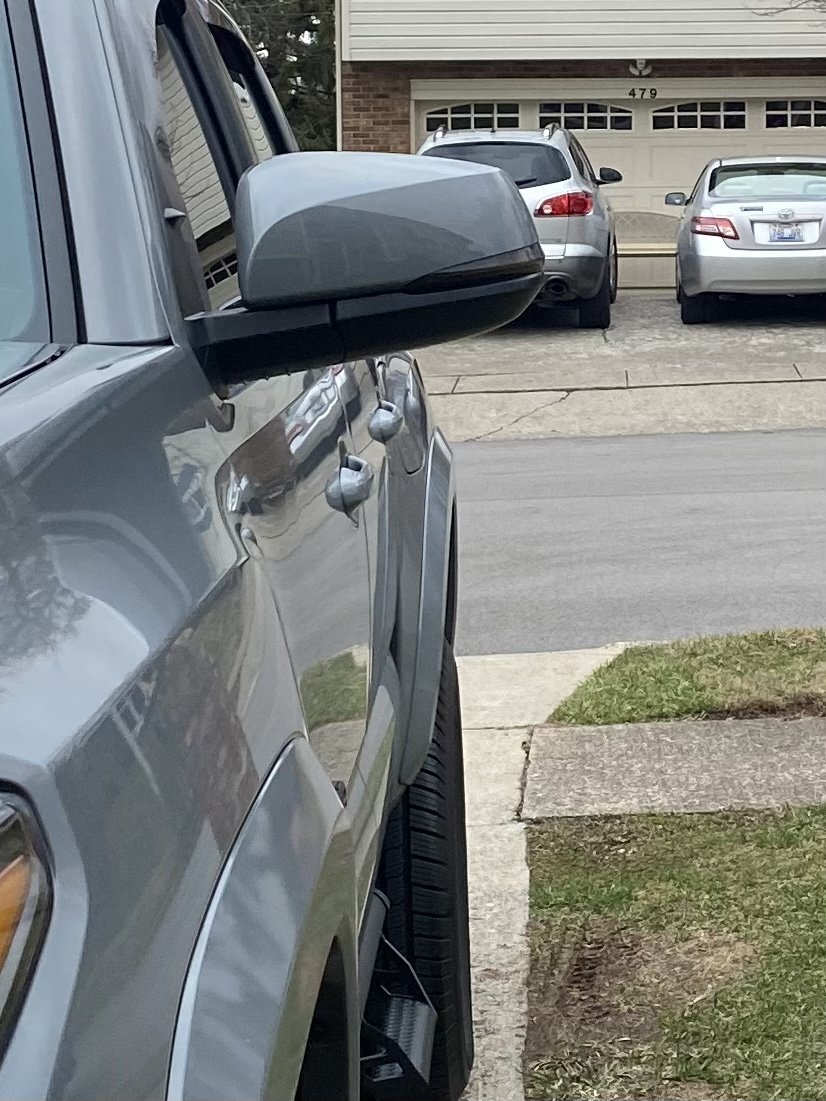

    Hi all this is Kris here, 2021 TRD sports 3” lifted with rough country vertex coil over. I wonder why in rear Axle Passenger Side wheel is slightly outside then driver side, I can see approximately 3-5mm poking on right rear wheel. Can anyone advise me how to bring it in and make even with the other one? Thanks

    Yeah Toyota won’t do anything since it is modified. Bed looks straight too. I have attached two pictures of both wheels and see the difference. Thank you guys for your thoughts and advice.

    One other thing I was noticing that the gaps between tires and mud flaps are not equal in the rear axle. I did measure one day and found 1/2 inch difference, I guess where that tire sticking out space between tire and mud flap was 3” and 3.5” to other. I installed my lift kit a year ago and when I was running running with stock wheels I couldn’t notice and didn’t pay attention cause they sits inside the fender but when I switched to 4Runner TRD pro wheels then I noticed cause you all know these wheels has some offset and looks awesome. I recently asked a guy who installed the lift kit he said oh yeah it’s gonna come little bit out one side. Should I go and let them realign the block installation if the problem is still there after checking bed alignment? But I want fix myself cause every time someone will do the job in my truck they will make another mess not having well skilled people here in Lexington KY. Thank you all.
