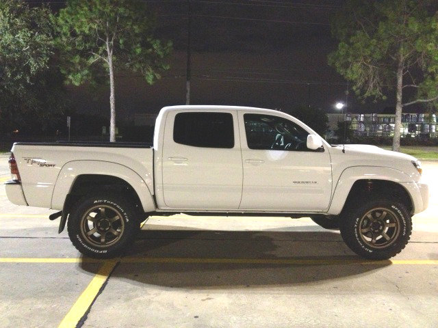

    Toytech Adjustable front coilover kit - $800
    Wheeler HD 3 leaf progressive AALs + hardware - $159
    Bilstein 5100 rear shocks - $145
    LR UCA - $410
    Installed myself
    total = $1514

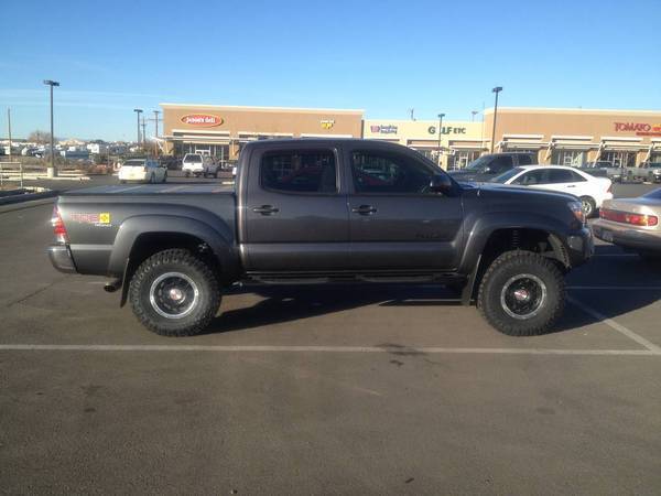

    Toytec Bilstein Adjustable lift kit with 5100 shocks, add a leaf, Eibachs and top plate spacers $640 with shipping (black Friday Sale)
    Big O assemble struts $20
    Carne Adovada Breakfast Burritos for me and my friend $10:rolleyes:
    285 75 16 Duratrack from Discount Tire $877 (price includes $200 credit for trade in of Rugged Fails)
    Alignment $160
    Shit Eating Grin. Priceless:D
    Total $1707

    What are the front Bilsteins set at? From the picture, it looks like the front is sitting higher than the rear. I am looking at that same kit, and I don't want my front end to sit high.

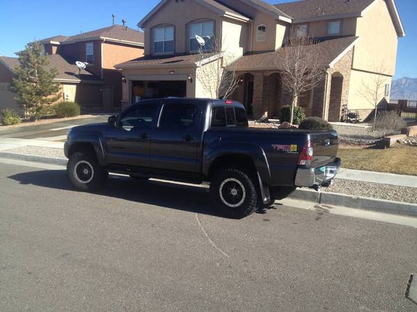

    That pic was the day of lift. One little problem...Big O put my spring seats upside down. Made the front about 1.5 inchs higher then it should be. Corrected it and heres how she sits now.

    OK, that looks alot better. What size tires are you running on there?

    285.75.16

    Any rubbing issues with those? I'm looking at getting a very similar kit myself.

    Minor rubbing when I wheel. No rubbing on the street. Had to take off front mud flaps.
