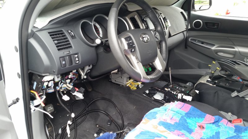

    Had my dash apart 2x, but I have my fuse box up and running!

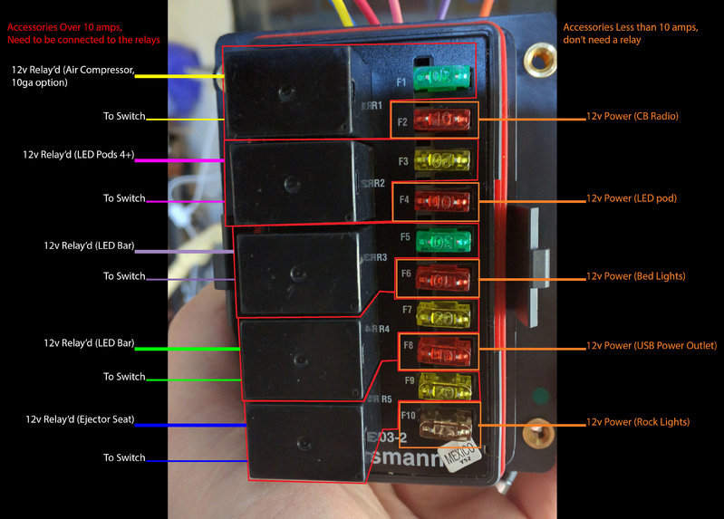

    are these switched power or switched ground?

    If you're referring to the relays, they are connected as shown. The main power and ground into the box can be setup anyway you want, but typically straight to the battery.

    yep, was talking about the relays. So fuse to 30, aka switched power. Thanks for the info

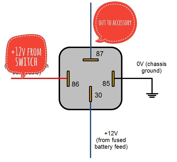

    Hm... what's your timeline on these (aka how long is the expo?). I was going to order all the stuff to put one of these together but it'll be 100x easier to just buy it premade. Let me know below is what I'm looking for:
    Standard setup with the 80Amp breaker - I can paypal now - just let me know.
    Just a quick question when running the relays to the switch would I run 5-12v power to the switch then take the negative from the switch to the 'switch line' coming off the relay?

    The relays need 12v (10-14v) sent from a switch to the Coil side of the relay. The relay is already pre wired (on my boxes) for ground. All you have to do is hookup:
    12v switch IN to relay
    12v Acc OUT to Accessory
    and
    Battery Pos
    Battery Neg
  11. Oct 5, 2016 at 6:10 AM

    Wired up just like the tutorial that @tacozord wrote, right?
    https://www.tacomaworld.com/threads/diy-build-and-install-a-bussmann-rtmr-fuse-relay-block.399454/
