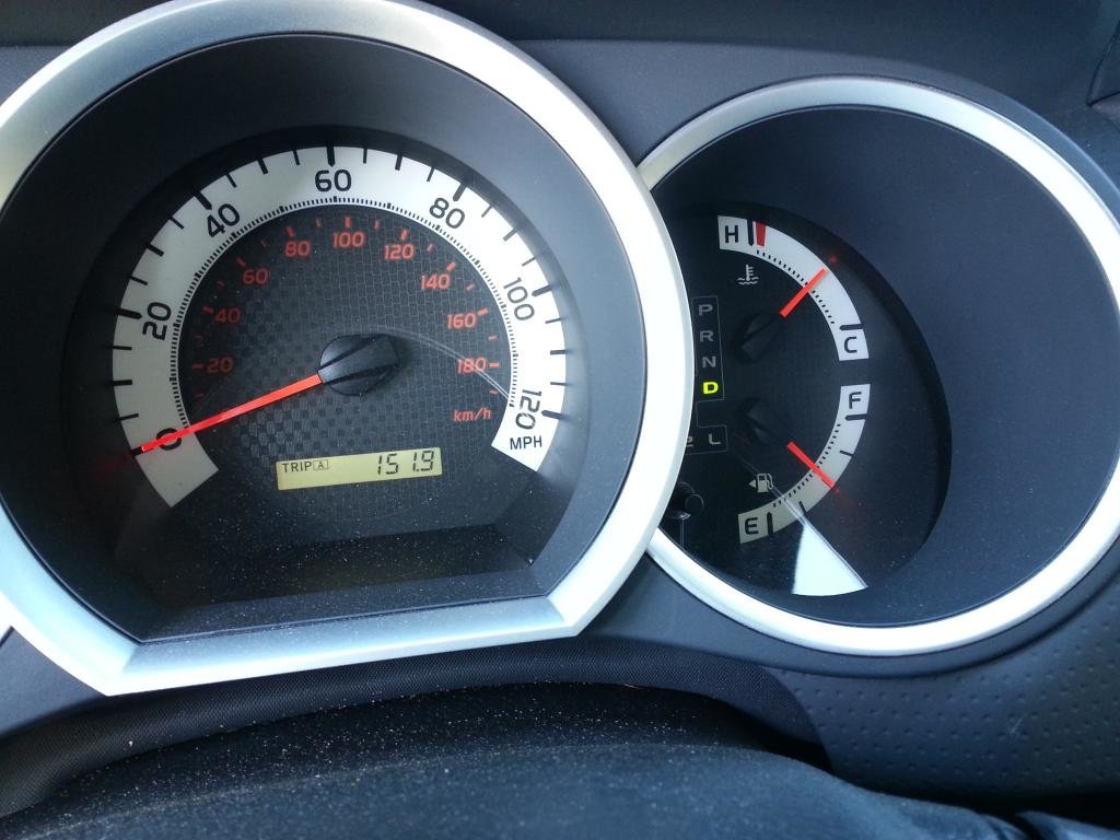

    That seems like a lot. I've noticed that guage 1/2 tank and actual 1/2 tank are pretty far off. Seems the needle moves a lot faster as the fuel level gets lower... Might be just me though

    Why not properly calculate miles per gallon instead of a highly inaccurate miles per tank. Fuel gauges are not highly accurate, are influenced by how the vehicle is sitting, where the float is positioned... So fill'er up, no topping off, when the nozzle shuts off pull it out and hang it up, set the trip meter, fill it up again when needed same deal no topping off, record the number of gallons, fill it up again when needed record the gallons a second time, fill it up a third time add gallons from the second and third fill ups and divide into miles on trip meter. You now have a fairly good estimate of miles per gallon which is the standard metric used to compare fuel economy.

    My goal is to get 75 miles to the 1/4 tank, 150 to the half, and 300 before fillup.
