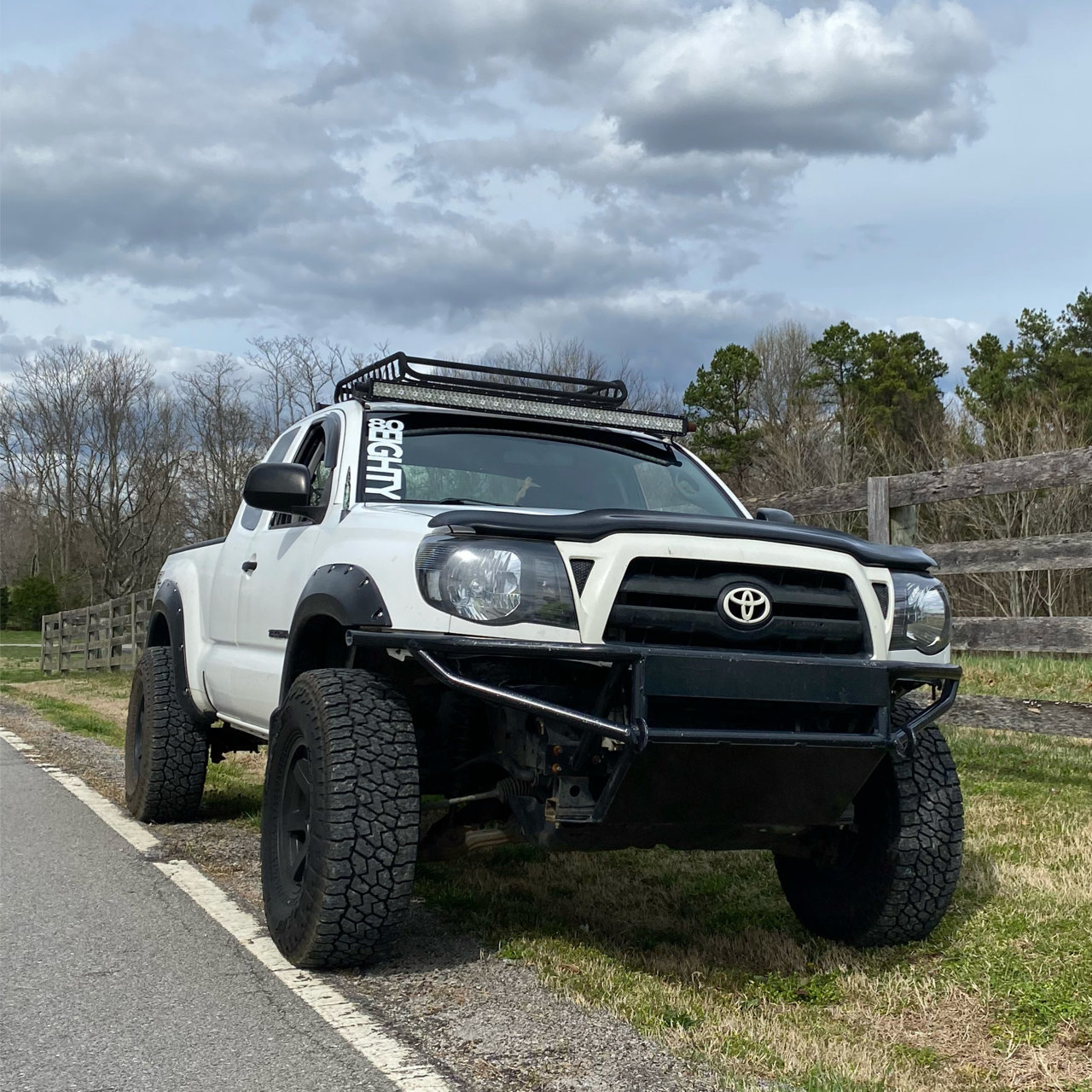

    2007 TRD offroad tacoma
    True duel glass pack no cats Leveling kit Level 8 rims on 33in falcon wild peak‘s Custom pre-runner bumper Custom roof rack mount Locking rear diff Over 350,000 miles
    My Tacoma with the 4.0 is not revving over 3000 rpm it is like it has a limiter
