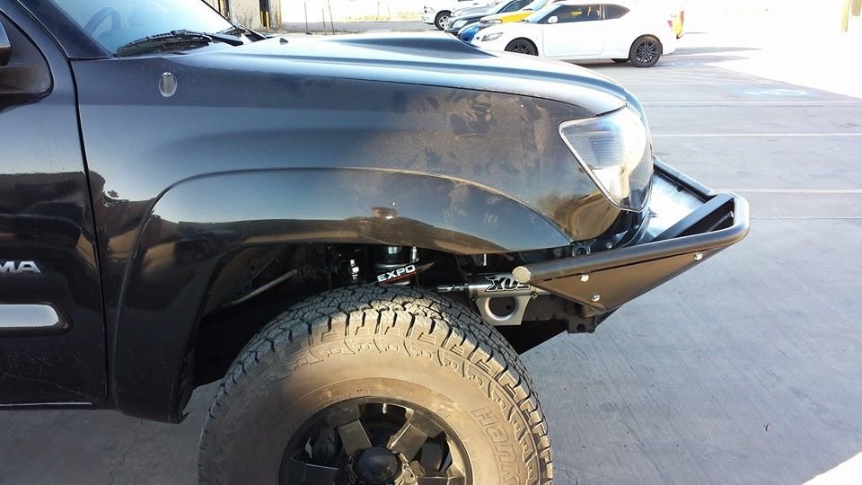

    Custom Front tube bumper skid
    Custom Rear tube bumper

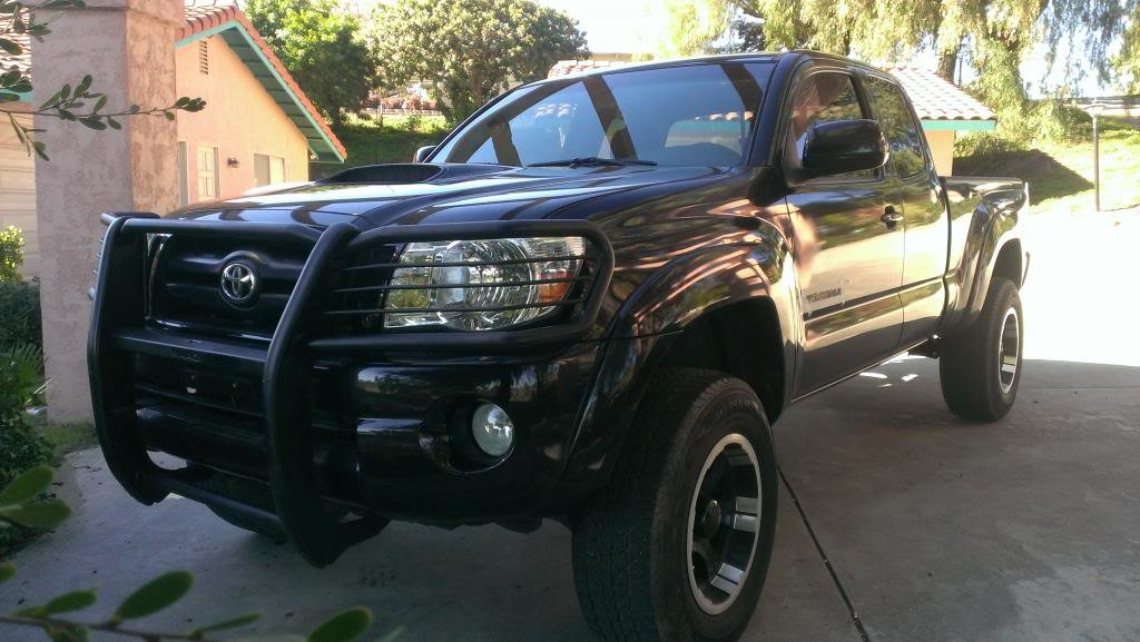

    Here's a pic the night i got here..

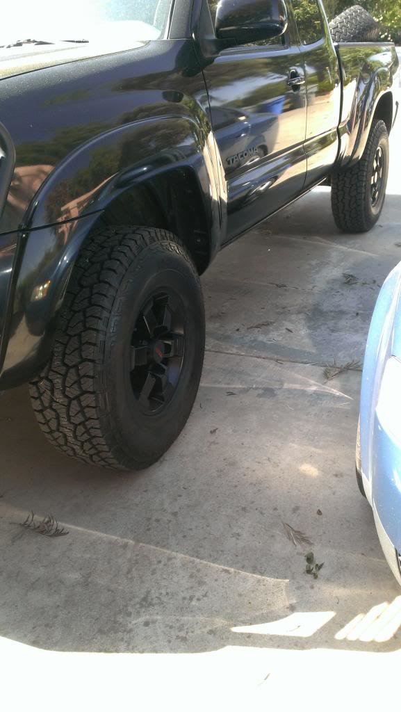

    Got the Black TRD FJ Cruiser Trail Team 16" wheels
    Got some 285s for em

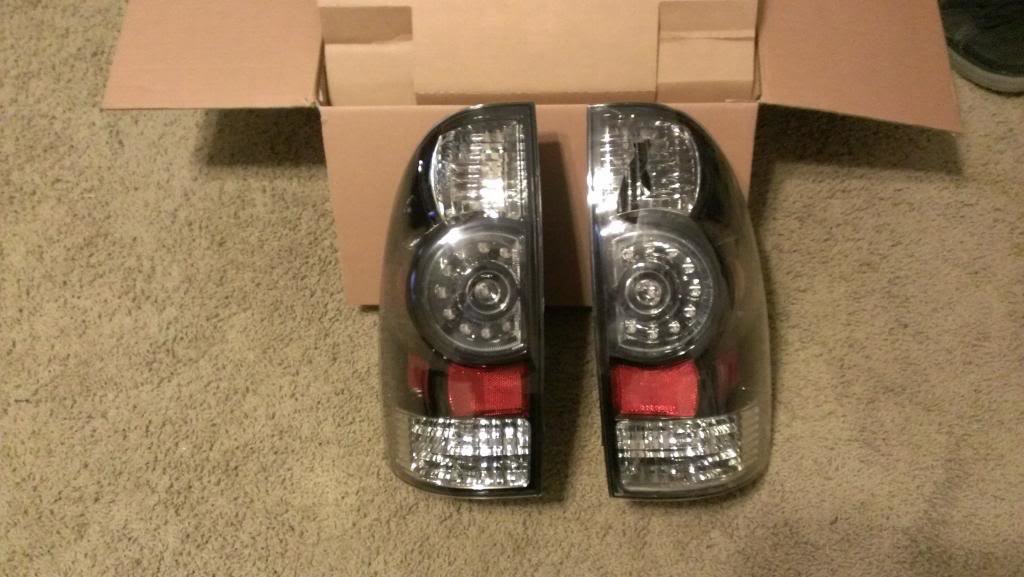

    Got these Black bezel Tails, broke one with the pedal of my bicycle, while it was mounted to the tongue of my trailer

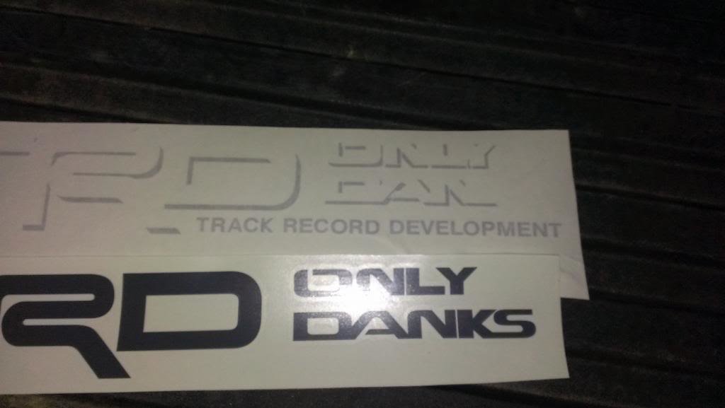

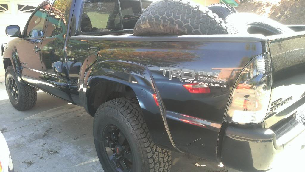

    Oh, and this cool custom decal for the bedside

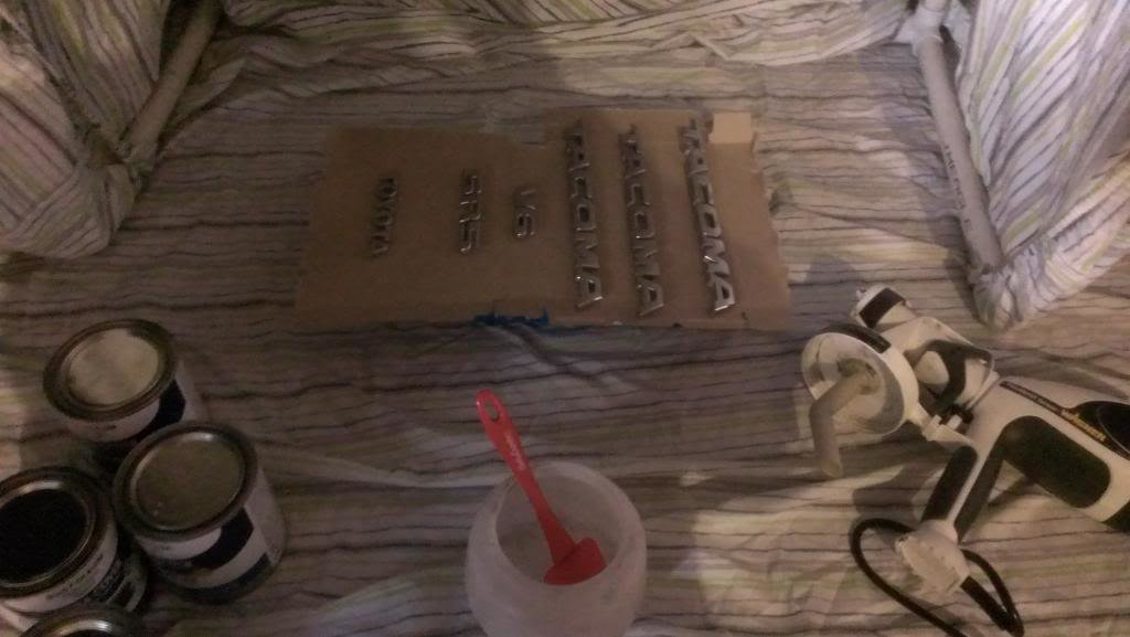

    Painted the emblems

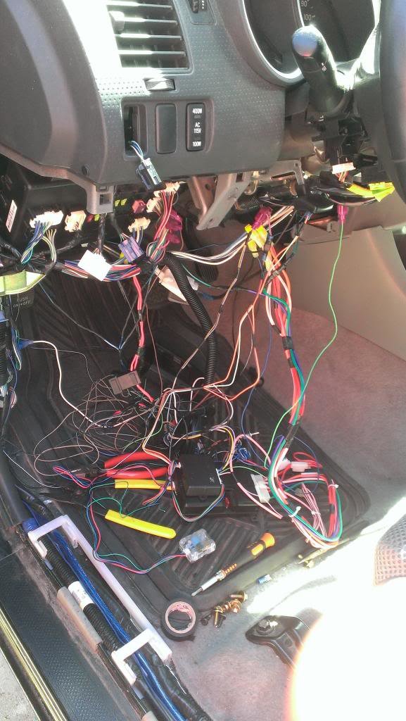

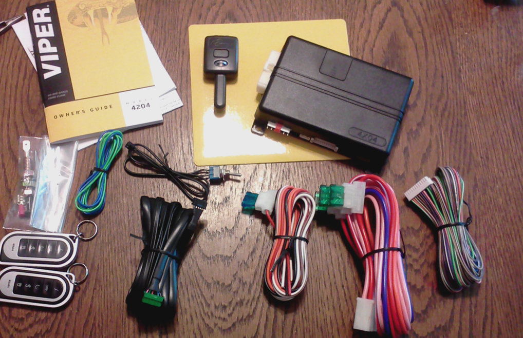

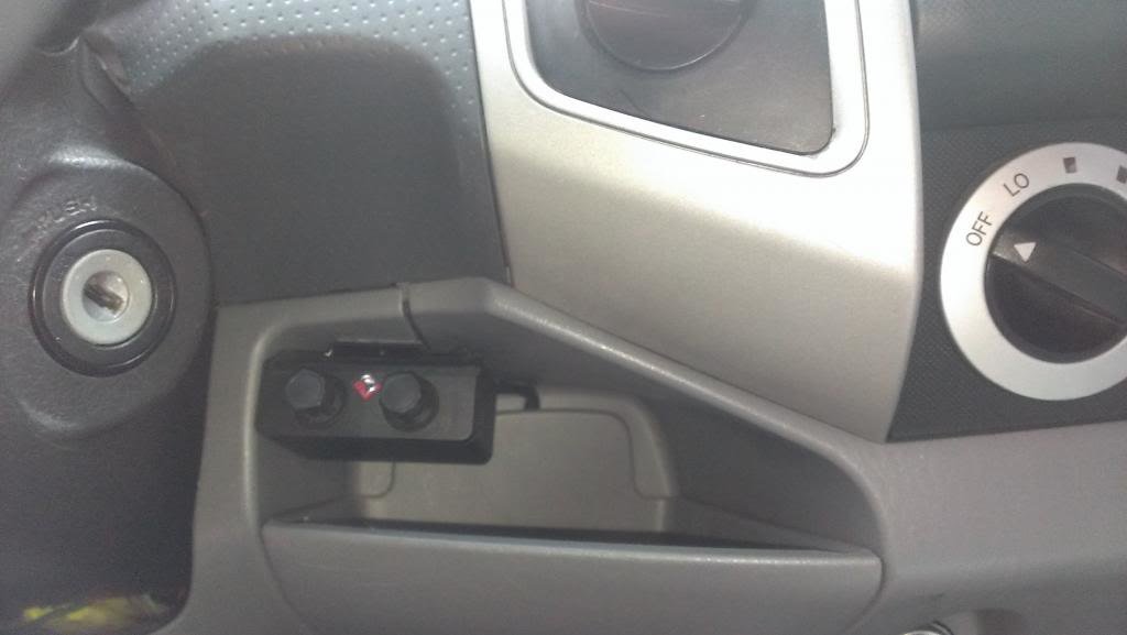

    Viper + Remote Start install

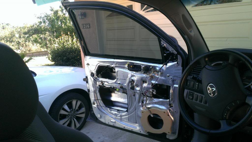

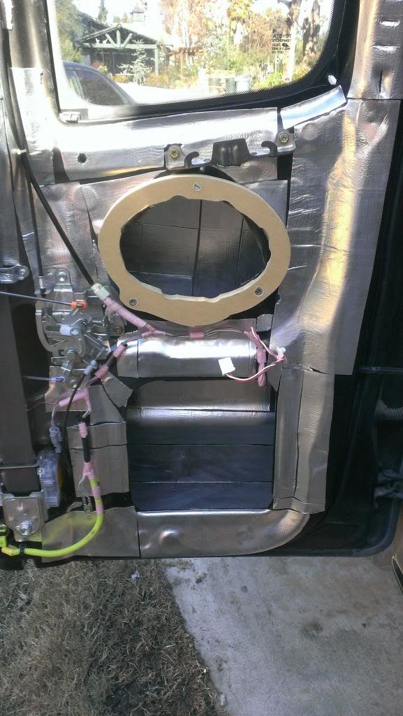

    Custom 6.5 round speaker adapter from 3/4 MDF for up front
    Some slight cutting and my 6x9s are going in the rear

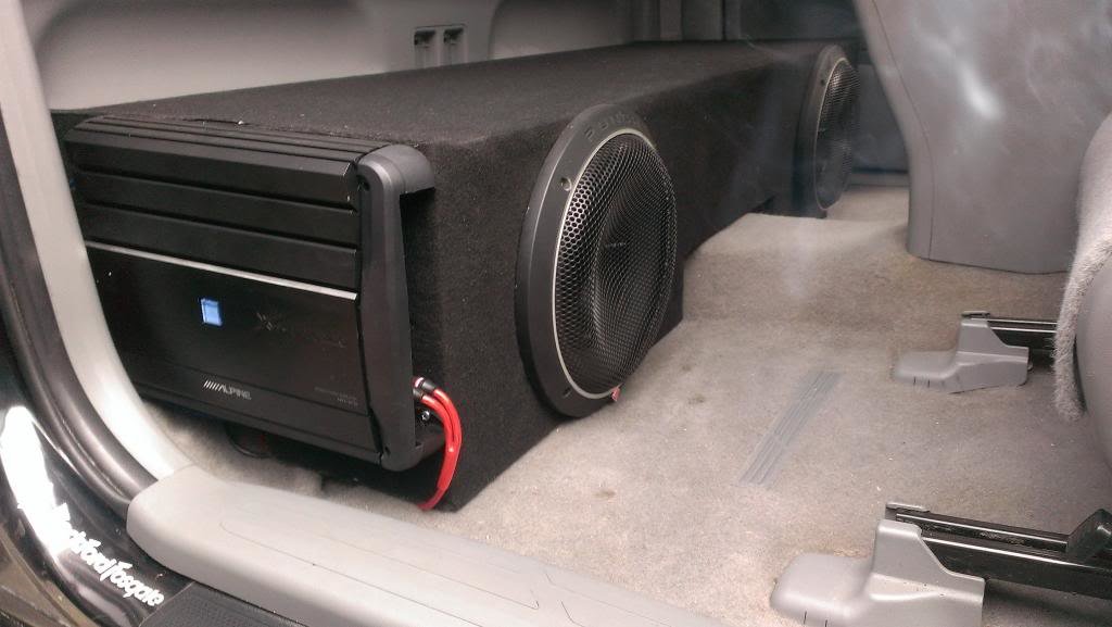

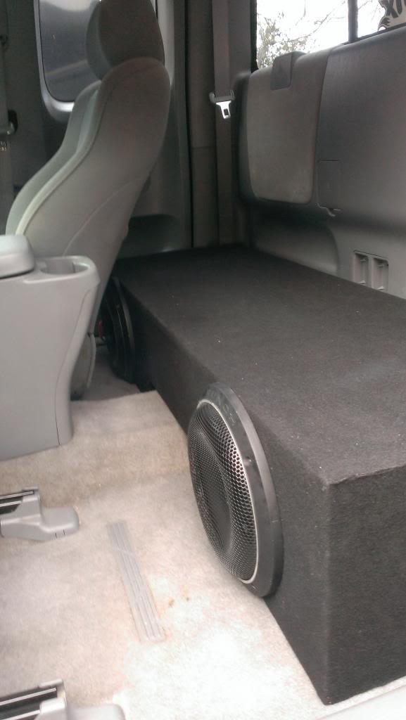

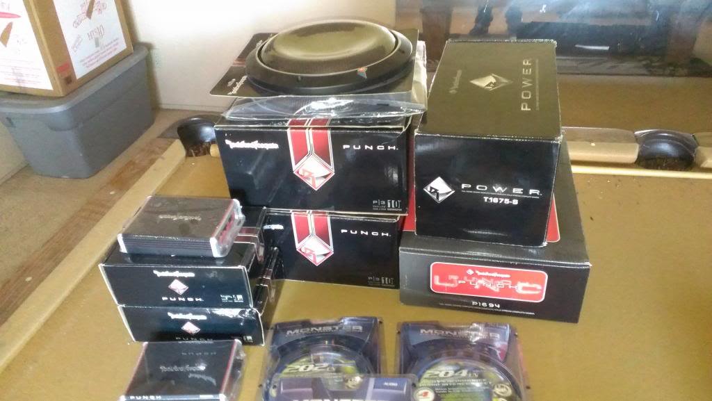

    i originally put 2 SLIM P3 10s , fiberglassed under the throw seats with (2) 300wx1 PBR amps
    But i didnt cut it. So i swapped for full size models P3 10s and an Alpine MRX-M110X

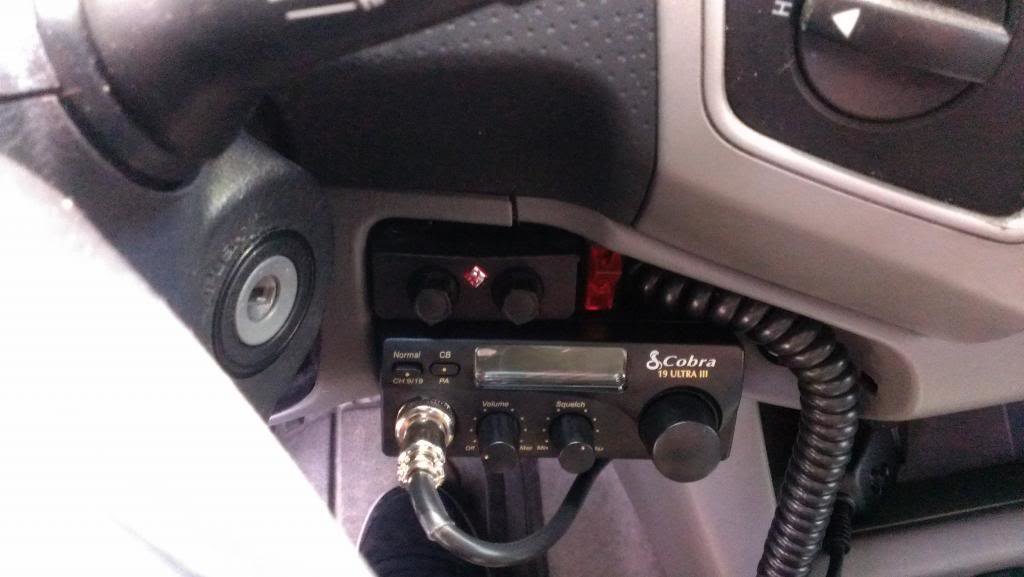

    CB Added
    Custom sub box - throw seats completely removed

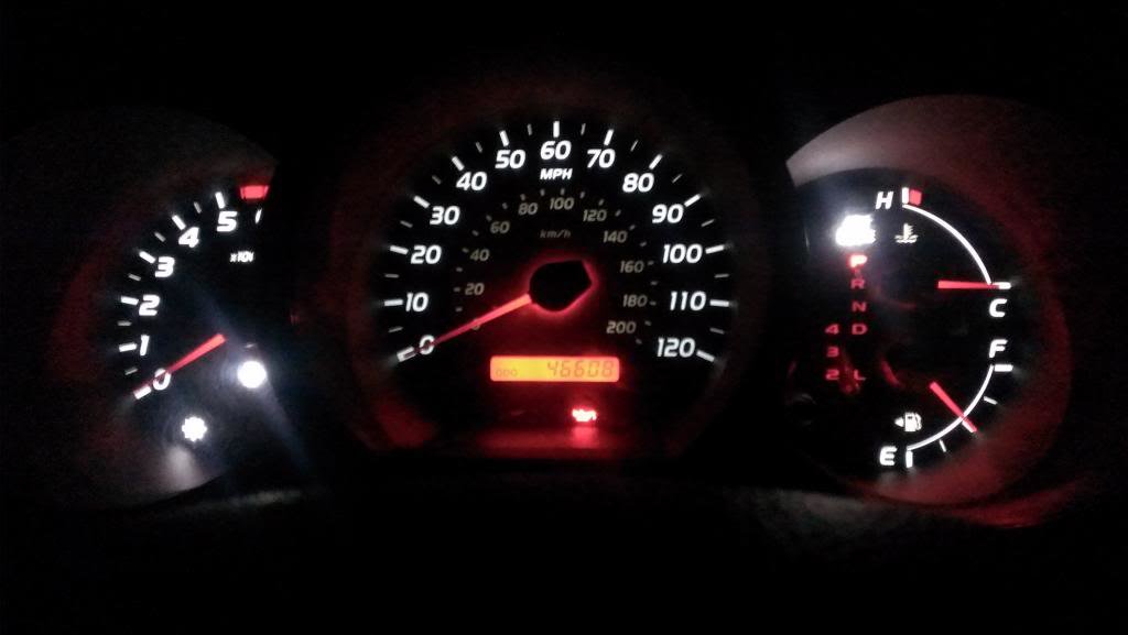

    Did the Cluster LED swap

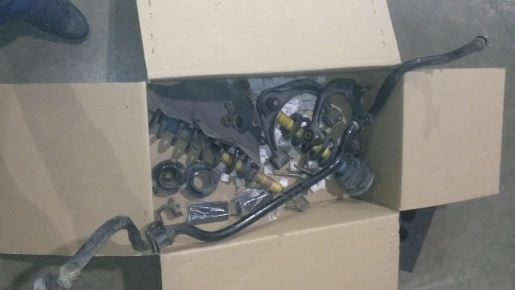

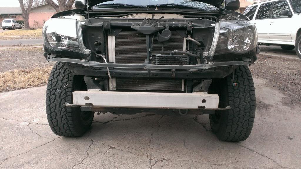

    Time to get to work... Took off Sliders, the brush guard and stock bumper
    These are sweet, but we don't need them.

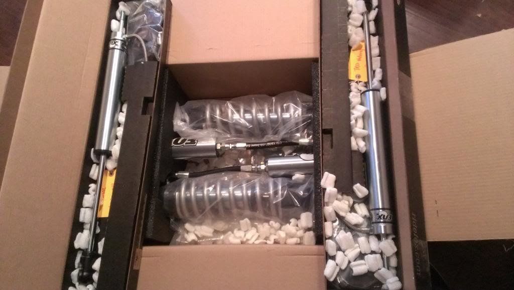

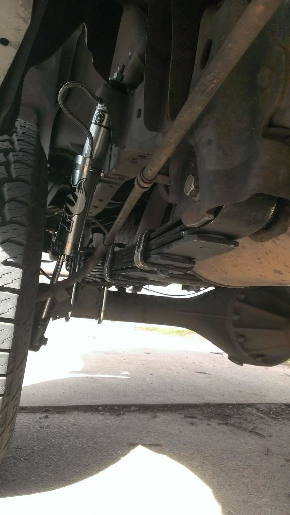

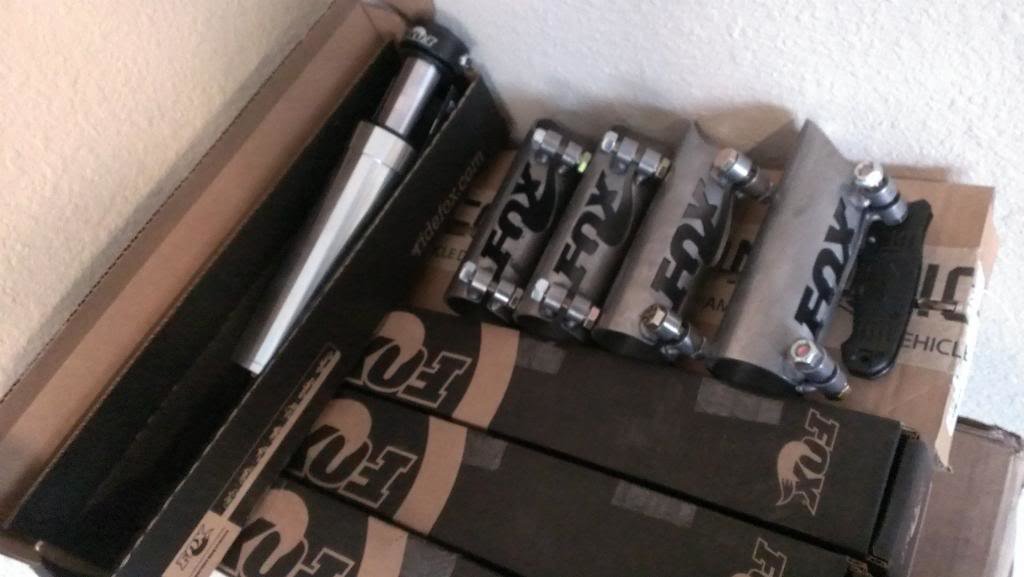

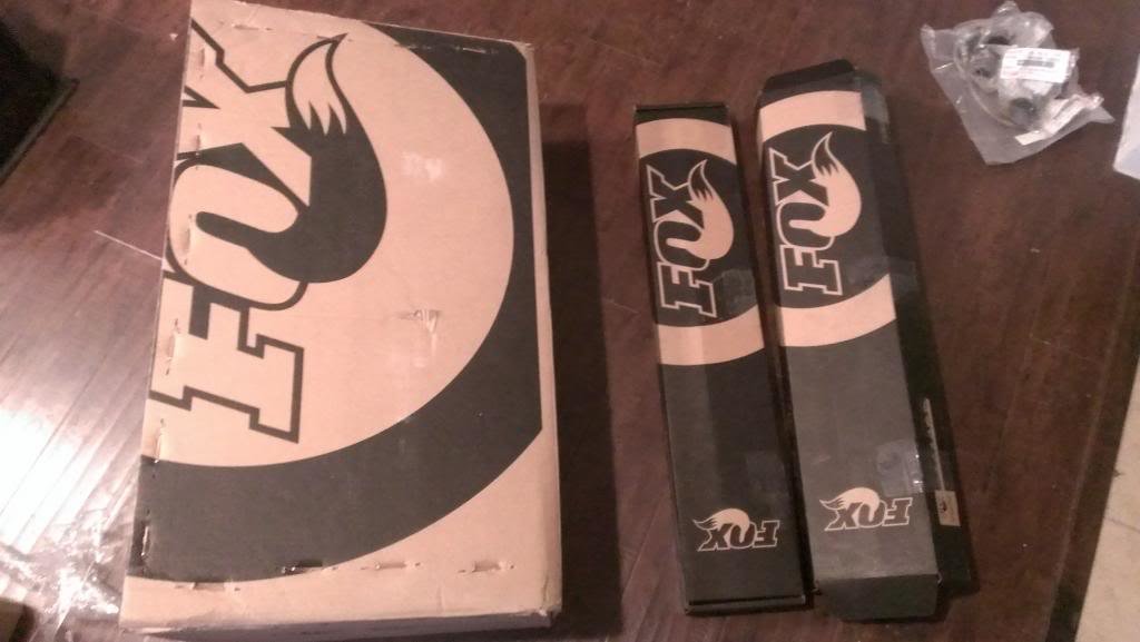

    Fox 2.5 Extended Travel 3" Lift coilovers w/ Rem Res

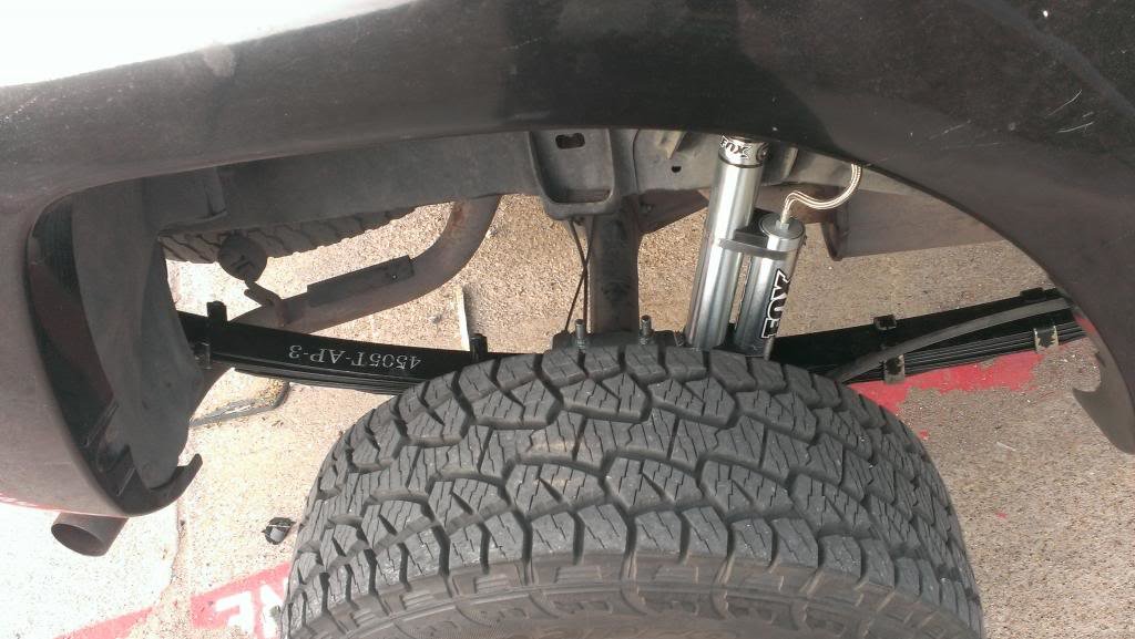

    Fox 2.0 10" Rear shocks w/ Rem Res custom built by Downsouth Motorsports

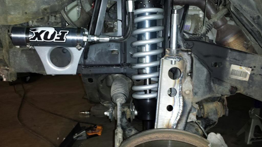

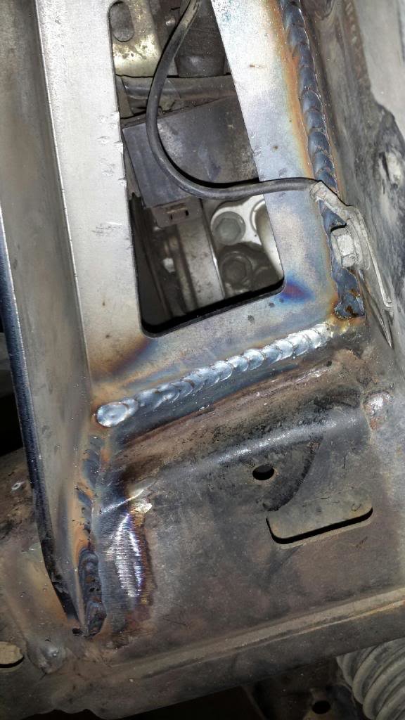

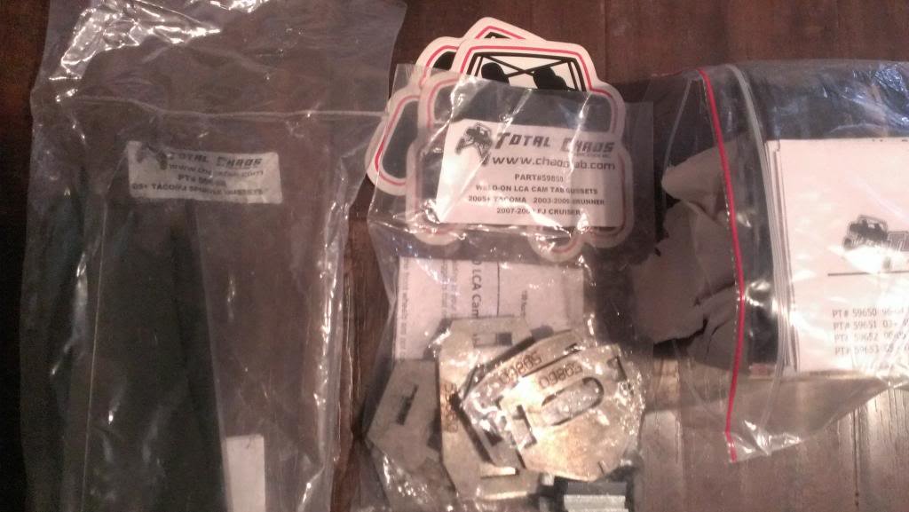

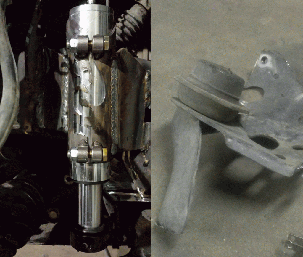

    Just got my TC gusset kits for the Spindle, Cam Tabs, and Coil buckets
    Coil bucket gusset
    Cam Tabs also gusseted

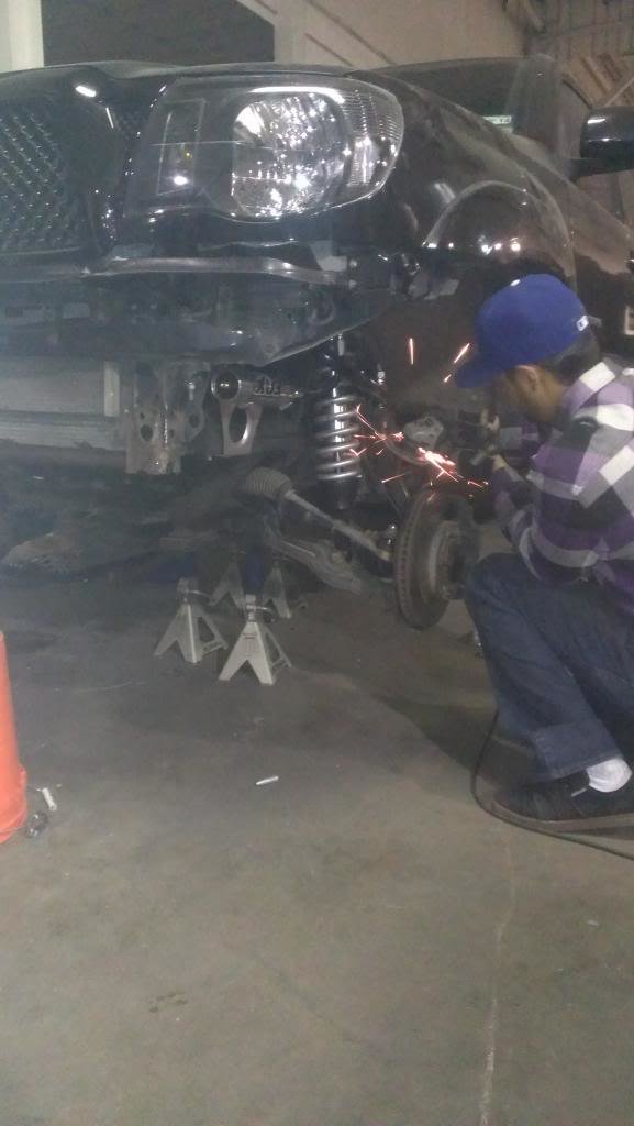

    Fox 2.5x6 RR Coilover, fagtech arms , Spindle gusseted
    Grinding spindle gusset to clear the rim

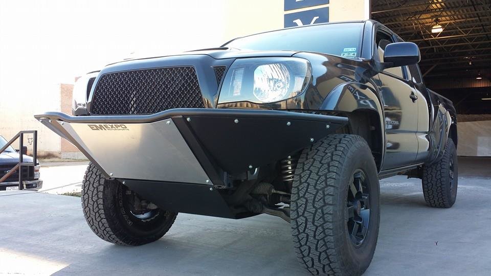

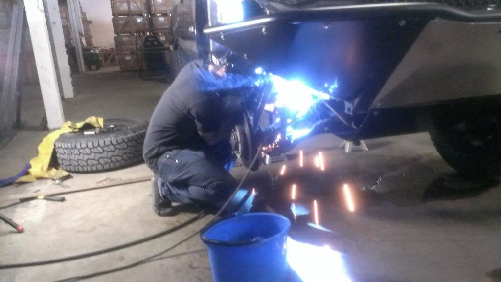

    Bumpers done and front suspension installed

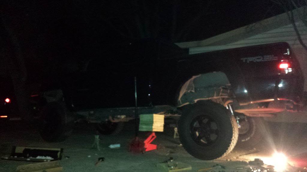

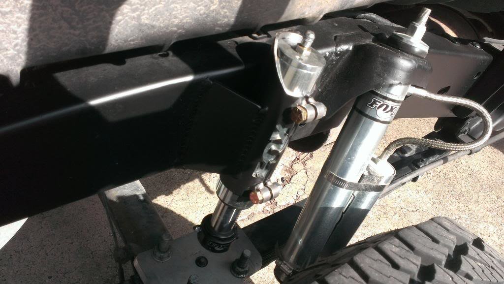

    Time to install the rear. In hind sight this doesnt look too safe :/
    All done

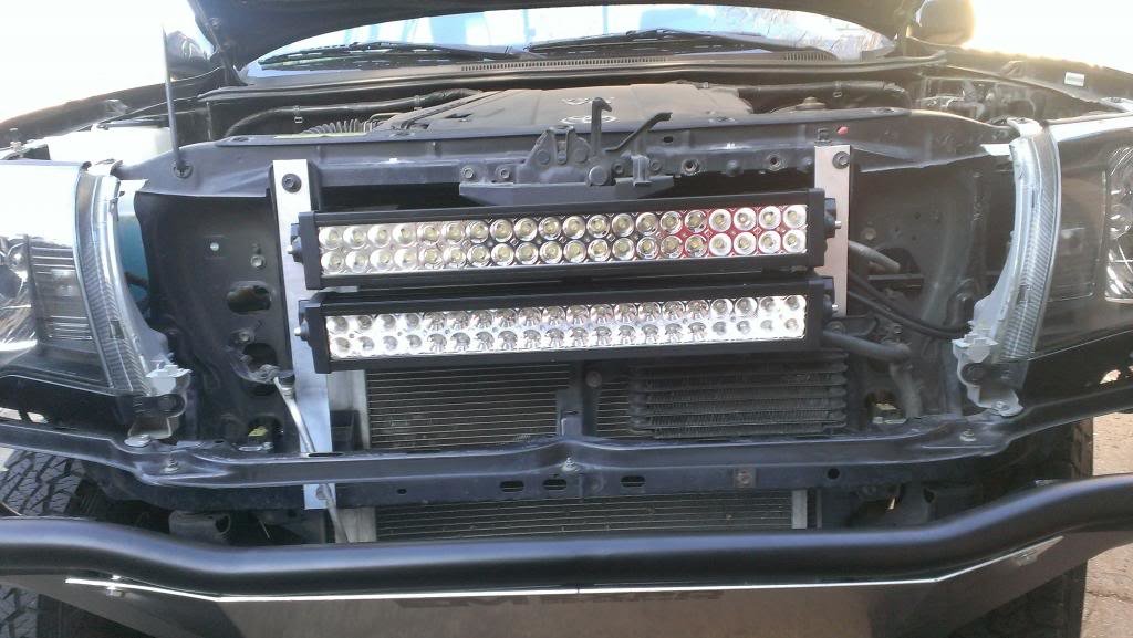

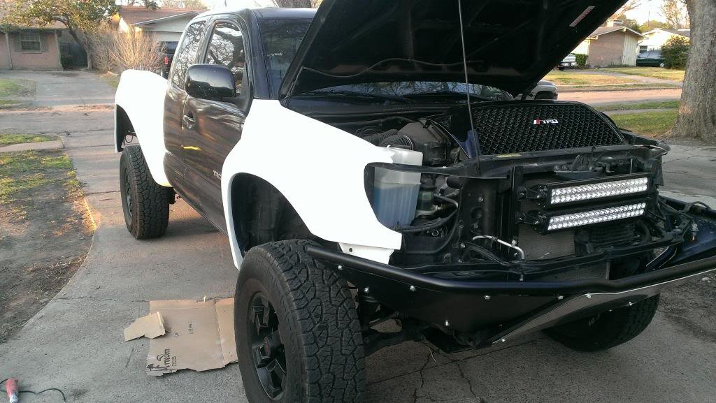

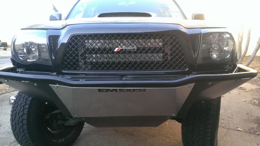

    Just mounted two 24" LED bars behind the grille. 1/8" aluminum from home depot.
    Used the radiator mounts except he bottom left which i just grilled straight through and used a random bolt
    Havnt wired up a relay yet.. will prolly paint the mount black

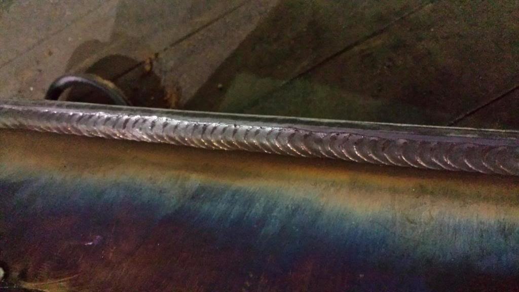

    Front and rear bumpstops welded

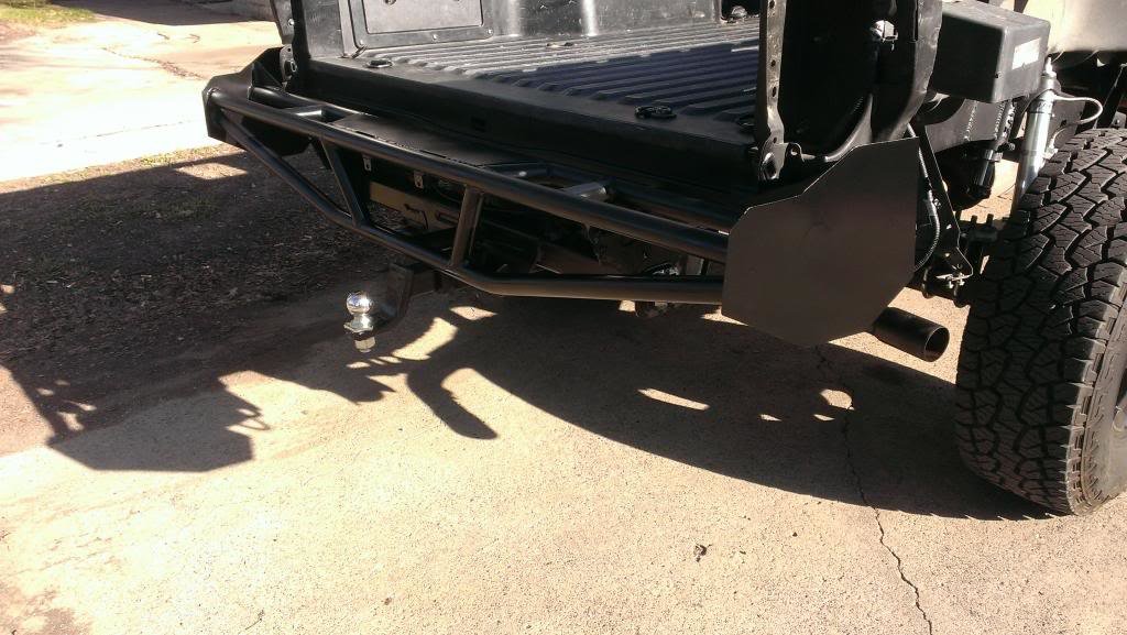

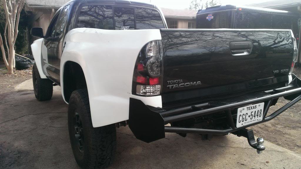

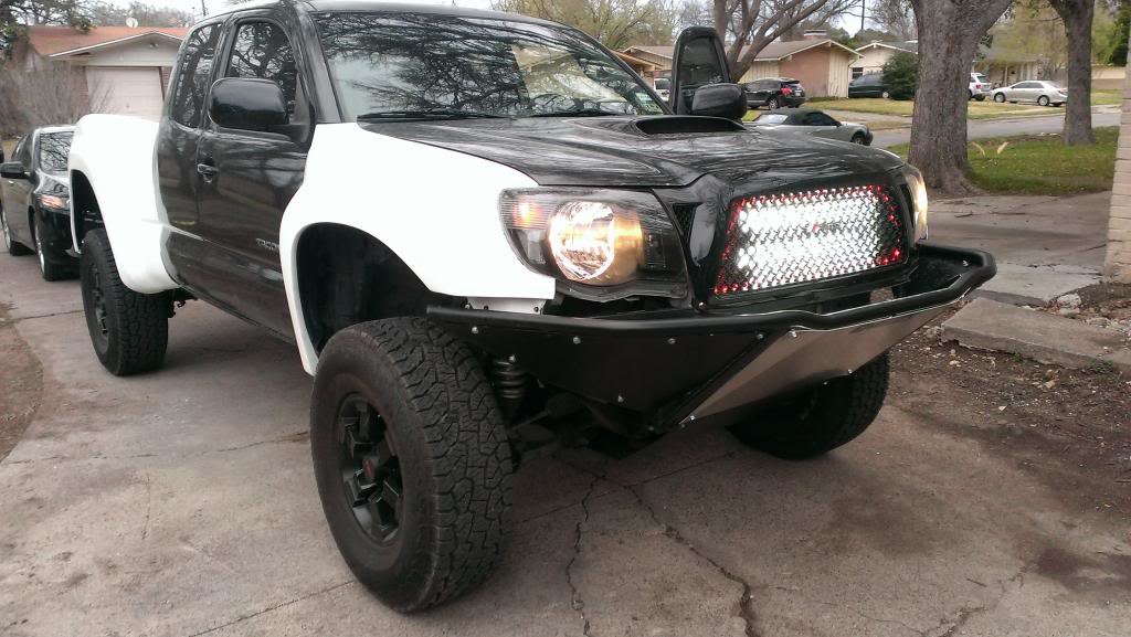

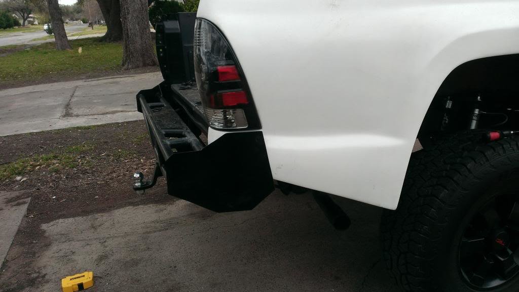

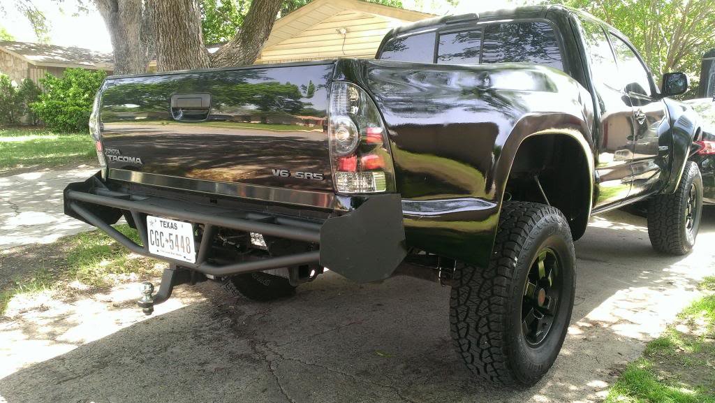

    Rear bumper fab
    Rear bumber finished

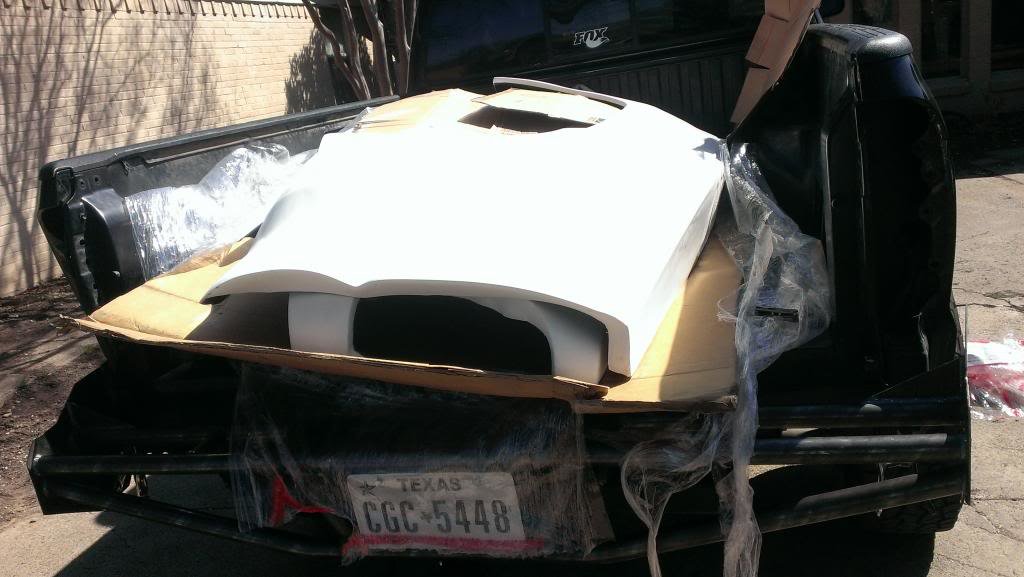

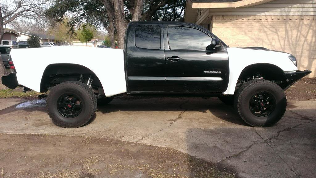

    Fiberglass fenders and bedsides
    Fitting the fenders
    Fitting the bedsides

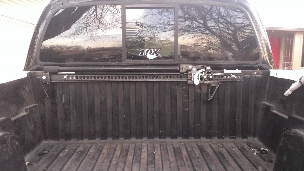

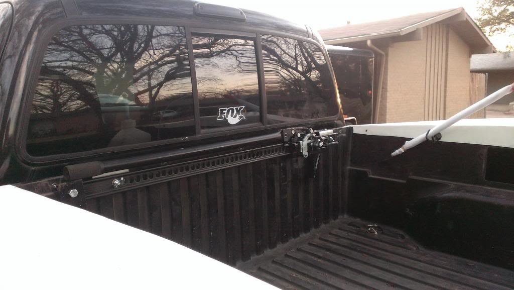

    High-lift jack installed w/ custom $4 mount

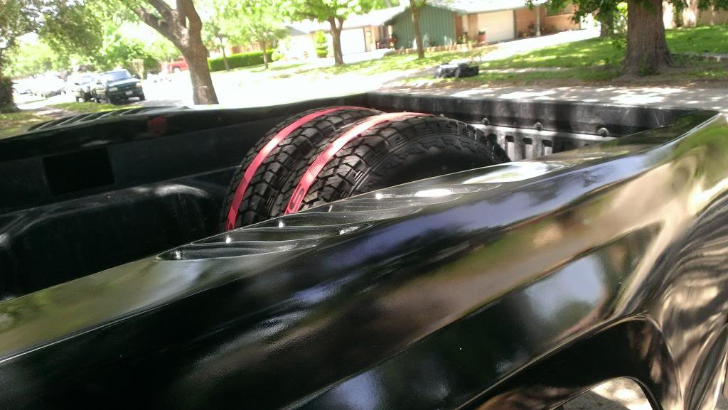

    Fabing vertical spare mount
    Spares mounted w/ tailgate usable

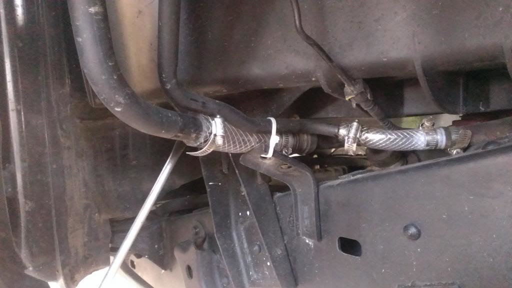

    Extended Gas Filler Hose

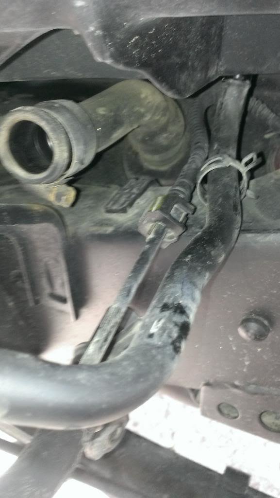

    Thanx! ebay. i originally tinted parts of the stock ones but they didn't seal well and leaked. So i got new ones w/ black bezel.

    Looks great! Where'd you get those custom TRD decals?

    I tweaked out and made a vector in illustrator and gave it to 'Fast Signs' who cut it out of vinyl in two layers (for each color). i still have the vector.ai if anyone wants to use it for a template to make their own

    you have the same rear shocks, leafs and wheel spacers lol, nice man
    EDIT: heres what mine looks like with the 2" wheel spacers from AP, my wheels have 4.5 BS. thats gonna look nice on your rig

    Thanx guys! Just pulled off my fenders and bedsides, glass on the way
    Chopped my cab mounts, waiting to plate it, pics coming soon :)

    That bumper is great! I'm in Tulsa, what did they charge you for your bumper and how long did it take?
  16. Mar 13, 2014 at 8:07 PM
    #16
    Only Danks
    Only Danks [OP] TRUKWERX : Desert Racing Products
    Apr 21, 2013
    #102508
    105
    Bryant
    San Diego, CA
    05 Black TRD O/R 4x4
    3" MID-TRAVEL LIFT: Fox 6x2.5 Front RR C/O's, Fabtech unibal UCA, Fox 10x2 Rear RR Shocks, All-Pro Leaf Pack, Fox 2x2.5 Air Bumps all 4, Strapped all 4, TC Gussets:, Lower Arm Cam Tabs, Front C/O Bucket Tower, Spindles, OTHER: Custom Front Bumper skid, Custom Rear Tube Bumper, McNeil Racing 3" Fiberglass Fenders, McNeil Racing 4" Fiberglass TT Bedsides, 2 Matching Vertical Spares, GrillCraft black mesh, 07 LED Tails(black), Headlights (black), Viper 5204 Alarm, Remote Start, Cobra 19 CB Radio, 6 ft Red LED Firestick Whip, High-lift jack, Black Emblems, STEREO: Custom Nexus7 inDash, Rockford 3sixty.3 to SPDIF, Rockford T1 6.5 Comp Front, Rockford T1 6x9 rear, Rockford PBR300x4 Amp, Rockford P310 (x2) rear seats, Alpine 1100w amp, USB DAC via SPDIF, USB Audio ROM, FUTURE MODS: TC +2" LT Kit, 8" LT Coilover, 16 Rear Piggys, L/T CV Axle Shafts, Heim Steering, DMZ SUA kit, Bedsaver cage, Shackle Crossmember, Motor Mount Gussets, Box Frame
    Thank guys! um the bumper took about a week due to sending it for powder coat. Got a great deal only $500, made by expo motorsports, inspired by special_Ks build from KR.

    dude, I gotta say man, im jelly for those new glass fenders....I would love to get some new fenders. it looks awesome
