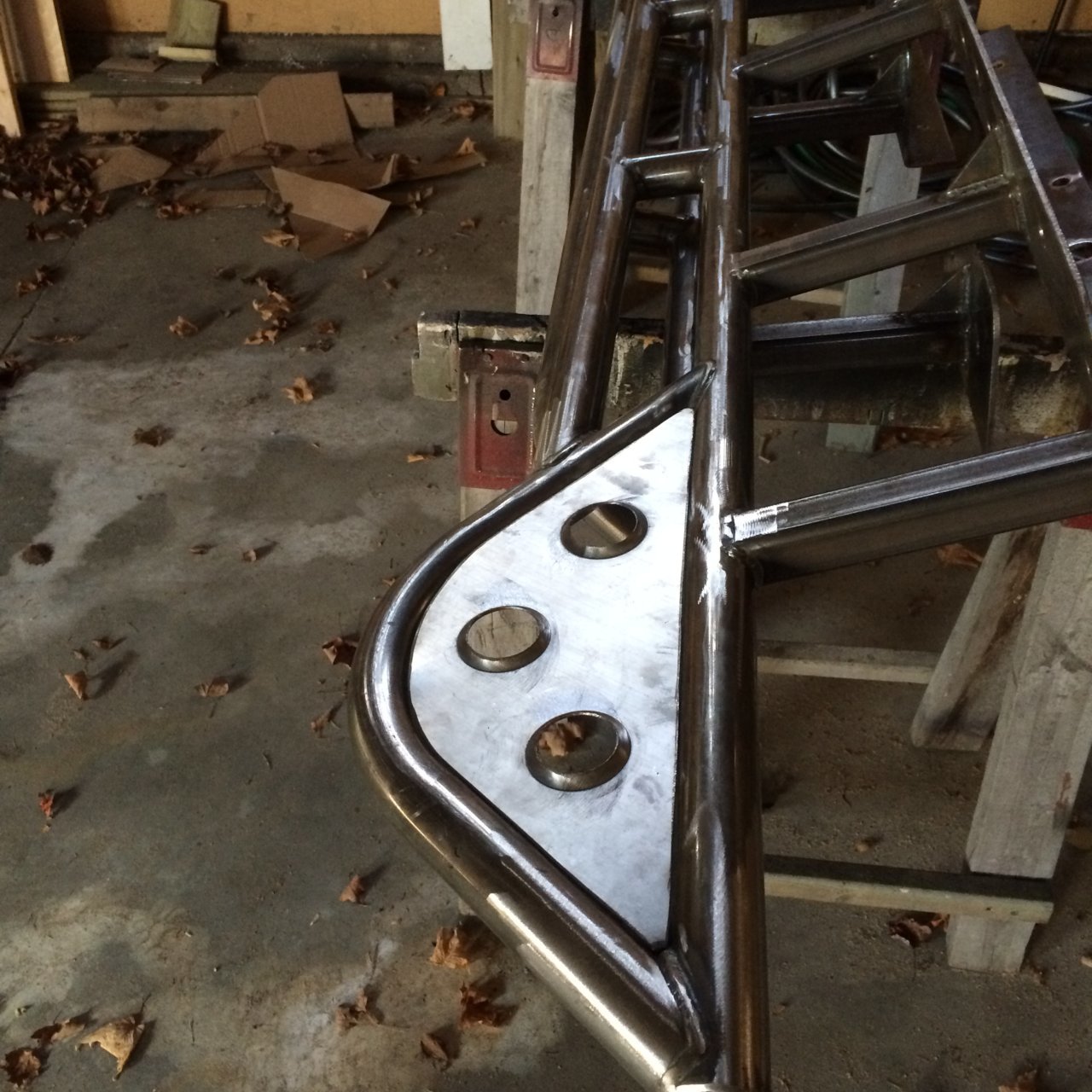

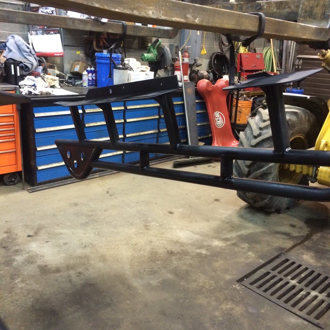

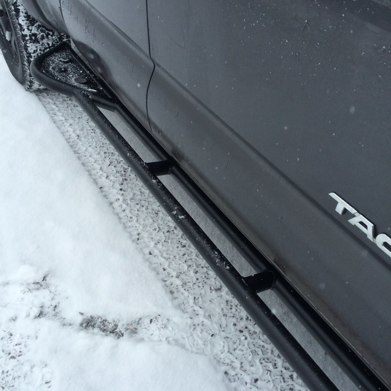

    Definitely build them or have someone else weld it up for you. I built a set of bolt-ons as well. Go DOM tubing and you'll never have an issue with strength.
    You just need to take the time to create the template for the frame rails.IMG_0893.jpg
