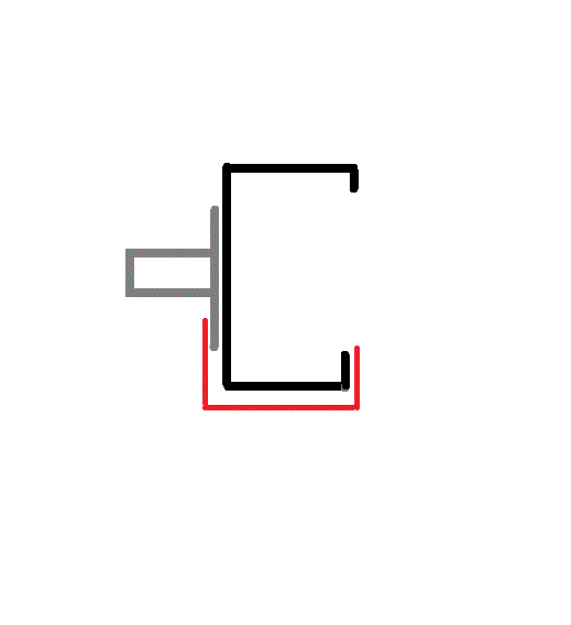

    Oh man you are a Civi, Lol k let me go get my Crayons... just cause you guys make water flow uphill does not mean you can walk on it... hehehe (from a Mechi talking) my brother in law and nephew are Civi's so I like to give you guys a hard time. ;)
    If you look at the ends of some of the sliders out there the just run along the side and on some parts of the bottom of the frame. At the back where the kickout and highest part of mechanical advantage you have a plate against the vertical part of the frame with maybe one bolt in the center. That plate is put under a torsional load when force is put on the kickout.
    So if you took one of those RCI and similar designs and "cupped" the bottom of the frame, the plate is no longer taking that load. The frame is. the C channel method would be welding the red channel on the LH side to the slider plate and then on the inside lip of the frame clamping it (even without the beam clamps you will be increasing the strength pushing up but not when you are pushing down on the sliders).
    As you know, flat plate is the worst for deflection under torsional load.
    Have a look at this bad Paint sketch and it might explain it better.
    When you push up on the lever the bottom of the backplate wants to go left and pulls away from the frame drilling extra bolt holes is an option, or welding back there too but.... just need to have the back plate transfer the force to the frame without deflecting... Lot easier than beam loading calculations so you can put the slide rule away! ;)

    holyshit everything you said made sense!
    but yeah i see what you mean with it wanting to torque over there and why (after taking a quick look at the others) the mobtown ones are leagues ahead (from a logical point of view)
    depending on the load, the new shear stresses of the system wouldn't be near the through holes in the plates but the actual truck frame itself.
    Ok so crawled under my truck and i hate you with a passion as i dragged my old steel book out of my shelf for this :rofl:
    C100x11 channel would technically work instead of welding 2 angles by their feet.
    but what i found interesting is that the truck isn't a true C channel. It's got this tiny stub of reinforcement (240mm by 35mm) but it's recessed in a tiny bit, at most a 5mills.
    so how does the Mob down connect to it? the plate seems like it's there for reinforcing the bottom half of the member, but you'd need to drill holes to bolt it on the other side no?
    EDIT: unless it just hooks on and hangs on for dear life?
    Edit: Fuck it, i'm over thinking this
