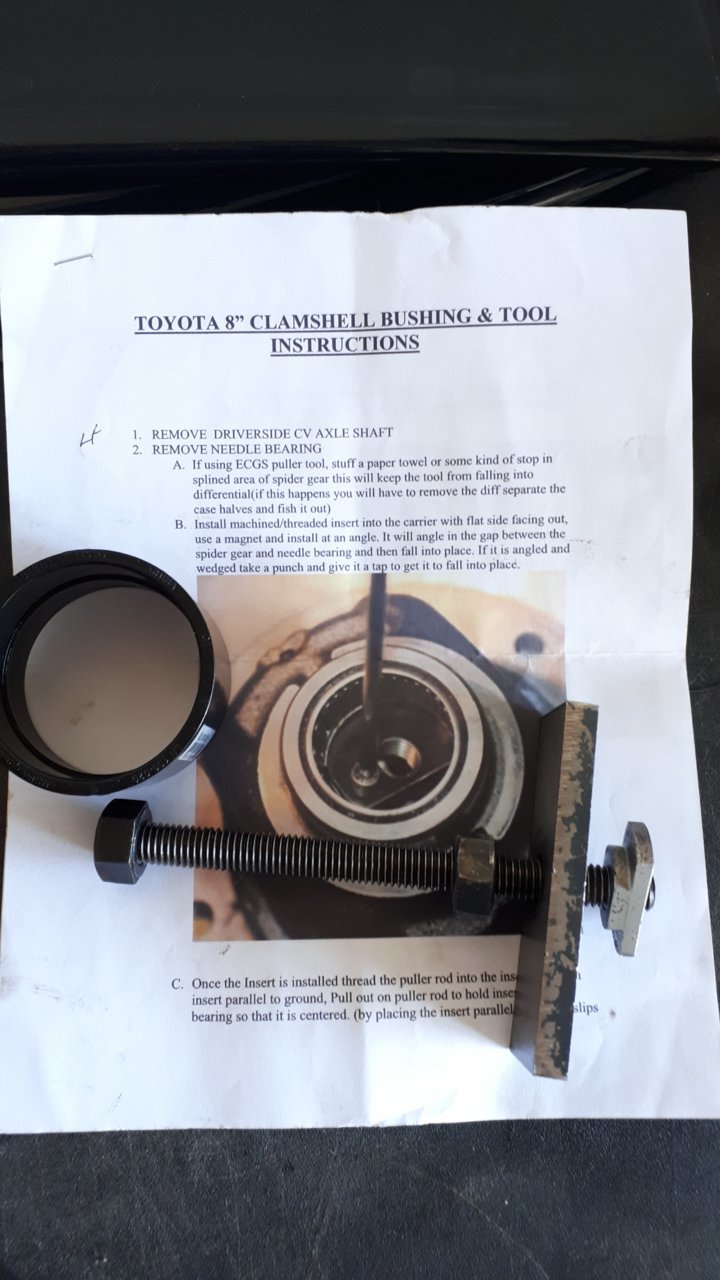

    I did mine in the driveway, pretty much what @tgelata said. Might need a second pair of hands to pull the rotor assembly away from the cv, after that just a big screwdriver will separate it from the dif. I have the tool (please somebody take it off my hands) for pulling the bearing. You can replace the seal for cheap at toyota. Then tap them back in with a socket. The pvc is perfect size for pushing the rubber seal back in20190711_073629.jpg

    I love the instructions, 2 A (if this happens just give up and you are dickered, a rag though, it is your saving grace.) :cookiemonster:
