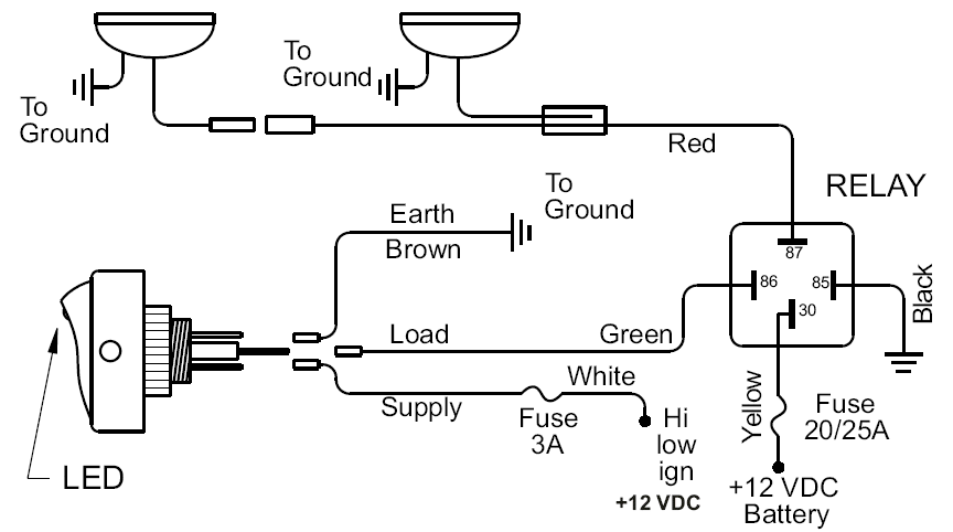

    does anyone on here know how i can add a new fuse? I want to do bed lights but dont want to just go off the battery and dont really want to fuse tap. I want to use a slot that isnt currently being used and have it have power all the time

    you would use an empty slot in the fuse box in the engine bay, and run a add a fuse. You would need to have two fuses in the thing regardless if there was an existing fuse or not.
    The only other way to do this without this, would be to find the oem wire that runs to that blank fuse, cut it and run it to your accessory.
    IF your planing on running lots of auxiliary lighting. You could add something like this to save yourself in the future. A whole additionally fuse block.

    There's no way to run the wire from my switch to the fuse? Like with the power wire that gives power to that fuse?

    You just connect them. So using the add a fuse, you connect it to your switch. I would recommend using a relay. If the switch is in the bed run it along the frame.
    Your + would just be the fuse in the fuse box

    by doing so you would be bypassing the fuse. the fuse is there for protection if it shorts.
    those add a fuse are the easiest way, the interior fusebox of the 16+ does have one spare but its a pain in the ass to get to where you'd actually terminate
