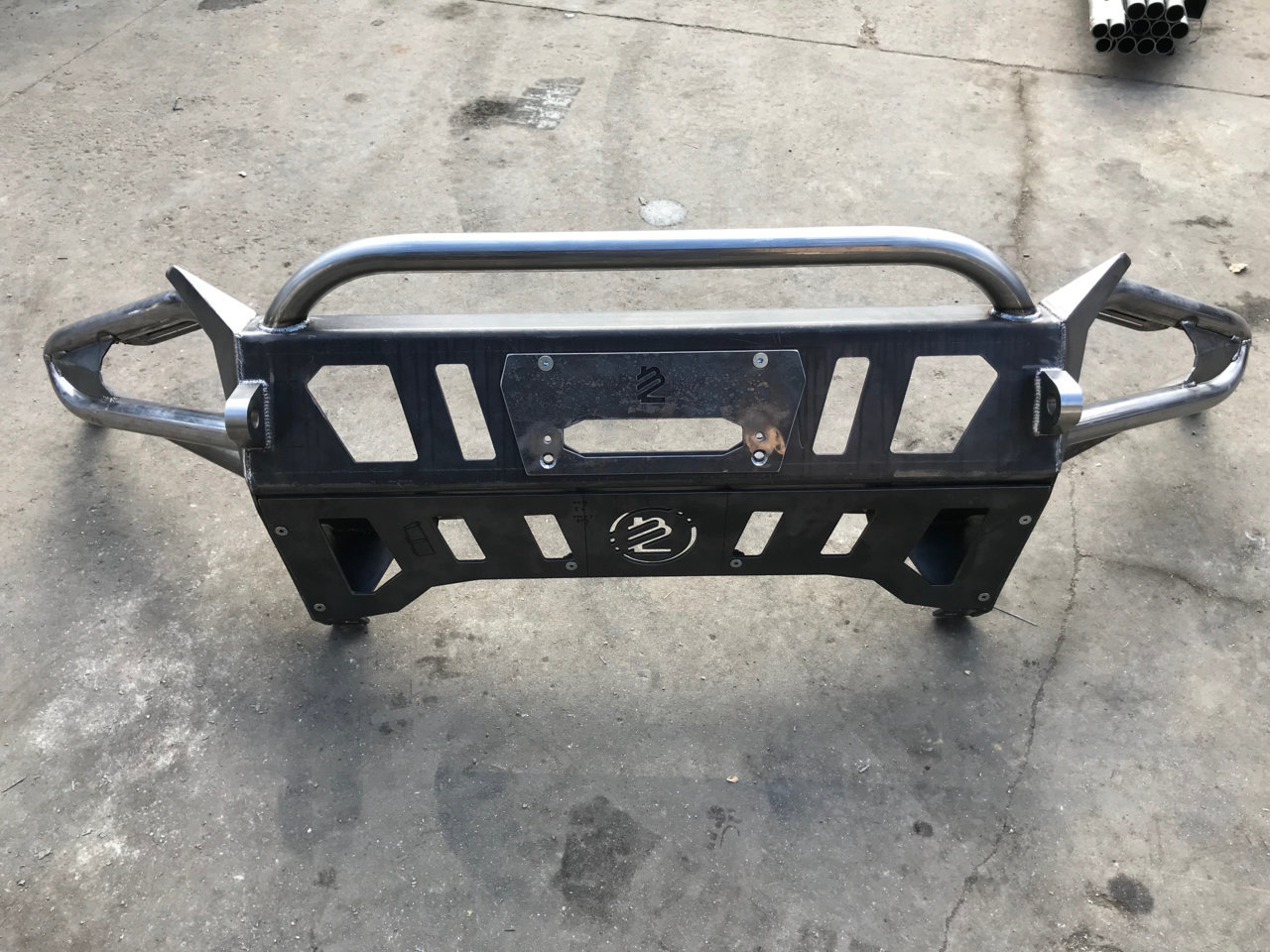

    So, I'm looking at a Warn Evo 10-S and I have this bumper from Lil Bs down in Colorado.

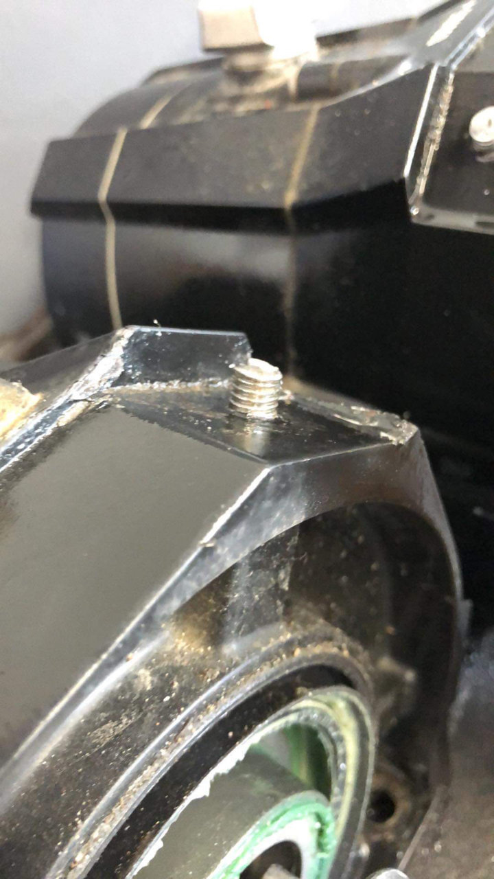

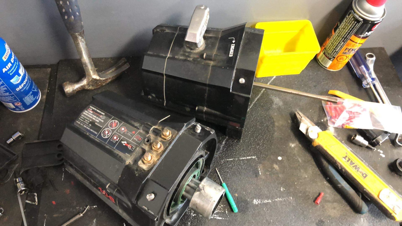

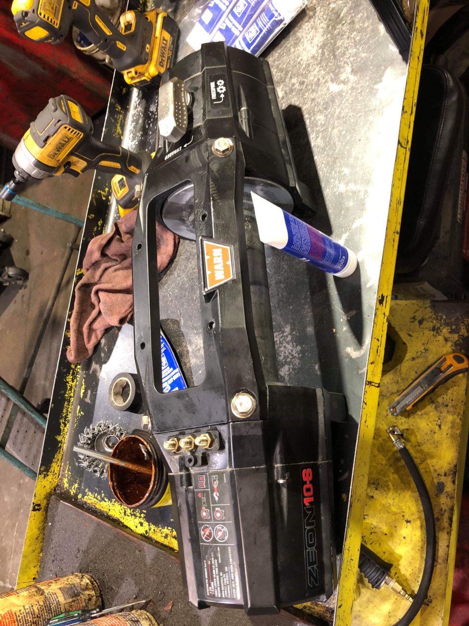

    If you want US made, you'll have to go with Zeon series and they are $$$. I got used one recently for half of the original price, wasn't happy with the design choices warn made... For example bolt heads snapped on me when I tried to remove bracket that holds motor and clutch together...It was a nightmare to fix...:annoyed:
    70FF75F5-276C-4FFA-BB22-8681E8FD3766.jpg 76FF5E6B-7463-4C5C-9607-8BAEBF0B4743.jpg 3248B759-4157-4BBF-B555-0BD657A02C47.jpg

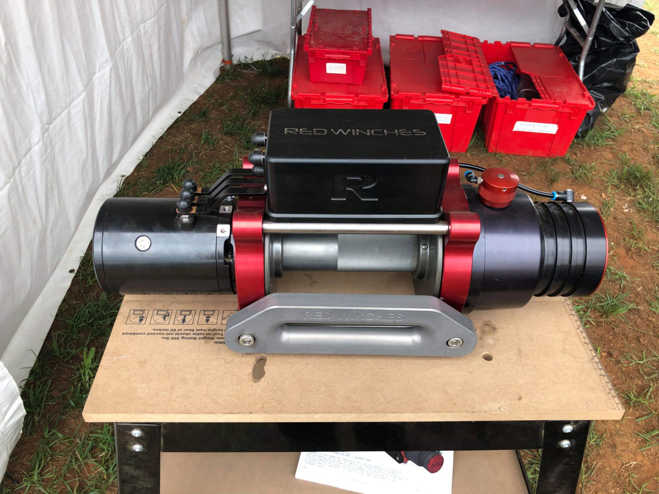

    If I had to do it over again, I would go with Red Winches. Much better design and quality.

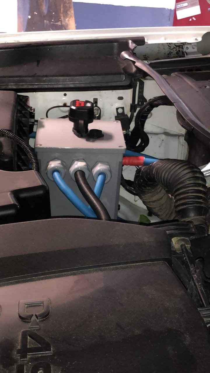

    As for solenoid, you can relocate it behind intake box.

    @Norilsk checked out those Red winches and I thought the Zeons were expensive :eek:they do look really well made though

    Most of the bumpers for the tacomas require you to relocate the solenoid box either in the engine bay or on top of the winch....Mines in the engine bay. Been happy with my super winch tiger shark
