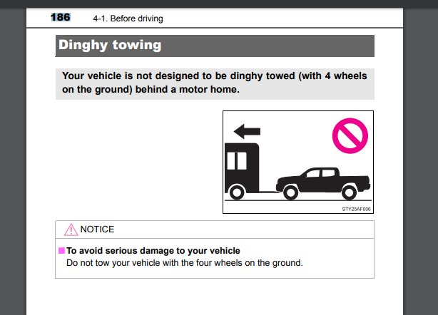

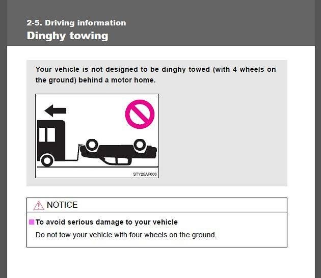

    flat towing a tacoma;
    Disconnect the tail shaft? not sure too much
    edit; found this in the manual.
    2nd gen;
    3rd gen;

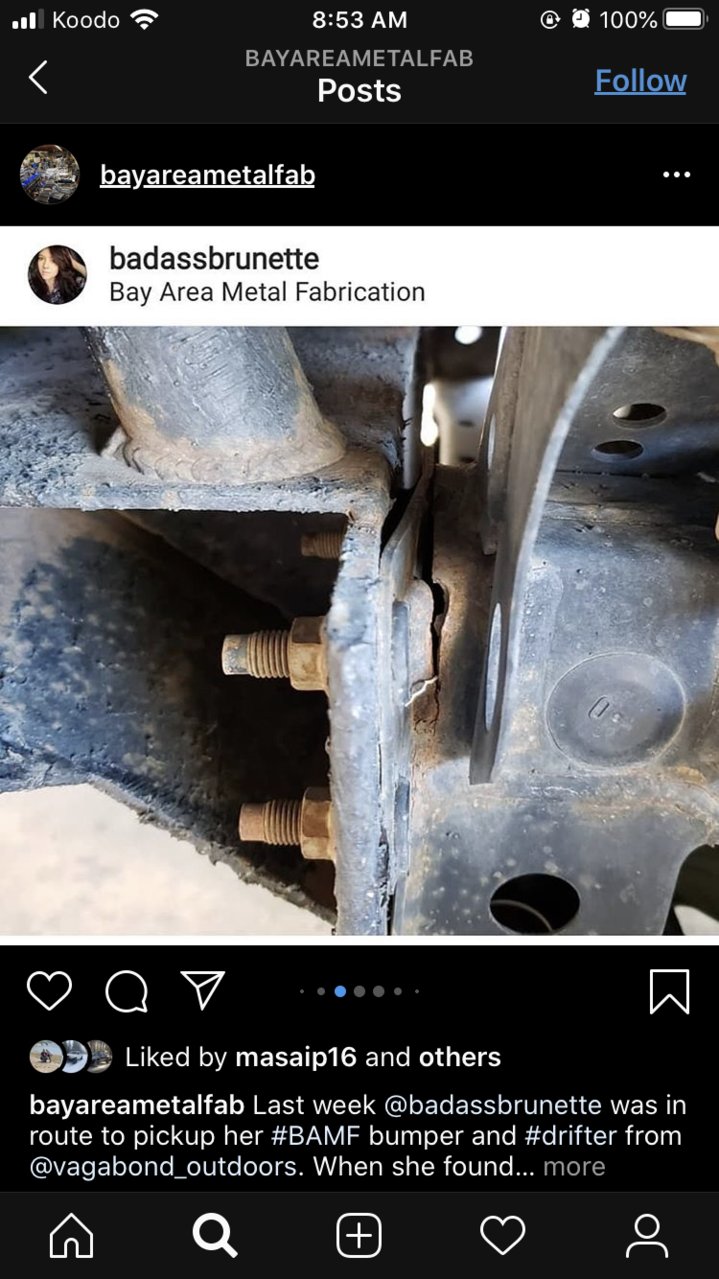

    this is what mine looks like, except totally broken off...

    that was me talking about the extra stress. Just making people aware of the weakness of our front ends.
    yes carrying around a heavy bumper does cause extra stress but it’s a bit different than a 6-12” lever pulling the truck sideways. Front pulls sure but that wasn’t what I was talking about.
    you could potentially straighten a pull with snatch blocks but how many are you going to bring and are you going to have enough anchors?
    Again just something to consider. Like you said the additional weight of a bumper may not suit others and the extra weight causing wear. However, pros and cons to everything. Considerations for every option. Was simply making sure that the idea of a lever with a winch cradle wasn’t forgotten. Just like I was made aware of the gusseting and reinforcing to do when I got my bumper years ago.
    Something to consider for anyone putting a winch (what ever method)
