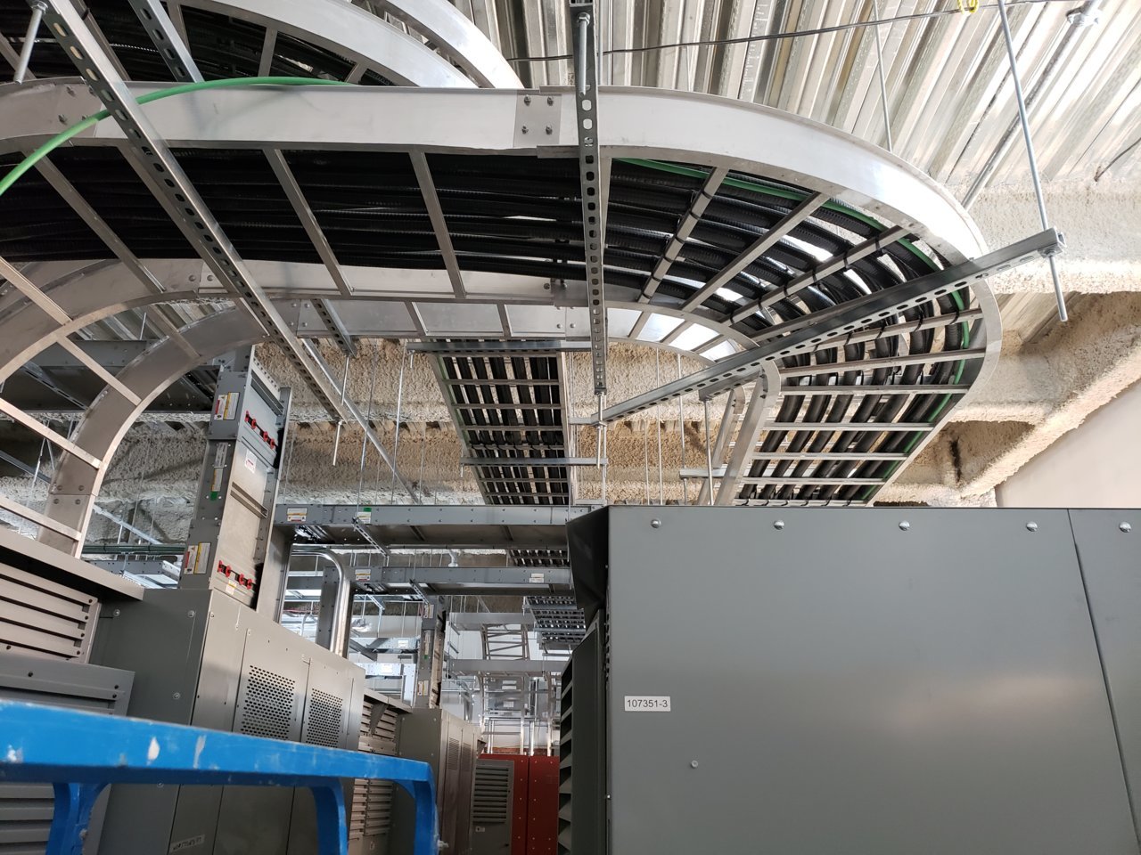

    Years ago I went to James bay and toured the big hydro plant there.
    All the electrical lines taking electricity from the dam and distributing it were aluminum. I'm pretty sure they still are.
    They said it had something to do with the weight.
    If its good enough for them should be good enough for a winch
    I have some pics but it just looks like any other hydro station so hears a better one.

    Power transmission lines are high voltage and relatively low current, so they can get away with higher resistance without creating too much heat.

    Almost all over head lines are aluminum if that's what you're asking.
    Basically as said and also cost.
    Overhead services coming into houses are almost all aluminum.
    Most feeds in underground service are aluminum. At least in the 3 years I did low rise everything was.
    All those black cables you see in that tray are single conductor 750kcmil aluminum Teck cable.
    The new former Toronto Star printing press data centre off the 400 and 407 is the largest in North America and it's all aluminum feeders as well. Because the building structure couldn't withstand the weight of copper.
    Copper is significantly heavier and more expensive. There's no issues with aluminum wire as long as it's terminated properly.

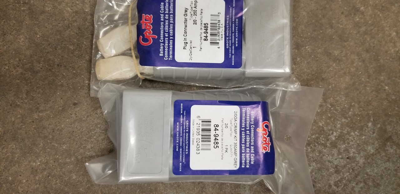

    we stock grote good quality
    tacoma16[OP] and Joe23 like this.

    Does that price include the lugs? Those add up quick.
    I buy everything individually
    Will say that's actually a pretty good retail price.

    yah they come complete can get a cheeper brand too unibond that's the part numbers not pricing
