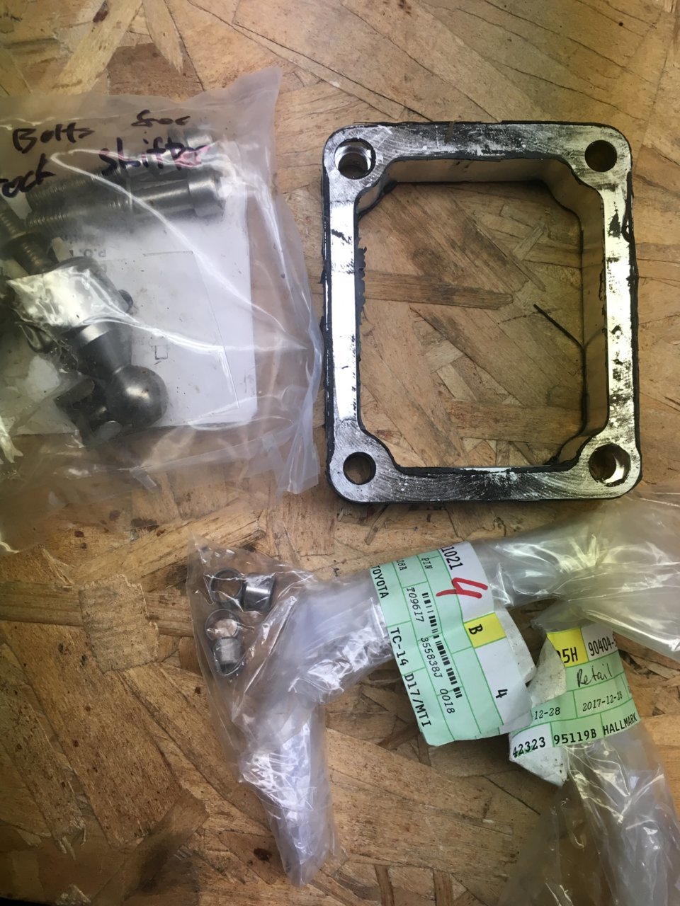

    Since the URD SS does not replace/exchange any OEM parts, but merely adds onto them, I would not expect anything to “loosen up” after time. The kit Adds a 1” spacer plate, and 1” shifter ball extension. Even your shifter ball bushing is re-used, assuming you can get it off in one piece.
    For roughly $100, I love mine, and did not feel it necessary to further upgrade with another brand.

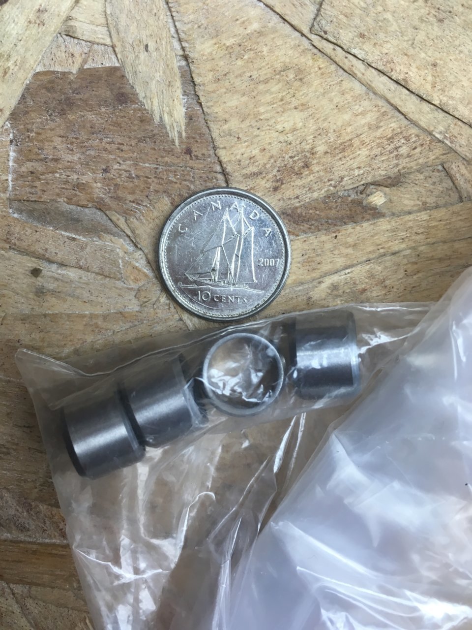

    I suggest buying two additional shifter alignment bushings (90253-11021) to keep everything square. OEM shifter uses two dowels, but when you put the spacer plate in, you need two more dowels. Previously I used 1 dowel on either side of the plate, but for $5 the install is made more legitimate.
    In the photo, notice two corners have slightly larger ID to accept the dowel and locate on the trans. Both sides of the plates are drilled for bushings making 4 total, but OEM only uses 2.

    Dowels. P/N 90253-11021. About 10mm diameter, can’t recall cost exactly, But cheap enough.
