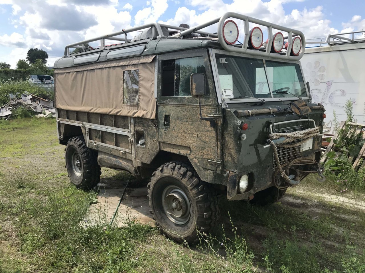

    weight
    weight Well-Known Member
    Nov 25, 2017
    #236902
    1,050
    Kevin
    Ontario, Canada
    2018 Manual Double Cab Short Box
    His other Land Rover is pretty well equipped with a mid-mounted winch.
