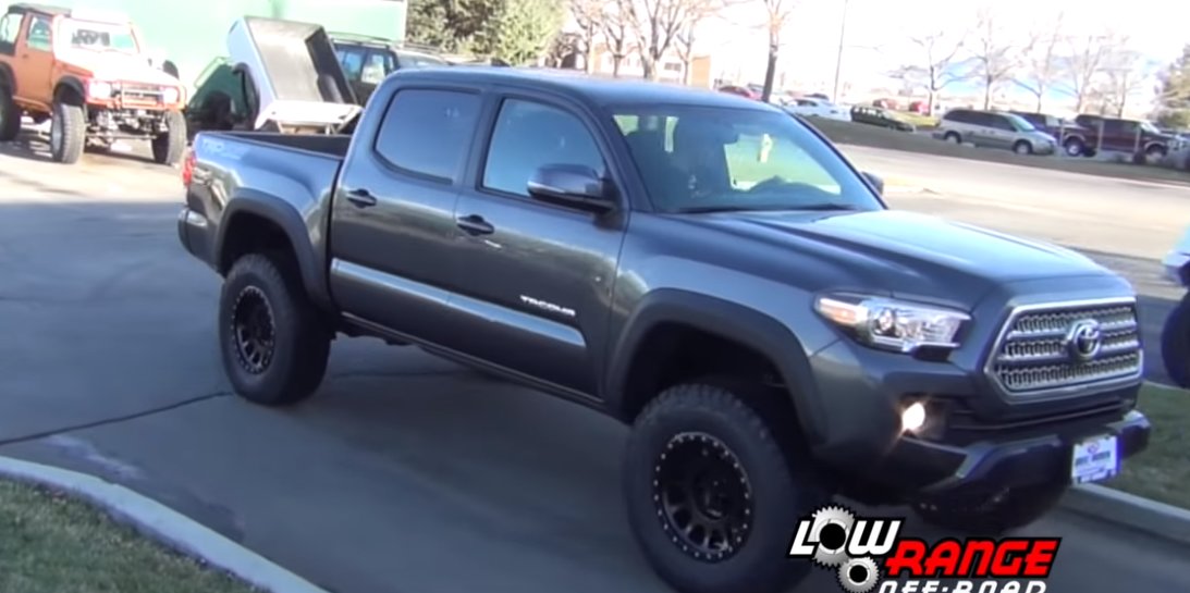

    so found and install guidefor that lift https://www.youtube.com/watch?v=IOW-FRDl5wg
    and this was the end result.
    GEEZUS that's tall...
    but that video is extremely useful guide, toque specs and all are mentioned
    the issue i have with 2 inch lifts, is that the CV boots might start wearing on themselves... i might be over thinking this and it probably doesn't make contact - but it's something in mind i'd like to avoid being damaged... checked the rest of the site and fouind the 5100s https://www.bilsteinlifts.com/shop/...ith-eibach-coils-for-2016-2019-toyota-tacoma/
    but no idea about those springs. also, do a block lift or no?
