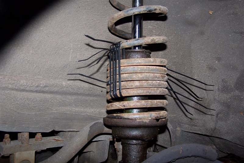

    For changing the spring you can use the zipties, ratchet straps, weight of the vehicle and a jack.....
    or you can call around to the local suspension shops and pay them $30-60 to do it with their bench machine.
    Takes minutes on a bench compressor.
    Just remember the springs will have 600-700 pounds per inch travel of stored energy... take them seriously when they are compressed.

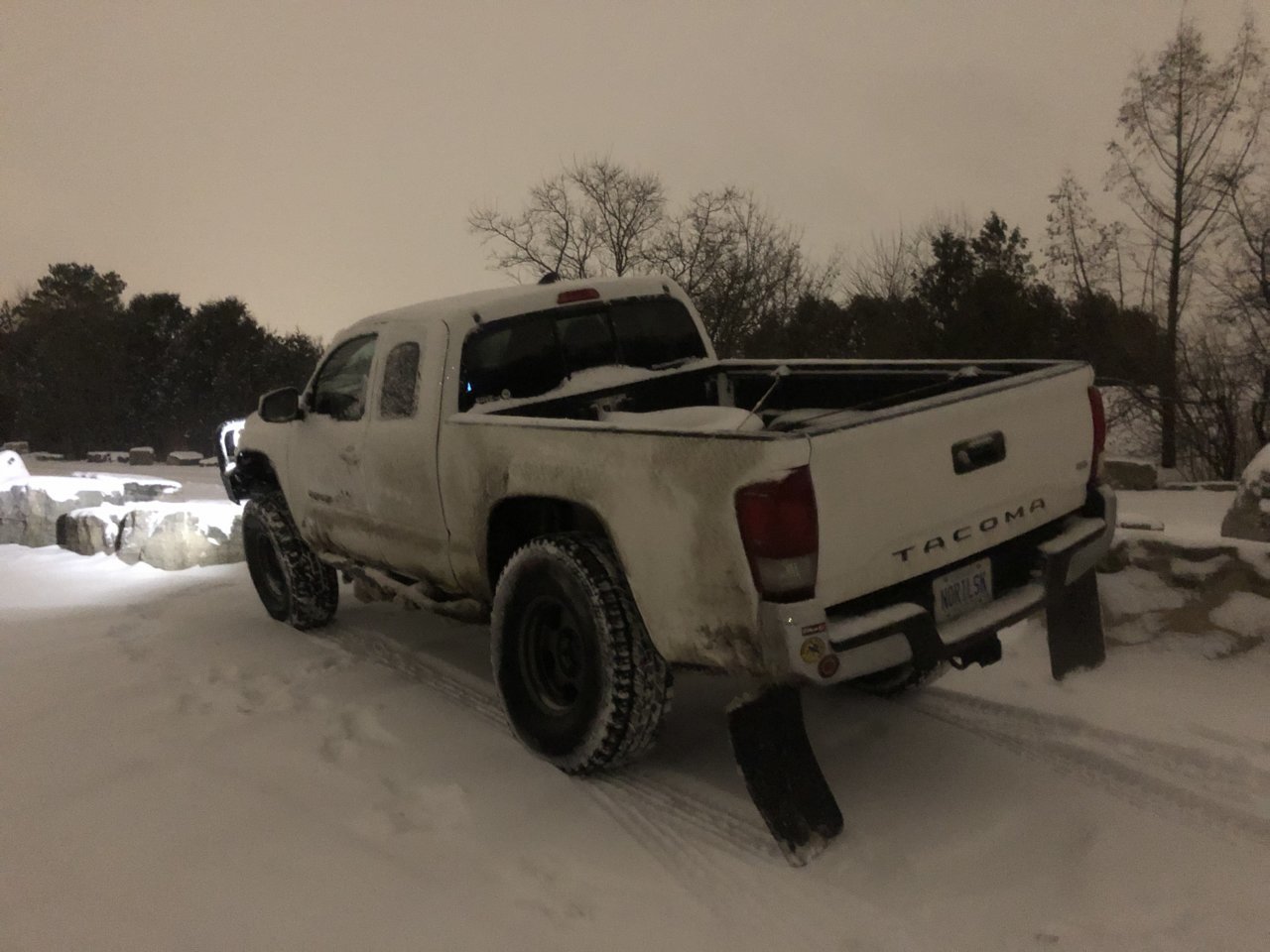

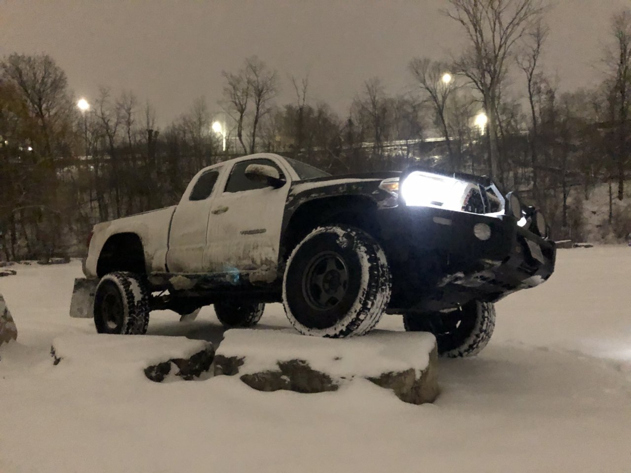

    In short - get whatever you can afford with your budget @Shveet and hit those mall curbs or park stones...
    Gentlemen's above explained it pretty well. I didn't even think that hard when I picked mine... :notsure:I got what gives me the most flex and let's me jump the buggy once in a while.
    is Park Crawl a term yet?
