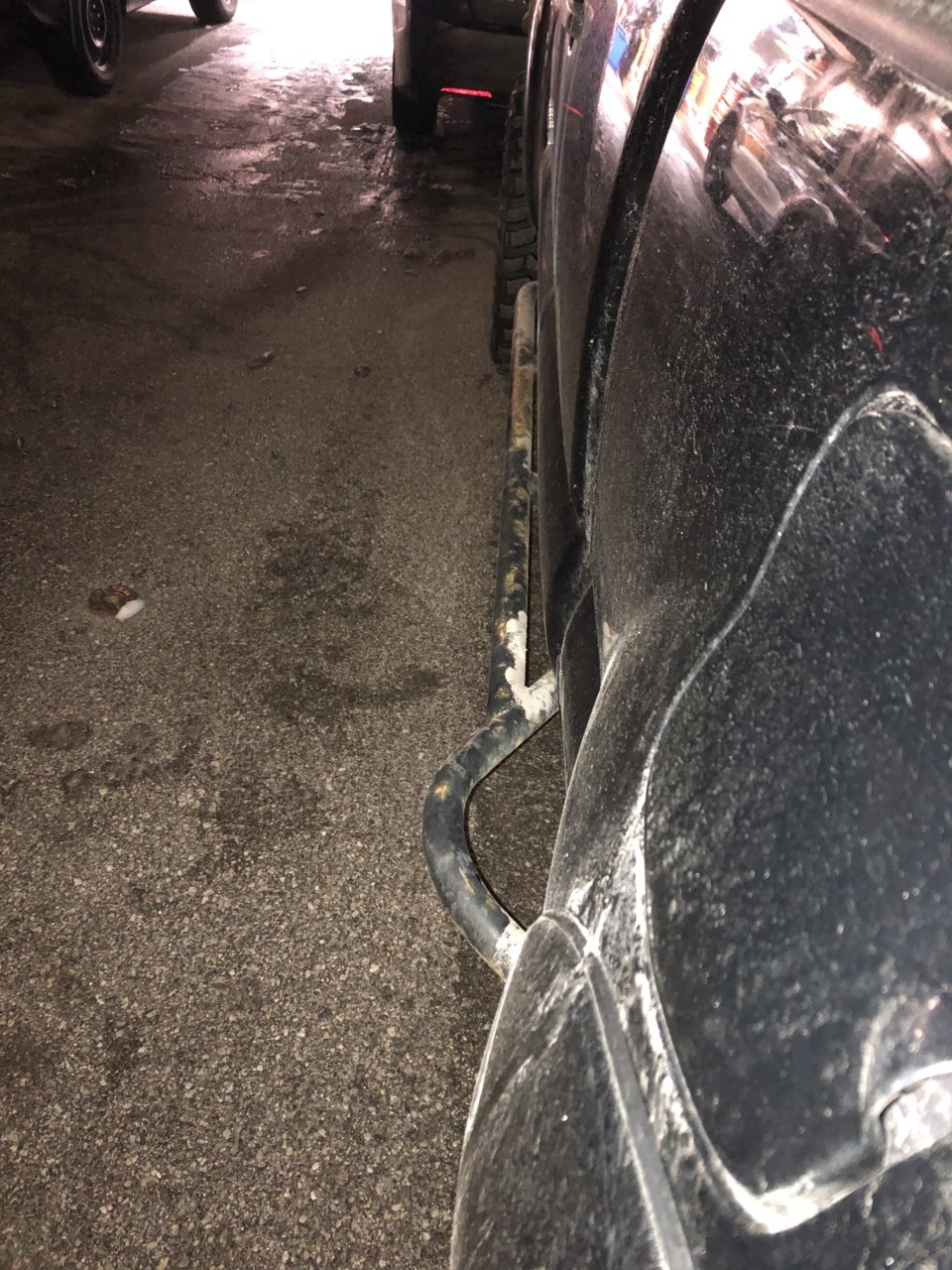

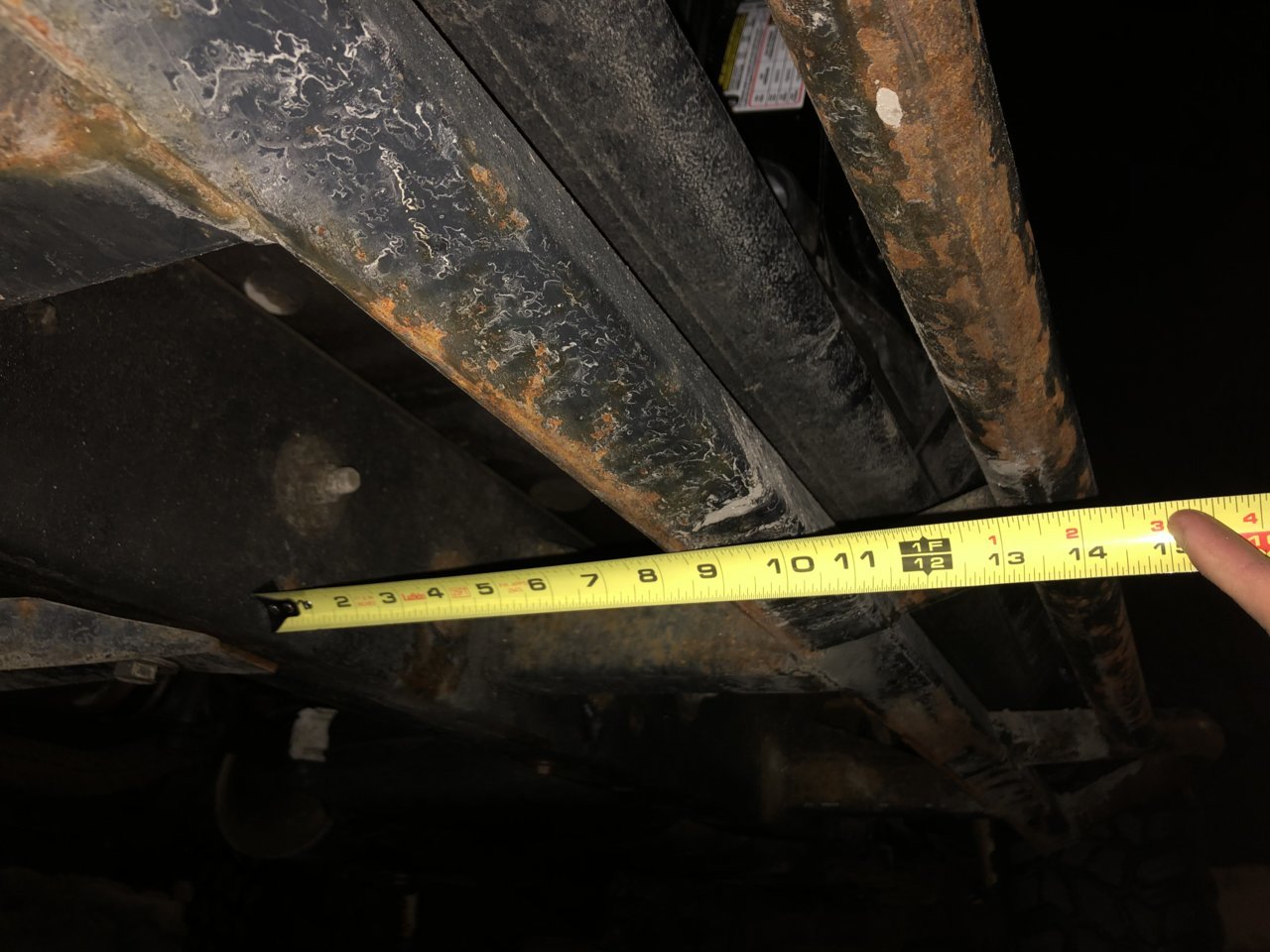

    @Crayons heres some shitty pictures of roughly where i built mine to. (ignore the rust I'm dealing with it in the spring.)

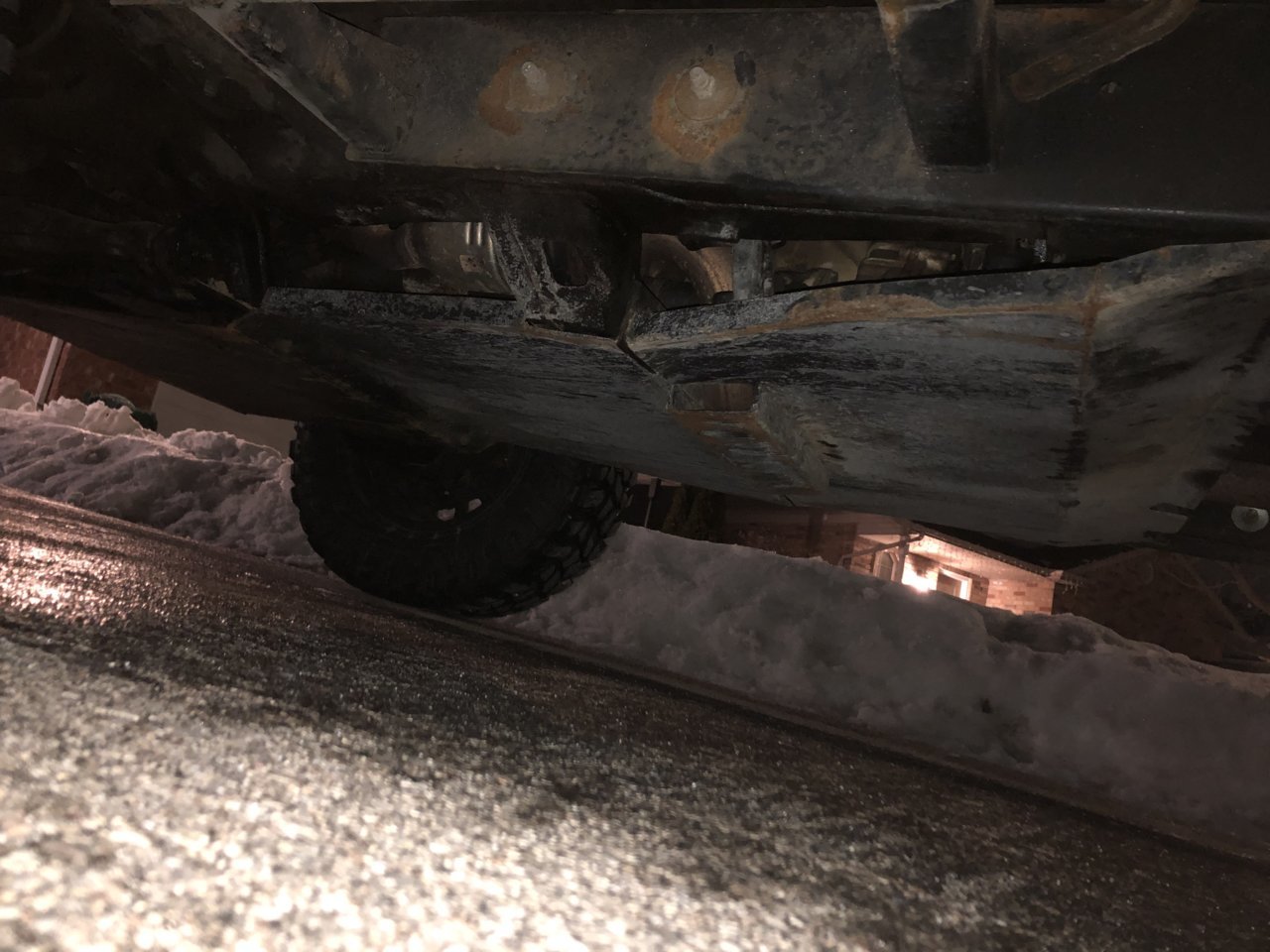

    And one of my skids
    Frame plates are 3/16
    Square is 2x2” .125 wall
    Tube is 1.75” .120 wall DOM
    i can take more if you need them
    I’ll probably be pulling my skids off in a couple months. You can copy them if you want
    You can see the clearance i did on the skids for the exhaust because i didnt do the reroute. It hits everything

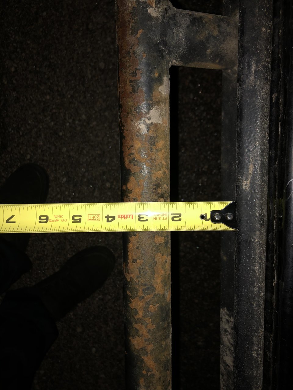

    measurement to the rocker panel

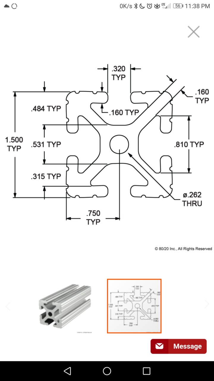

    Anyone know where i can find 80/20 1515 extruded aluminum t-slot bar without needing to special order the stuff?
    Needs to be the 1 1/2 inch stuff....and needs to be 6feet long at a minimum
    Trying to build something and i cant for the life of me find something local to do a quick 2 second test fit...
    Also hoping that place isn't going to charge me an arm and a leg.
    No, i'm not building a prinsu rack
    Fastenall doesnt stock it,
    Metal superstore doesn:t know what it is either

    Oh this is perfect! I kinda guessed about 14" from frame to edge of slider, so looks like i wasn't far off. Thanks for the pics, it confirmed i wasnt crazy with my measurements. I think for the skid plates i should go measure and design them myself. Half the fun of the building is the measuring.
