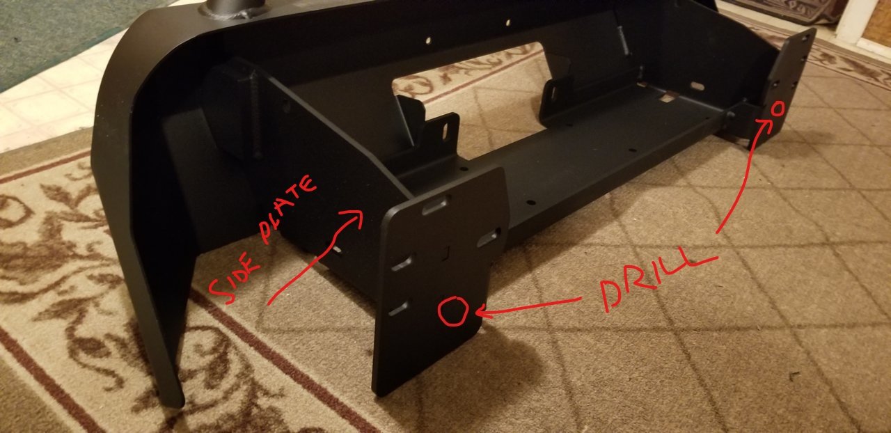

    if you post a pic of the bumper from the backside that will mount to the truck i should be able to tell you.

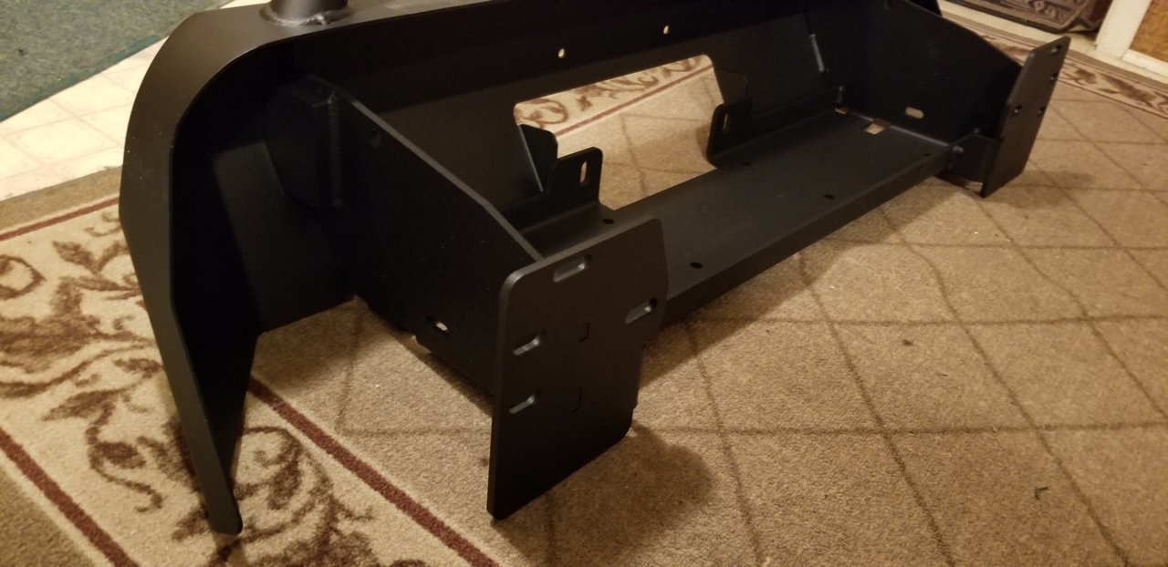

    here is the mounting

    unless i am not seeing them already there you are gonna need to drill the holes that i drew in. drilling a couple holes and hitting them with a bit of primer/paint is no biggie but the real problem at least with my SOS streamline bumper is the holes needed to be drilled exactly where the side plate meets the back of the mounting plate that bolts to the frame horns. i elongated the holes to the side on the truck frame a little with a dremel and drilled over to the side as much as i thought i could and it worked out fine albeit with a bolt up thats a little crooked. with the sizable grade 8 hardware all bolted up and the beefy bracket i am confident my winch will set my truck on fire before the bumper/brackets fail which means success.
    if i had your warn i would go for the C4 or one of the other similar designs instead of the BAMF unless you can confirm the side plate isnt in the way. i dont remember if you are running front reservoir shocks or not but that might another consideration as those C4 style brackets might not play nice with the mounts.

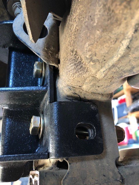

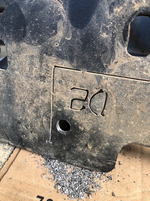

    if what i said above doesnt make sense here is a pic showing where i elongated the holes a little to move the bolt over far as possible in the bracket. also a pic of the hole i drilled that shows where it is in relation to the frame mount holes and also where the other plates will meet it on the other side. hope that helps.
