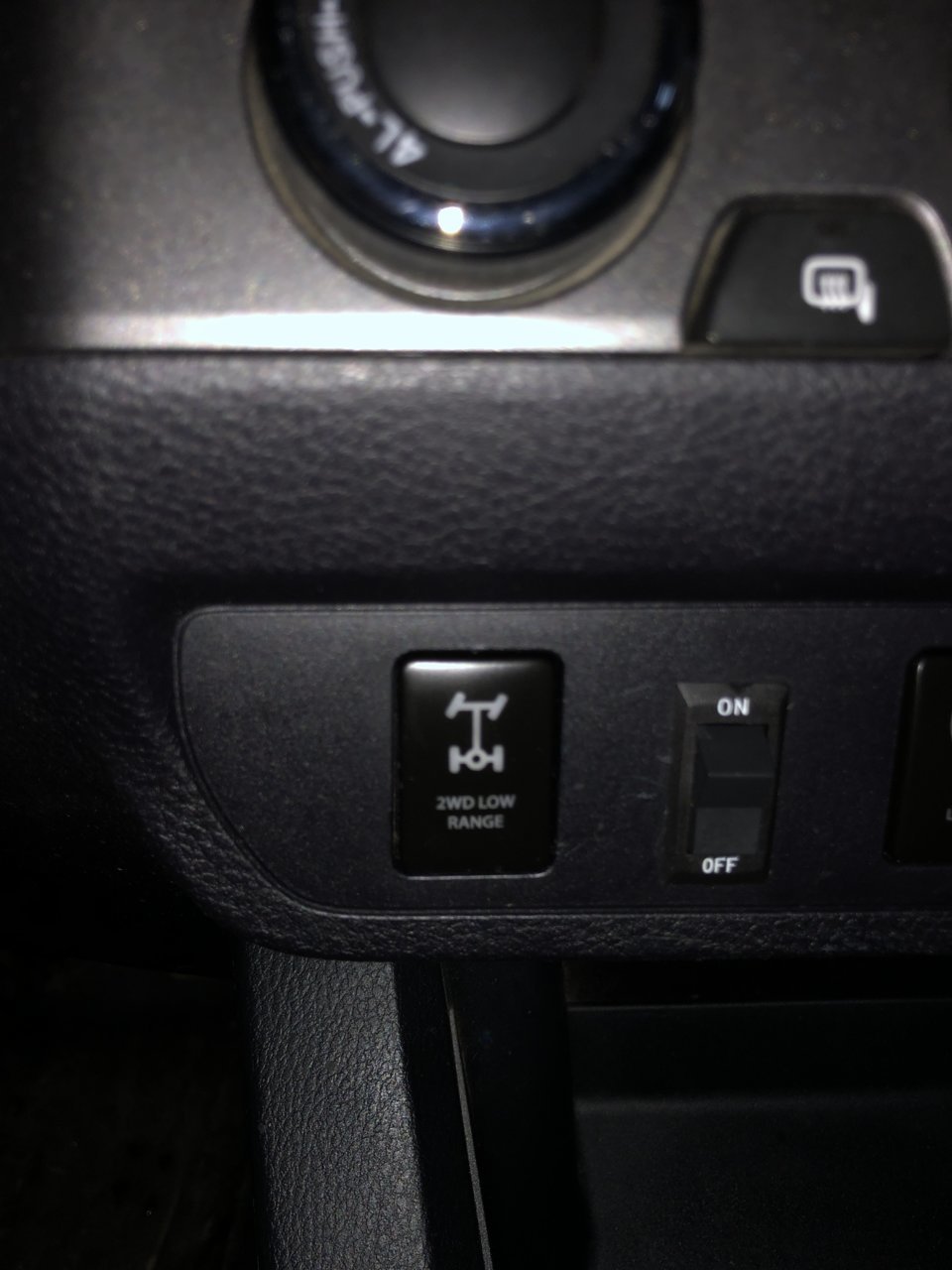

    @tacoma16 and fellow CUNTS see the 2LO kit for 2nd Gens. https://www.tacomaworld.com/threads/2lo-kit-for-2nd-gens.554456/page-12#post-22932103
    These are the LAST batch @Up2NoGood will be making. I bought one about 2 years ago, have used it 1/2 dozen times and love it. I didn’t know there was a 3rd Gen kit, or that fancy button to cap it off!
    I think Grey Wire mod sllows you to use E-locker anytime.
    I think Yellow Wire mod allows you to run “faux A-Trac” or traction control while in 4LO.

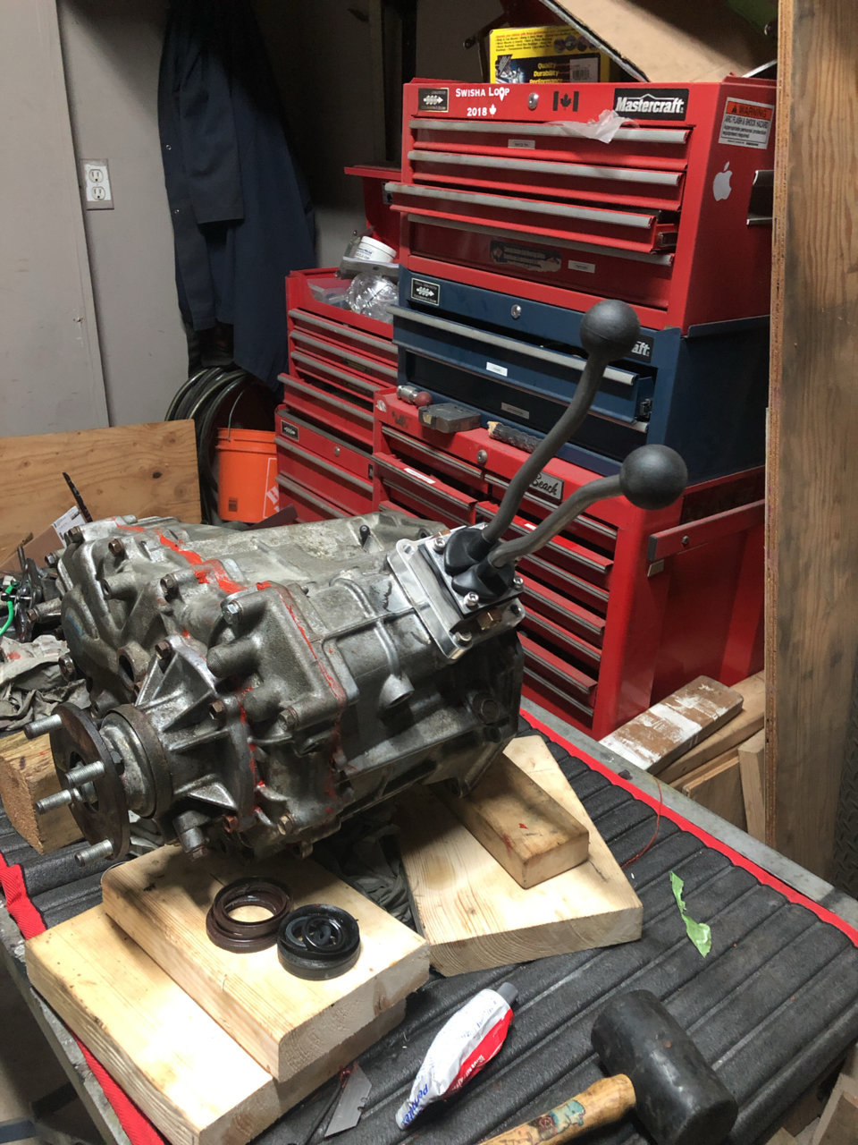

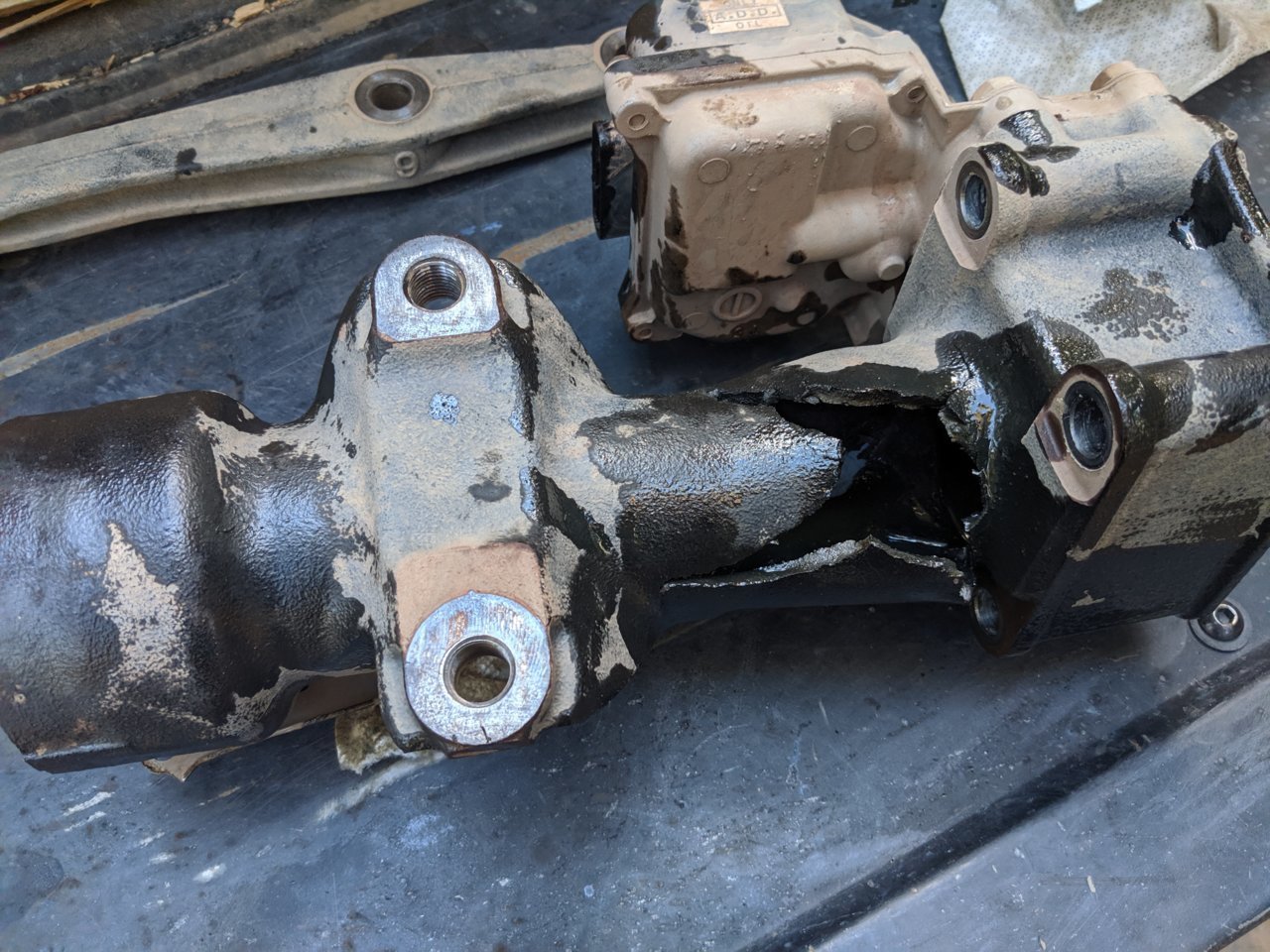

    I went a different route....
    I don’t know how it would work on our tcase though. Would have to go through the shift pattern on the tcase to double check. Based on the fj case you couldn’t have 2wd low without modifying the shift forks.

    Yea that FJ swap is dope. Extra Levers beat extra switches, we already established that :thumbsup::D

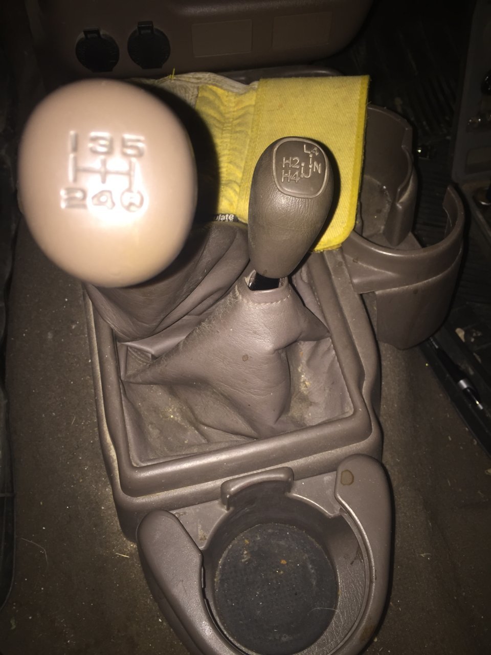

    Good stuff here guys.....I am pretty sure my four-wheel-drive system has minimal electronics… Just the nice green indicator light.
    T-case
    4Lo all the way over and forward
  12. Mar 20, 2020 at 4:22 PM

    I only have one fancy switch and it comes in handy

    You may have an actuator on the front diff. Not to sure about the 1st gens.
    the fjs have a similar shifT pattern. However you can modify them so each shift fork (if there is two) can operate individually.

    Your new gearbox build is very interesting...kudos to your skills!

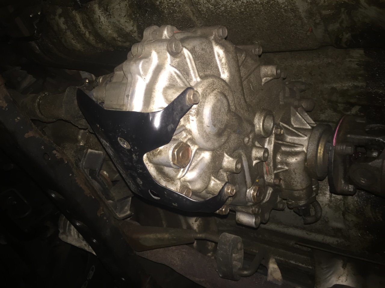

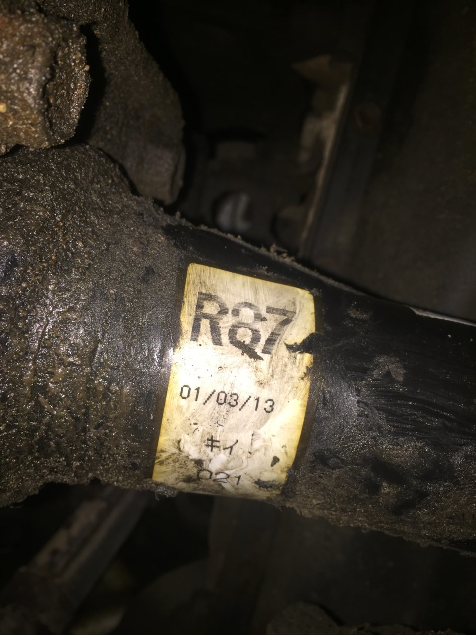

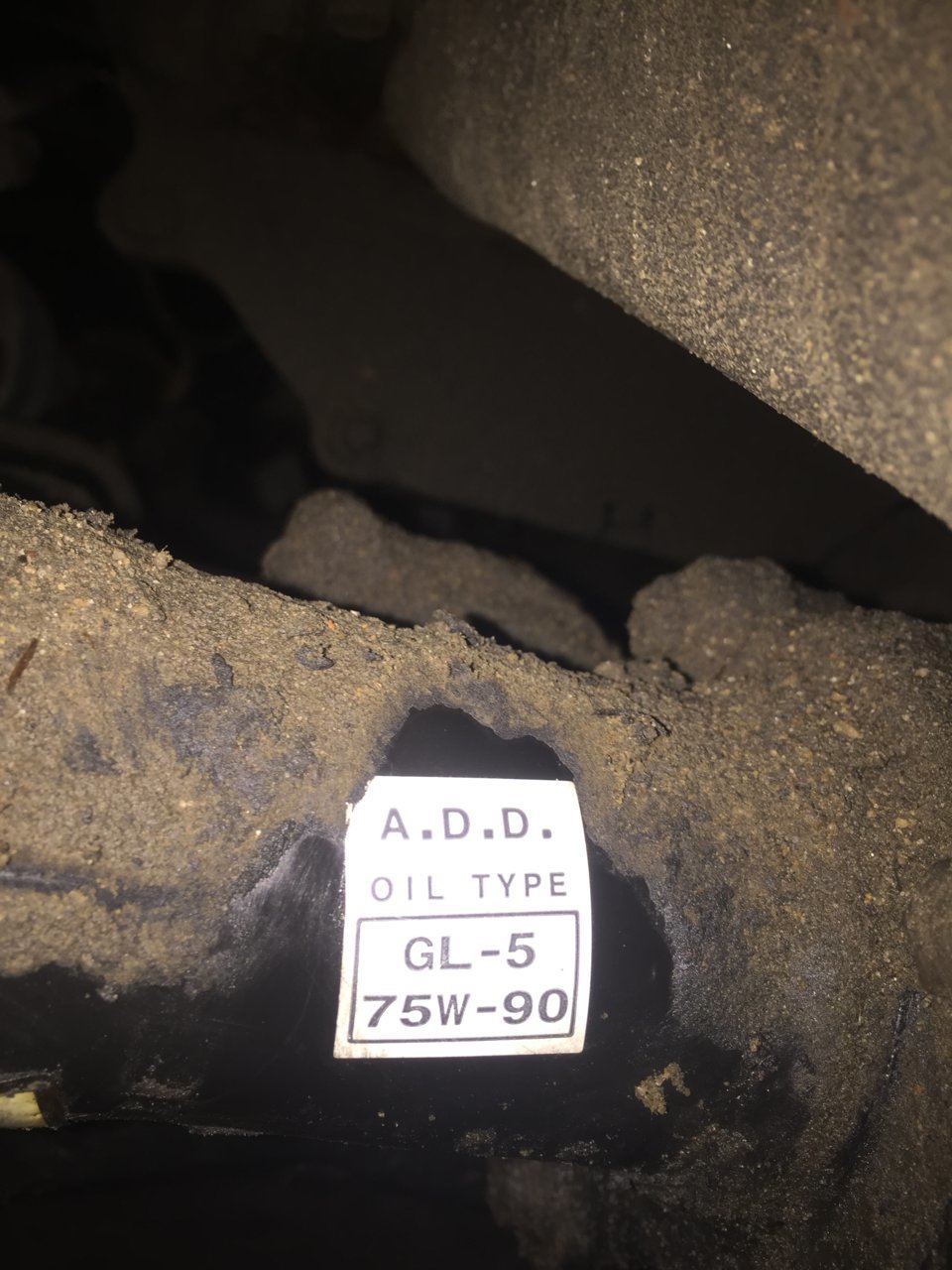

    I've been under the front end lately cleaning things up and didn't notice one. Tight in there. I work on this truck all the time but I'm an amateur. I do have ADD and not locking hubs so maybe? Found these stickers under the crud on front diff shaft

    so without locking hubs you have a ADD which is a automatic differential disconnect. So it does have a actuator that engages the front diff. Exactly the same as the auto fj cruisers (2007-currentish)
    From what you are showing me atleast. Not an expert by any means
