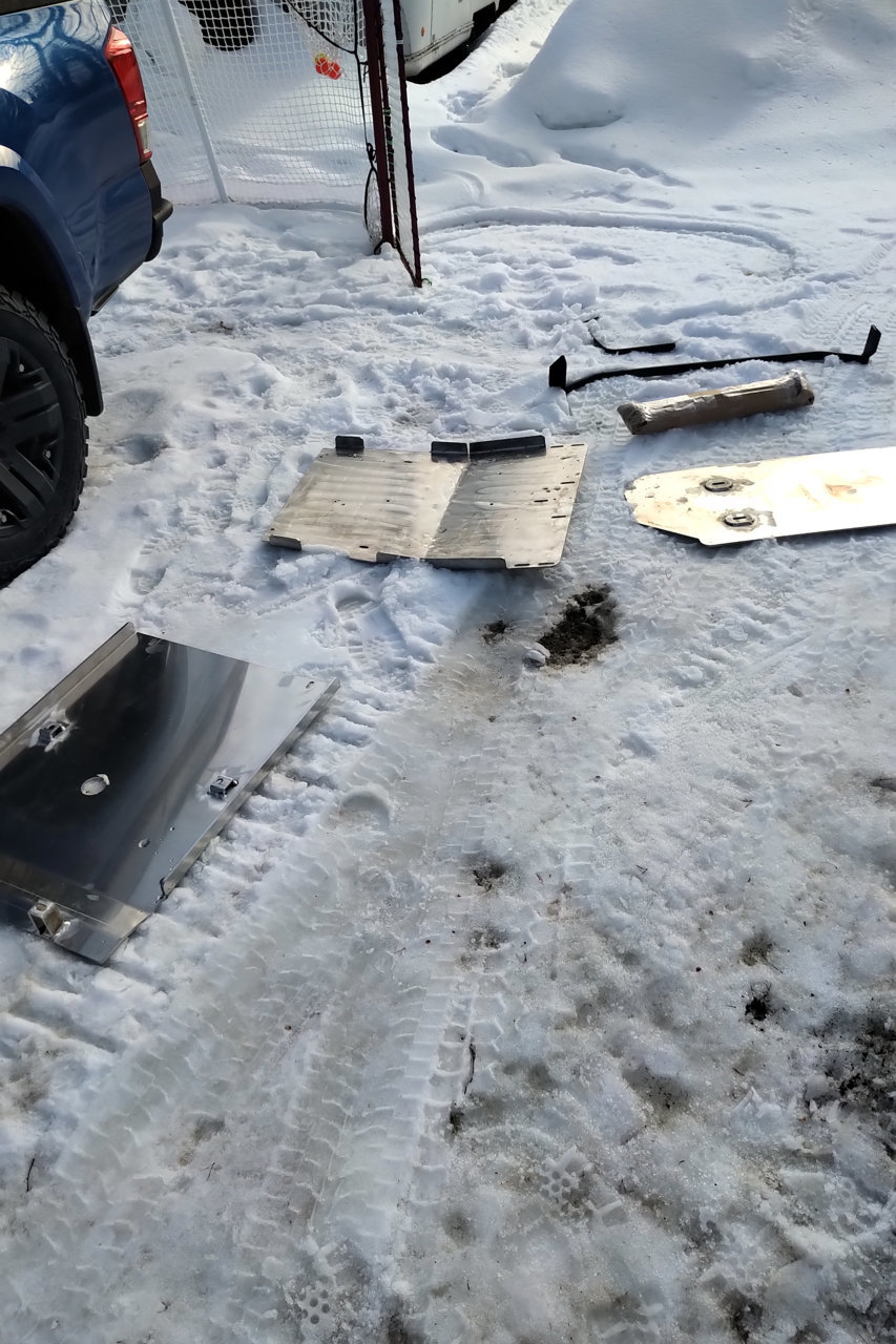

    Hey guys, many of you here have skid plates on your tacos. Did anyone have trouble installing the mid plate, rear two bolts? (Bottom left plate, the bolts I'm asking about are the two on each side of the oil drain plug hole)IMG_20200319_1659055.jpg
    Edit: those two bolts don't fit, like there is no thread in those holes, or like the bolts are a size or two too large

    I have a set of RCI plates, I've not had any issues installing them other than the 1 bolt right beside the Cat on the driver side, just needed an extension for it.

    Budbuilt. Seem really high quality, great match so far, it's the two holes in the frame that are giving me trouble. Either that or my bolts are too big, but I thought all bolt holes would be the same size on the frame

    Should use OEM bolts there, unless you paid extra for the stainless hardware kit. Can't remember if M10 or M12, but it's the same hardware as the front skid.

    check if the bolts you have been supplied are simply not too short.
    Not sure why it didn't come to mind, but there were 2 bolts i had to swap out for longer ones, It was 2 M8 bolts at 2 inches long or something.. This is right beside one of the connections to the LCA. but i'm not sure if Budbuilt uses the same mounting location or not.

    I'm using the stainless steel, the kit came really well labelled, so I'm using the correct bolt provided, and the other two bolts were exactly the same size on that plate. But I'm wondering whether the holes in the frame are all threaded, or whether those two holes are a smaller size. I have a hard time checking as I'm working on the ground. Not much space there.
    Edit: length seems correct, I am reaching the hole (I think), just can't get it to thread on.

    If you have a Sport and your using the rear most holes on the frame you'll need to tap those holes out. The off-road models have a tin plate that uses those holes, Sport models do not.

    That must be it! Thanks!

    if a Canadian tire is still open, go get the same 2 bolts you have on hand (go with Grade 5) and check if a longer bolt will help.
