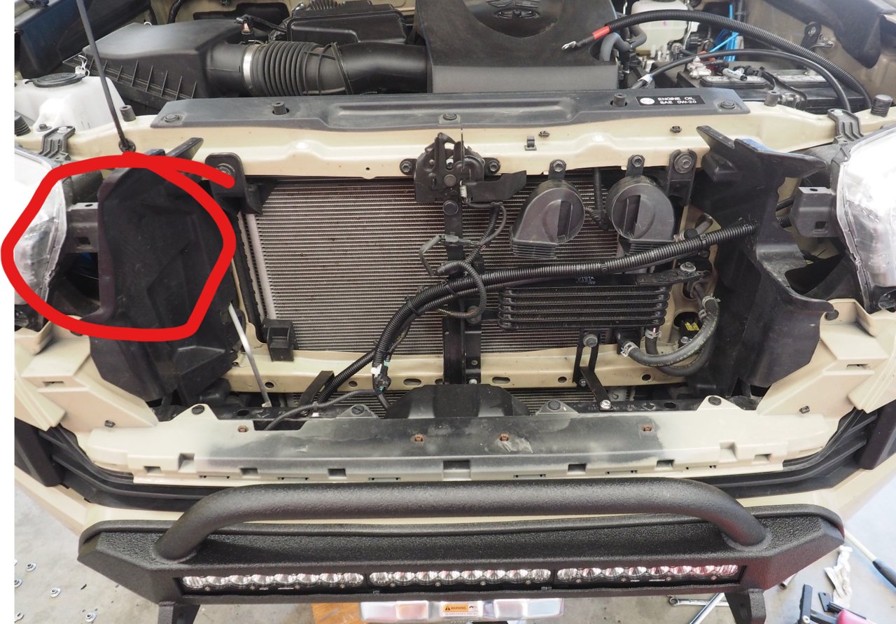

    WHO HAS TWO THUMBS AND FOUND THE SOURCE OF THE MYSTERIOUS TICKING NOISE!
    https://youtu.be/59YaCXbuCzc

    so what is it ? :boink:

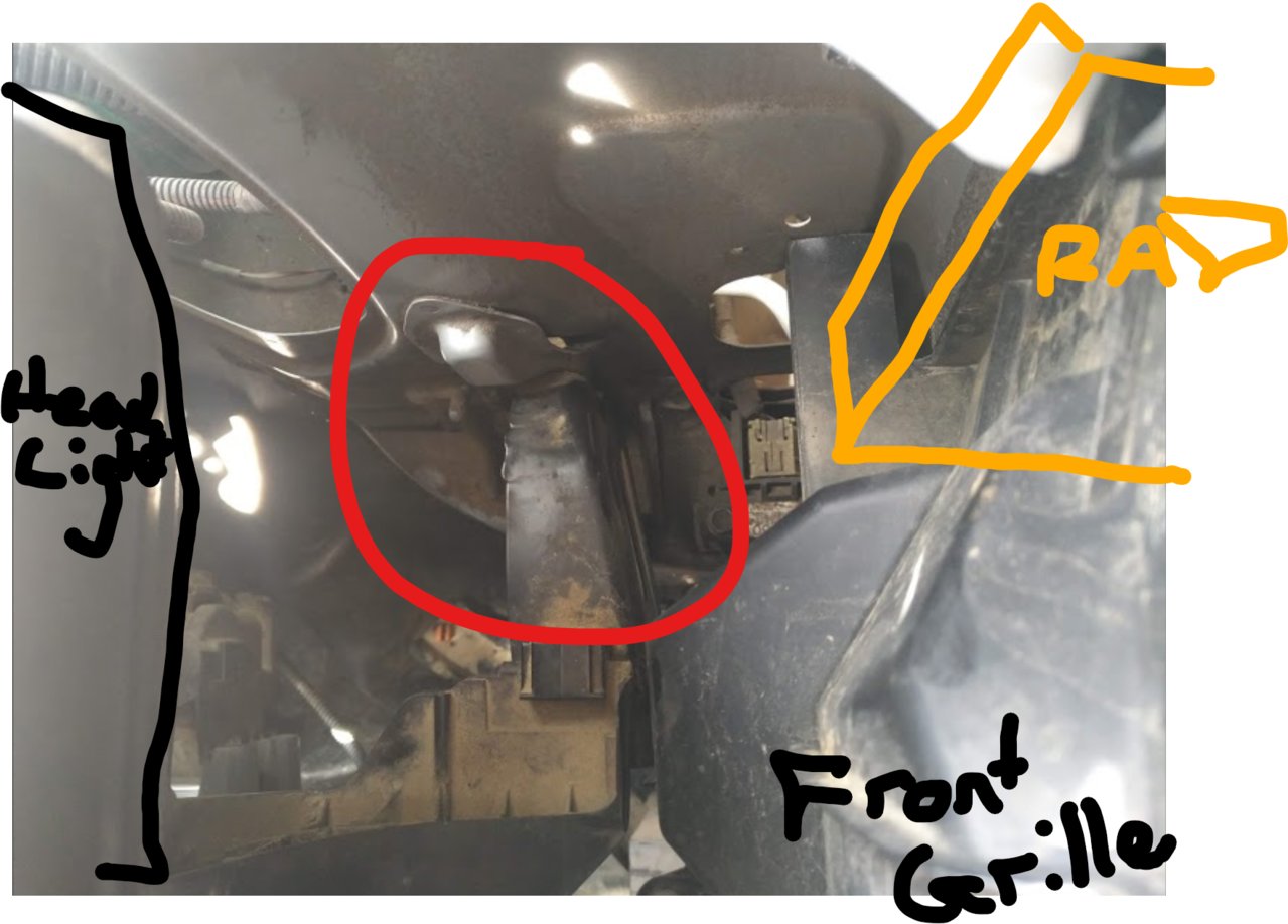

    You were close, wasn't the radiator mount
    but a metal bracket that holds the front grille, facia, and headlight.
    Somehow the 10mm bolt that connects that bracket to the body of the truck got loose enough that made the clicking noise.
    @tacoma16 can vouch that it's loud enough that he heard it without issues over the phone.
    Thanks for the help guys.
    sorry @pete37 won't be buy new suspension just yet :(
