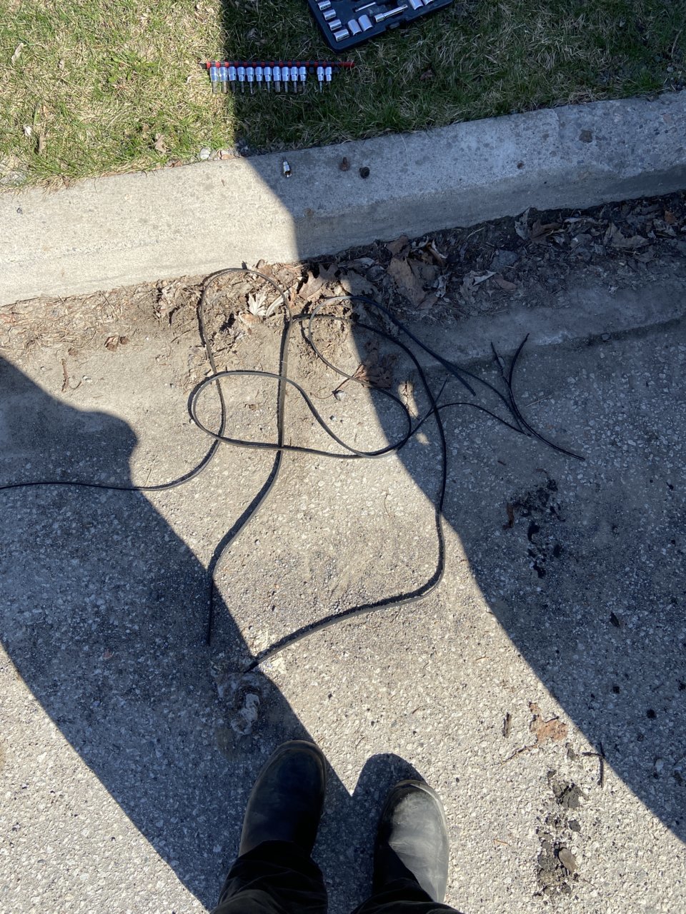

    Oh cool, Toyota uses lots of small belts to make up their serpentine belts!2DAD06F3-4811-4F0F-A97B-FF05096DD003.jpg

    lol, they don't make them like they used to! /s
    changed mine after 2 years, cracks and rough edges on mine...

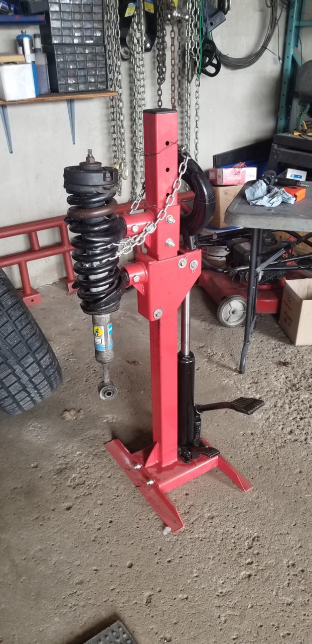

    Today I learned this the hard way
    hear is a pic of weeks ago using an Amazon spring compressor
    worked awesome and did not have any fear using it
    used it multiple times as i was also experimenting with spacers

    i feel like this is the original belt, so i cant complain too much. my big issue is I'm out of snack food.
    New belt ordered, hopefully tomorrow I'll be able to go by doritos

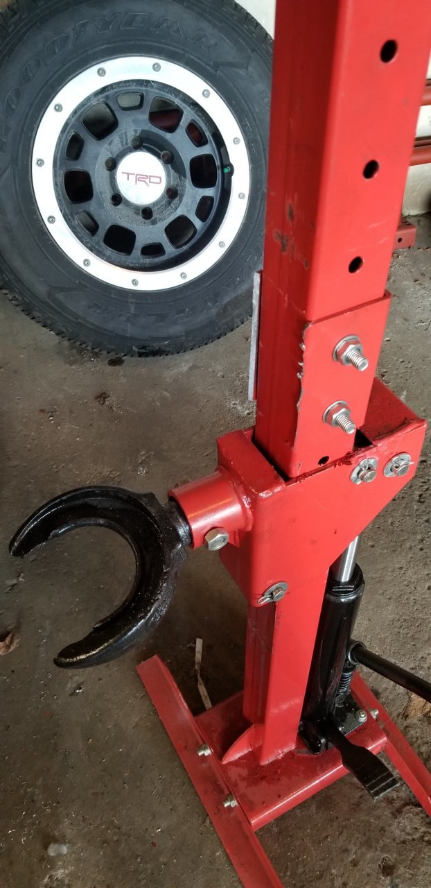

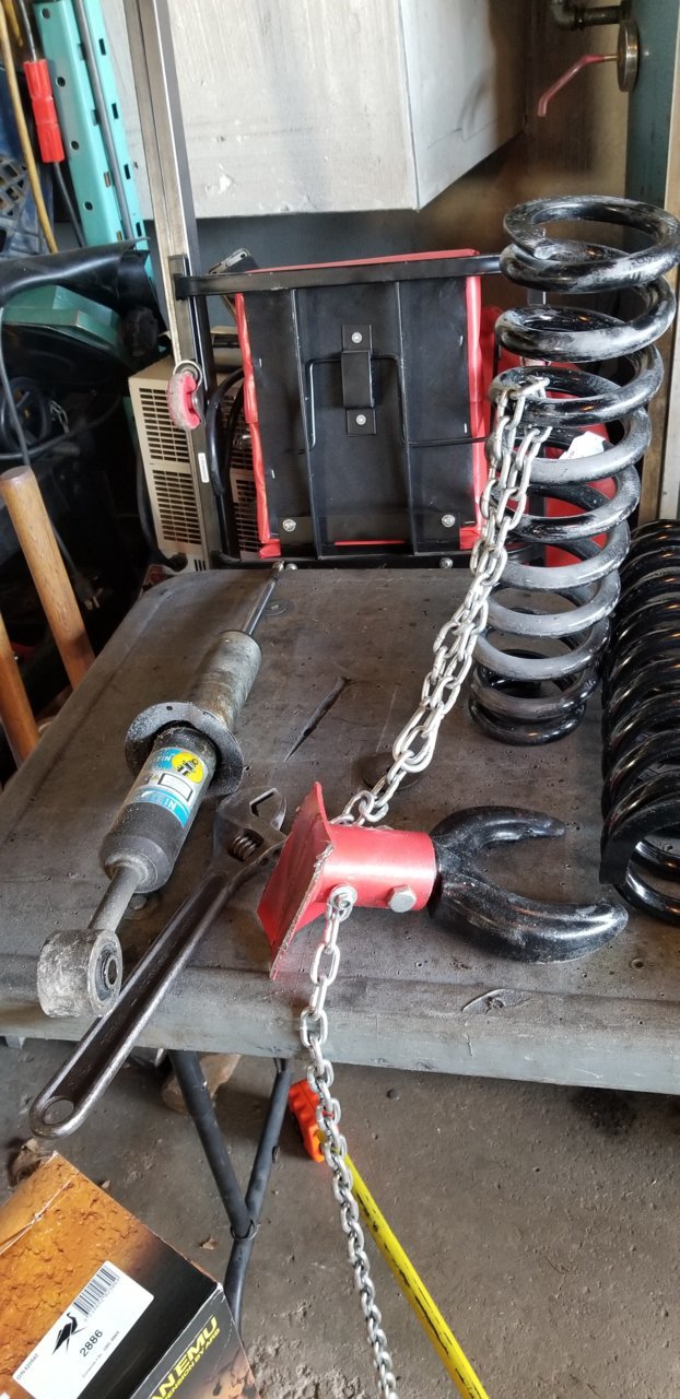

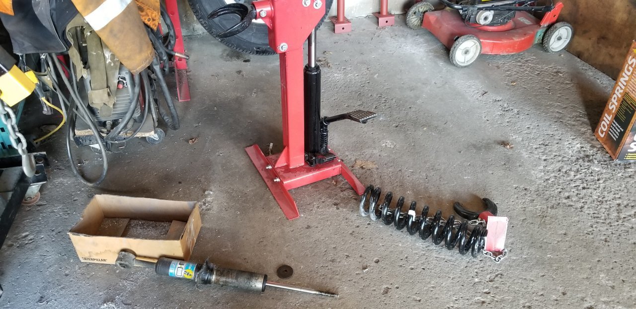

    Today I decided to install the springs I got from 4WP and I drop the nut
    I get it, get my adjustable to hold the flat on the shock start to turn the nut and
    everything goes flying including my self. I am so lucky I was standing behind and not in front or side
    so finished doing this job with the one the truck method. I will never, Never NEVER. use another Amazon spring compressor.
    Dam that was close.

    So the advertised 3-ton capacity was a lie? Here I was theorizing about using it as a poor man's ARB hydraulic high-lift...

    The jack portion might have a 3 ton capacity but the metal around it dose not..... anyway just wanted to share.
    thanks and please everyone don't use any Amazon spring compressor...

    Damn thats sketchy as hell. Too bad it looked decent
    But thats some shitty manufacturing For the bends to break like that :eek:
